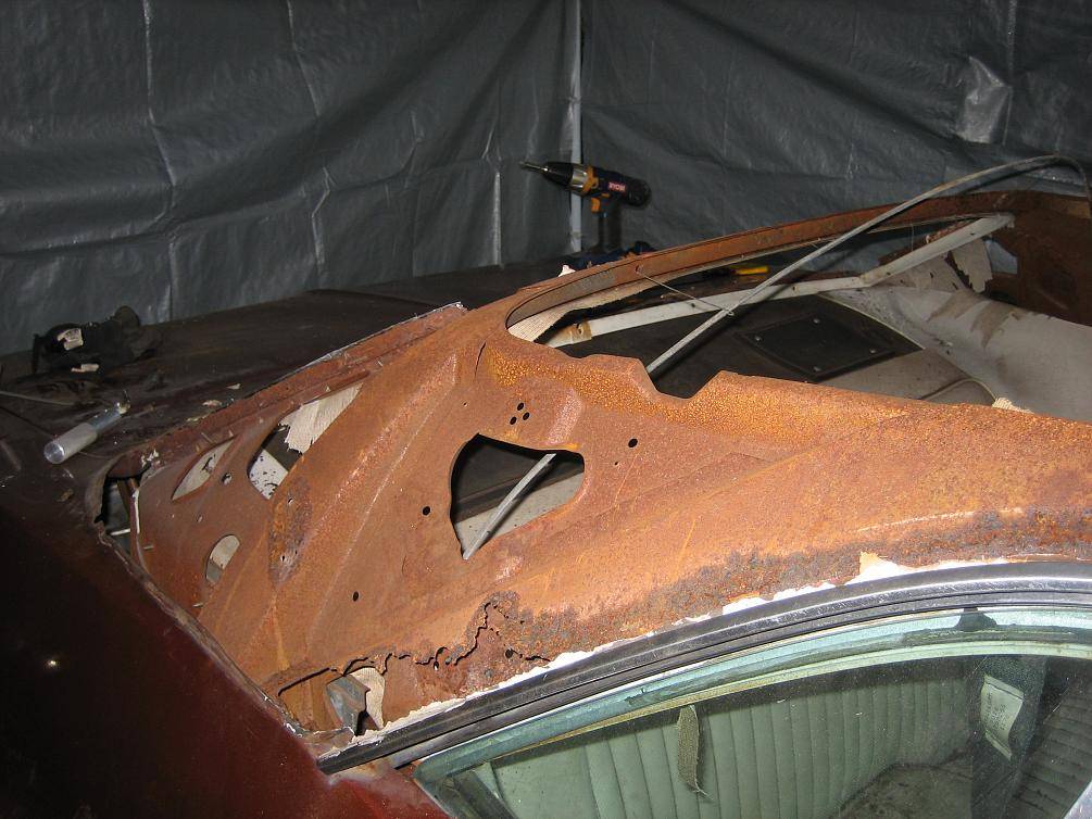

rather late to this thread but for others who may be interested, i did a related operation on mine, cut the a pillars half way up and did a complete roof/back window frame/ roof structure job and then patched the bottom half of the a pillars.. i have a few pictures of it in my album if anyones interested in inspiration.. it can be done haha
I actually repaired all the understructure metal in the rear just the outer skins are shot on the a pillars amd sells the a pillar skins and roof so I ll go that route thanks for the pics.
