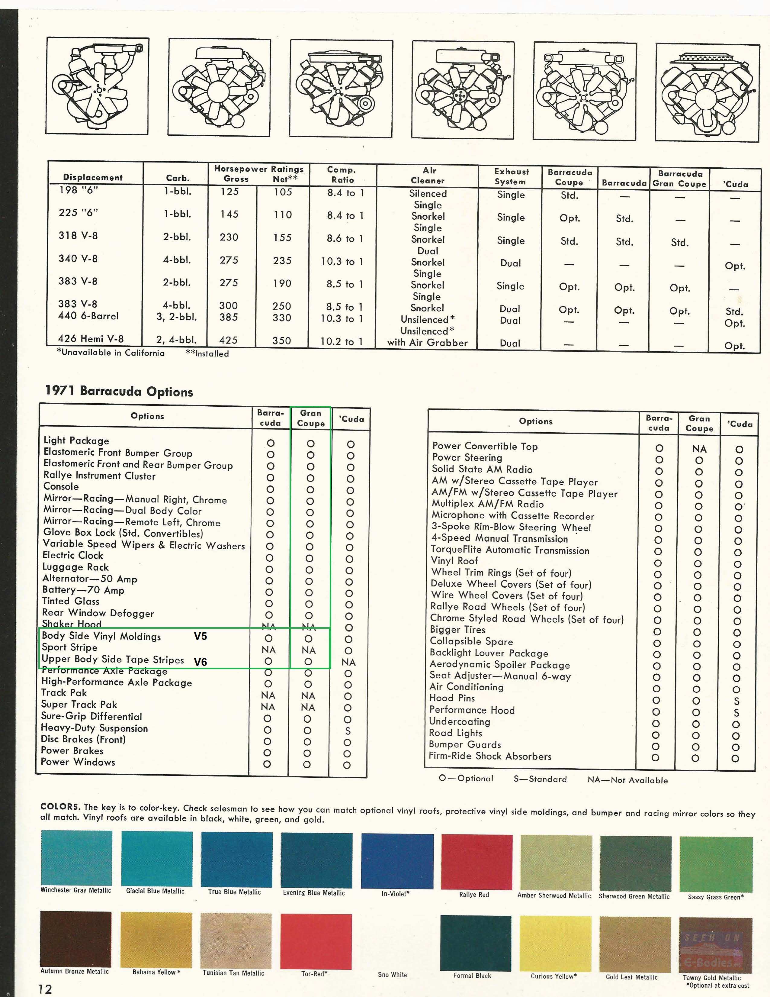

The second page from the brochure shows the Gran Coupe could get two different tape stripes (no mention of the painted stripes since those were STANDARD).
I believe the first is the V5_ BODY SIDE MOULDINGS with pinstripe and the second is the V6 full-length upper-body (two-part) pin stripe.

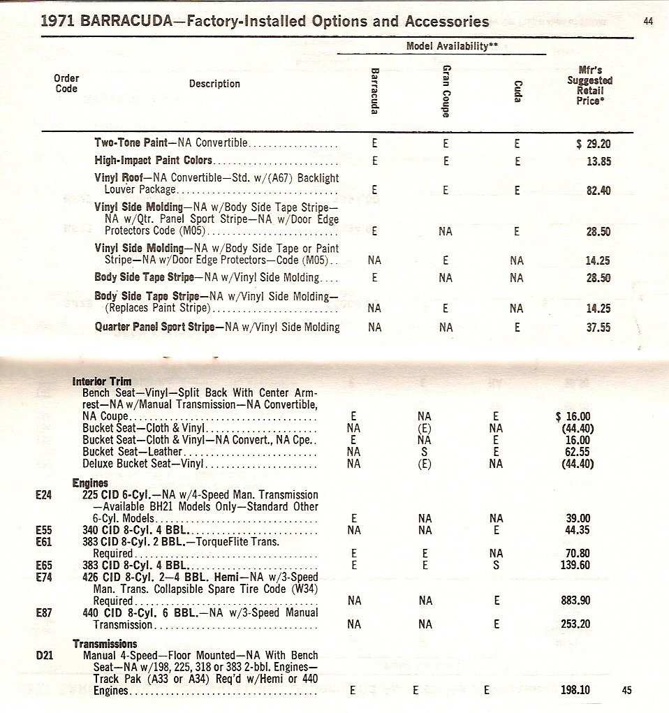

And here is the 1971 Barracuda Pocket Salesman Guide page showing the pricing for each available stripe.
This info shows there is a BODY SIDE TAPE STRIPE for $14.25 which is Gran Coupe ONLY and replaces the V7 painted stripe that came standard on 71 Gran Coupes.
I believe it is option code V6X as per the Gran Coupe portion of the chart below.

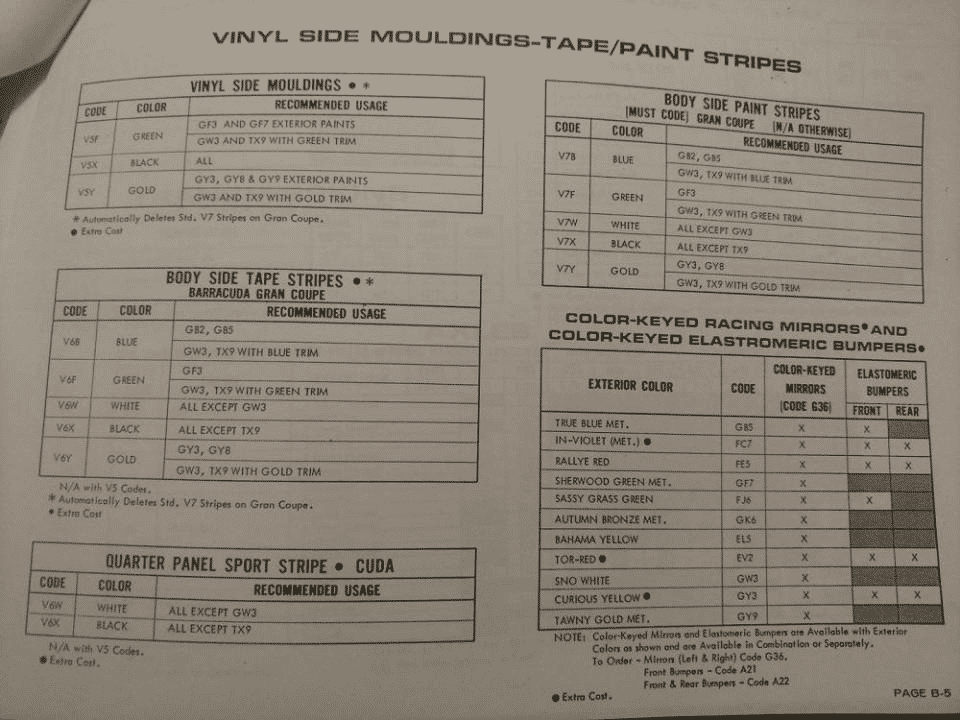

Lots of good info. It stated that x doesn't always mean black. I see white, and tan stripes. The one on my 71 was not black, and it didn't have a vinyl top. Seems like the stripe matched the vinyl top color. That is why I believe my stripe matched the interior color??
X is always Black. Your Broadcast Sheet and Window Sticker both show V6X so it is a black vinyl tape stripe for Gran Coupe only.
