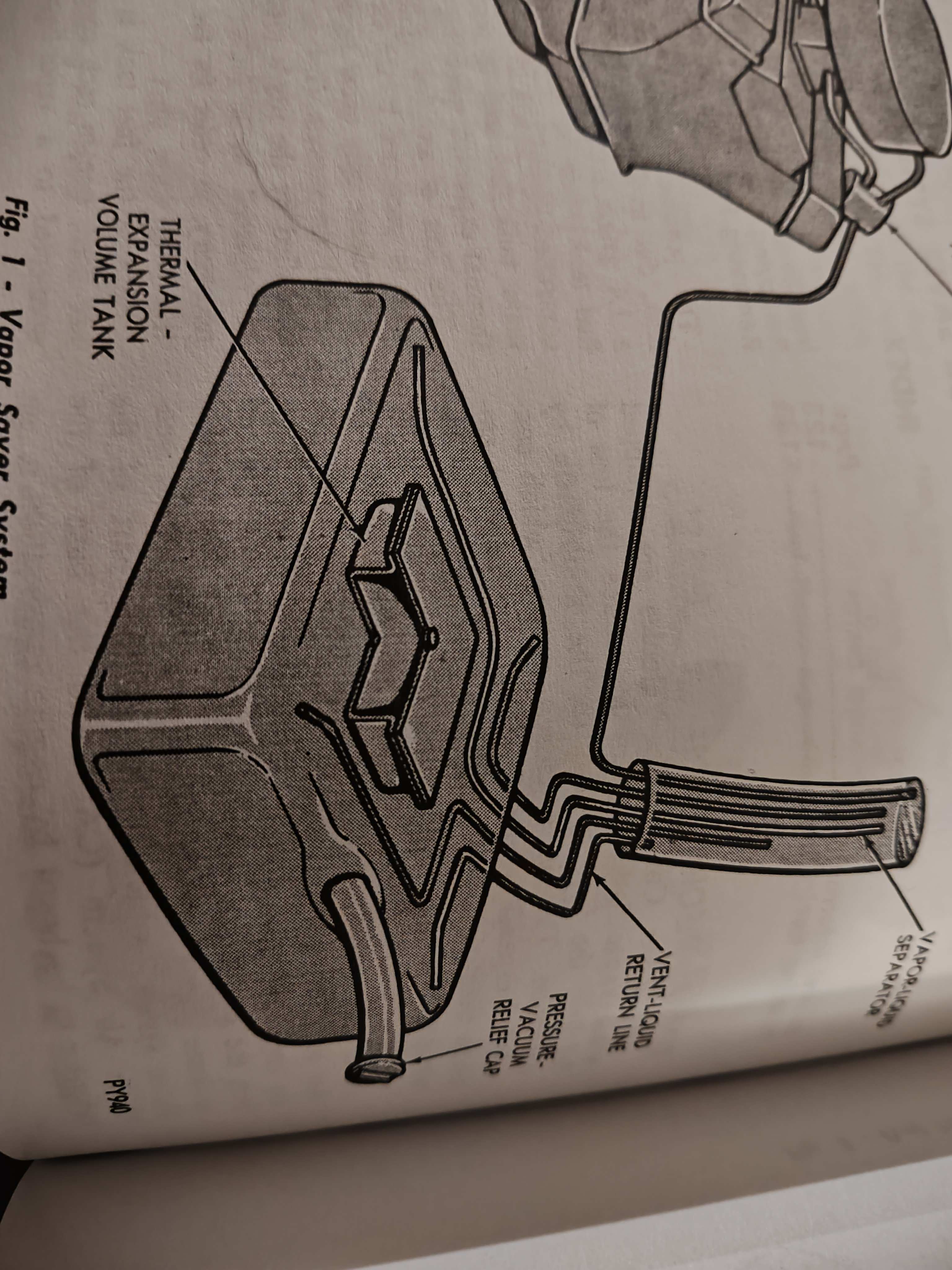

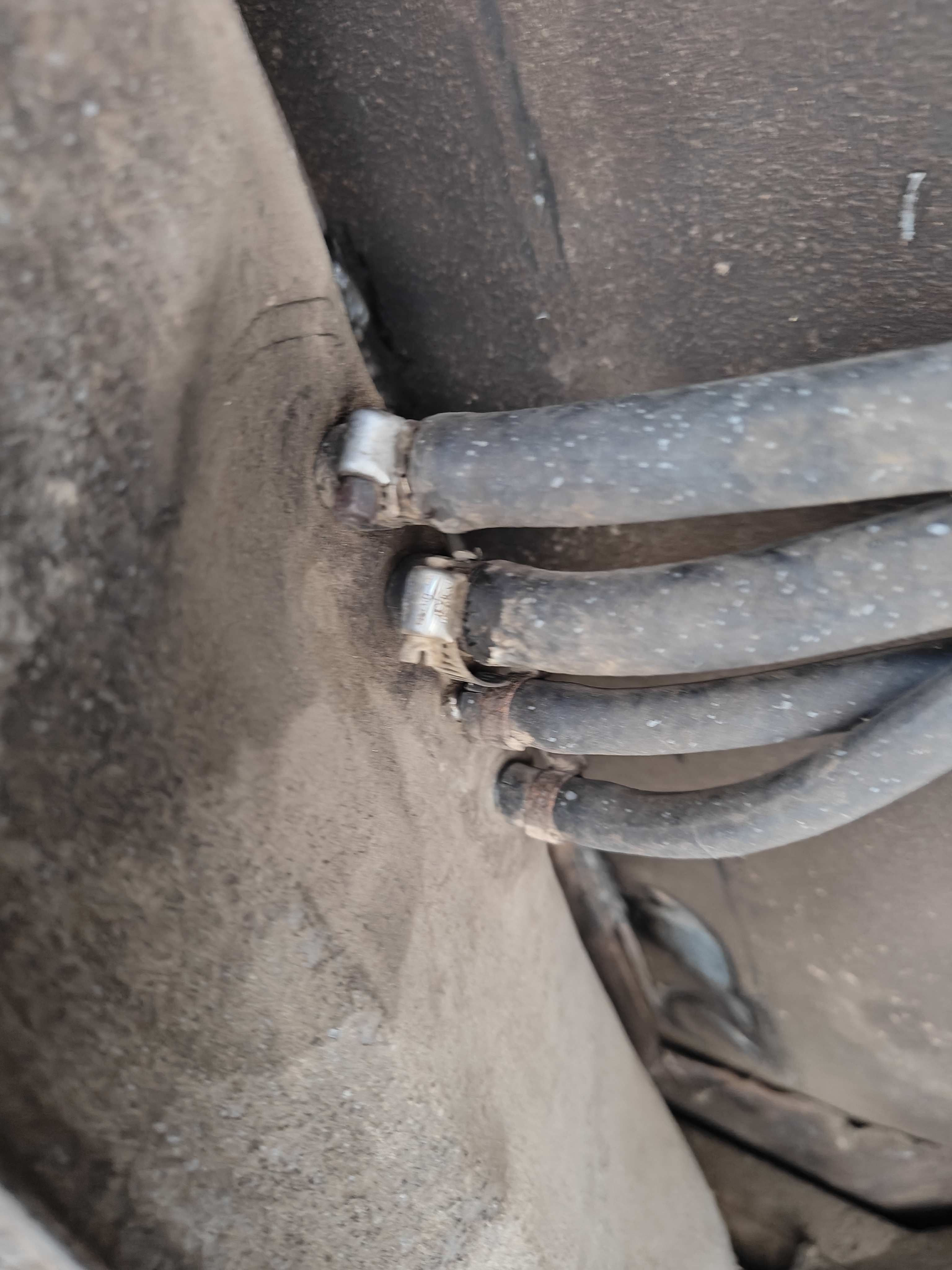

The tank on my 70 Cuda is nasty and clogging the fuel filter every 15 to 20 miles. I was going to just replace it, but am finding the 4 vent version of this tank is hard to find.
Standard replacement tank is: Spectra Premium CR8A (19 gallons, 1 vent)
I was looking at maybe snagging a tank for a 71 instead: Spectra Premium CR8E (18 gallons, 4 vents).
Not sure if this is a good idea since they have a 1 gallon difference.
Has anyone done this? If not, any other recommendations?
Thanks all!

The 70 evaporation emissions control and 71-74 fuel tanks have a one gallon vapor expansion tank which is the reason for these tanks being rated one gallon less. The 71 tank would work fine.

Thanks @Xcudame! That's exactly what I needed to know.
