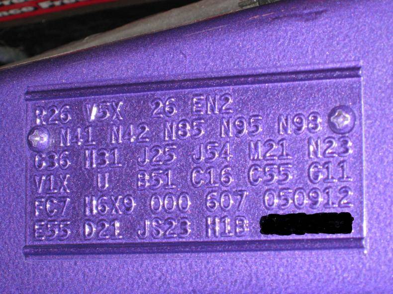

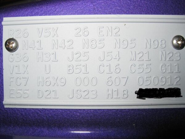

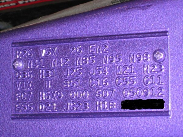

Reproduction Fender Tag (Better photo)
My original Fender Tag was so rusty some of the letters were difficult to read... I had a new one made by A.G. Backeast.
I am very pleased with the results and would not hesitate to use them again; and no, I am not affiliated with them in any way just a satisfied customer. They got the alignment of the characters exactly right...
Code Description
E55 340-4 Barrel 69-73
D21 Heavy Duty 4-Speed Manual Transmission
JS23
J = Dodge Challenger
S = Special
23 = 2 Door Hardtop
H1B
H = 340 275HP 1-4BBL 8 CYL
1 = 1971
B = Dodge Main, Hamtramck, MI, USA
xxxxxx Sequence Number xxxxxx ''
FC7
Paint Code: Plum Crazy Purple / In-Violet Irid
M6X9
Trim Grade/Style/Color
M = Medium
6 = Vinyl Bucket Seats
X9 = Black
000 Upper Door Frame: Full Door Panel
607 Date Built: 6 / 07 / 1971
050912 Order Number: 050912
V1X Roof Type OR Color: Full Vinyl Top - Black
U Built to Specifications for USA Order
B51 Power Assisted Brakes
C16 Console w/ Buckets
C55 Bucket Seats
G11 Tinted Glass All
G36 Left Hand Remote, Right Hand Manual Outside Mirror
H31 Rear Window Defogger - Blower
J25 3 Speed Variable Wipers
J54 Sport Hood 70-1
M21 Roof Drip Rail Moldings
N23 Electronic Ignition Standard only 4bb Engine
N41 Duel Exhaust w/o Tips
N42 Chrome Duel Exhaust Tips
N85 Tachometer
N95 Nox Exhaust Emission Control
N98 Unknown At This Time
R26 AM Radio w/ Cassette
V5X Black - Mouldings - Protective Insert Body Side
26 26 in. Radiator
EN2 End of Codes Assembly Line 2
