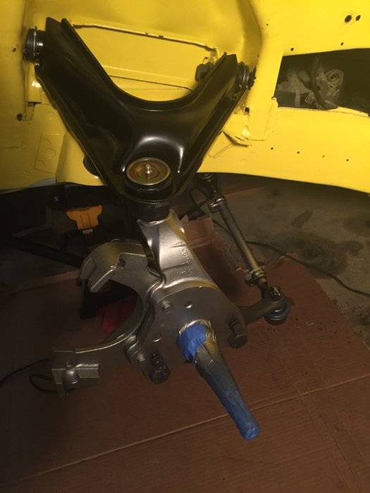

Here is the list of some of the MOOG parts I purchased to rebuild my front end. Prices are from 2016: I bought from Summit w 3 day delivery:
Front End Rebuild May 2016
MOG-K7293 UPPER CONTROL ARM BUMPER EACH $5.97 x 2 $11.94
MOG-K781 LOWER BALL JOINT $44.97
MOG-K783 LOWER BALL JOINT $44.97
MOG-K3180 LOWER CONTROL ARM BUMPER $7.97 x 2 $15.94
MOG-K5241 SWAY BAR BUSHING KIT $5.97 x 2 $11.94
MOG-K5255 LINK KIT 4.97 x 2 $9.94
MOG-K7026 STRUT ROD $43.97 $43.97
MOG-K791 LOWER CONTROL ARM BUSHING $12.97 x 2 $25.94
I went w new upper control arms; my originals looked pretty fatigued and did not have to deal w installing the ball joints.
Control Arm Purchase w new bushings and ball joint
GOODMARK GMK2130972621L
Control Arm $ 142.89
GOODMARK GMK2130972621R
UCA's looked very close to stock and I kept the originals.

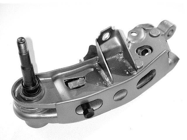

Look at PST. They are a sponsor and give members a discount. I upgraded to 1.03 torsion bars on my E body. Recommend reinforcing the lower control arms with their weld on plates to reduce flexing. I also used Rock Auto for Moog bushings. Good luck and enjoy your ride.

As Litchar mentioned, I also picked the LCA stiffening plates from PST.
Will make a difference in tightening up the handling.

When you weld stiffening plates on the lower control arms, make sure you are not pinching the two sides together too much, causing the adjuster to bind. There is room to tighten up a little, but don’t over do it. My two cents...
