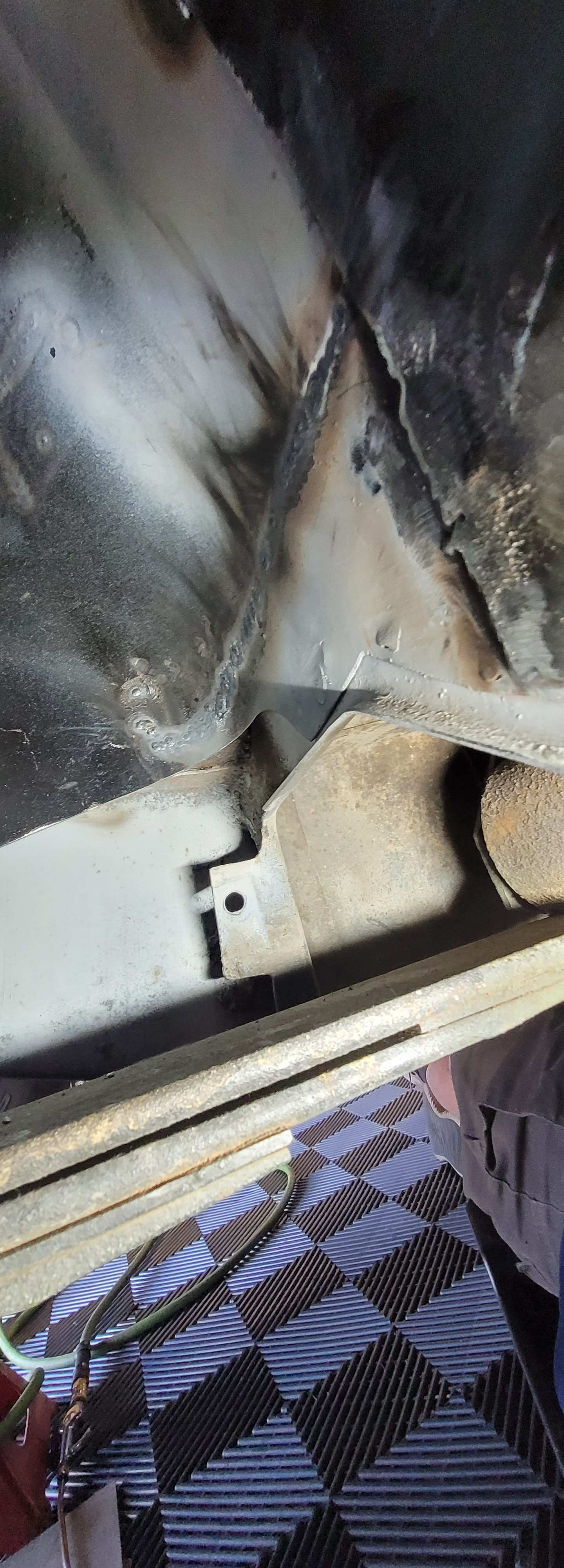

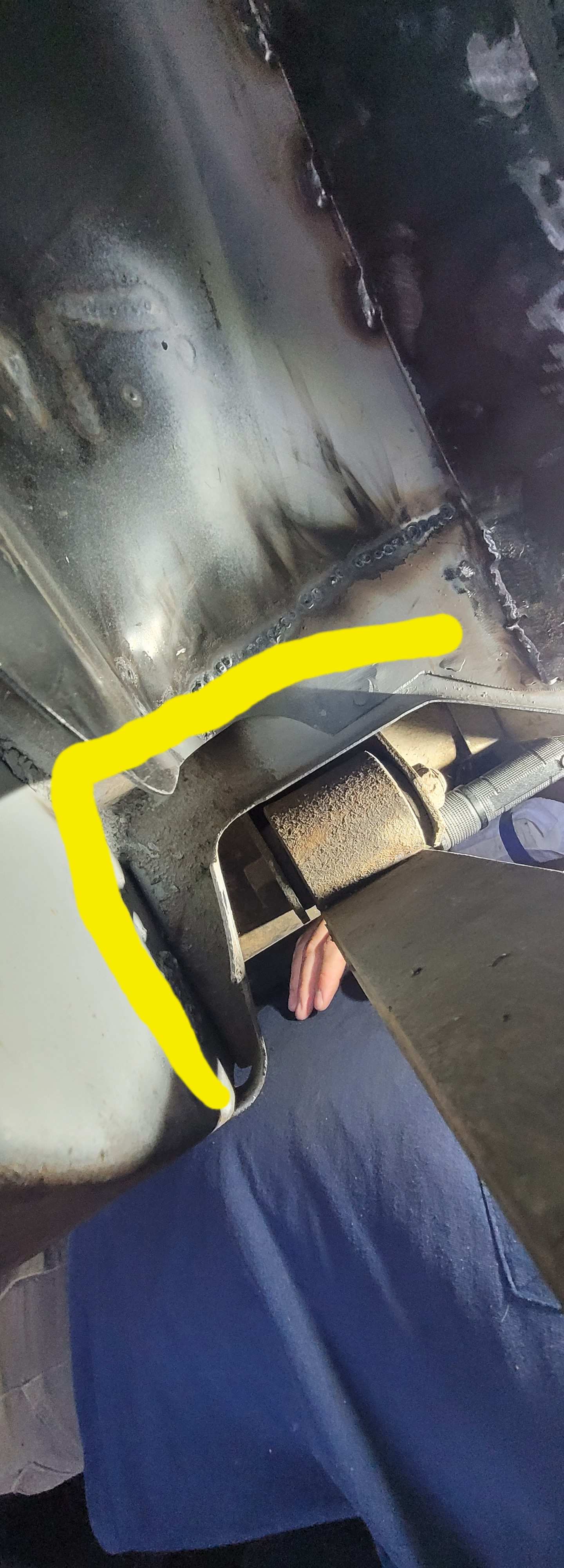

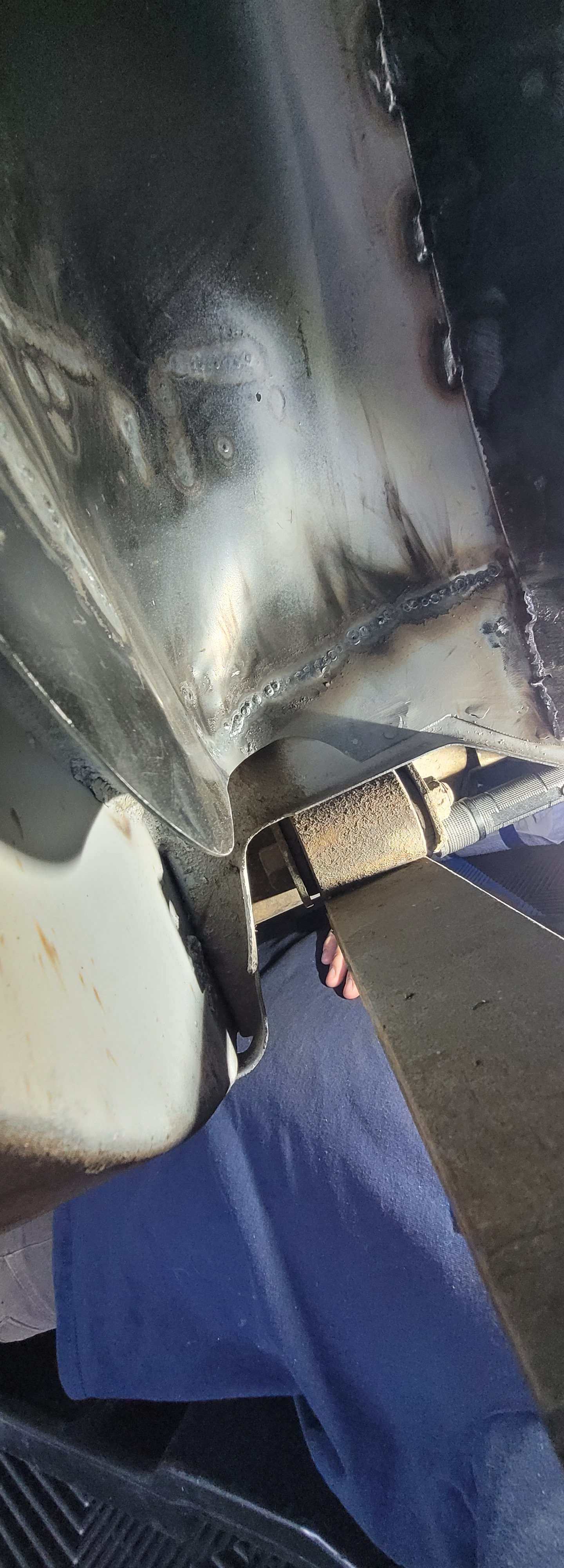

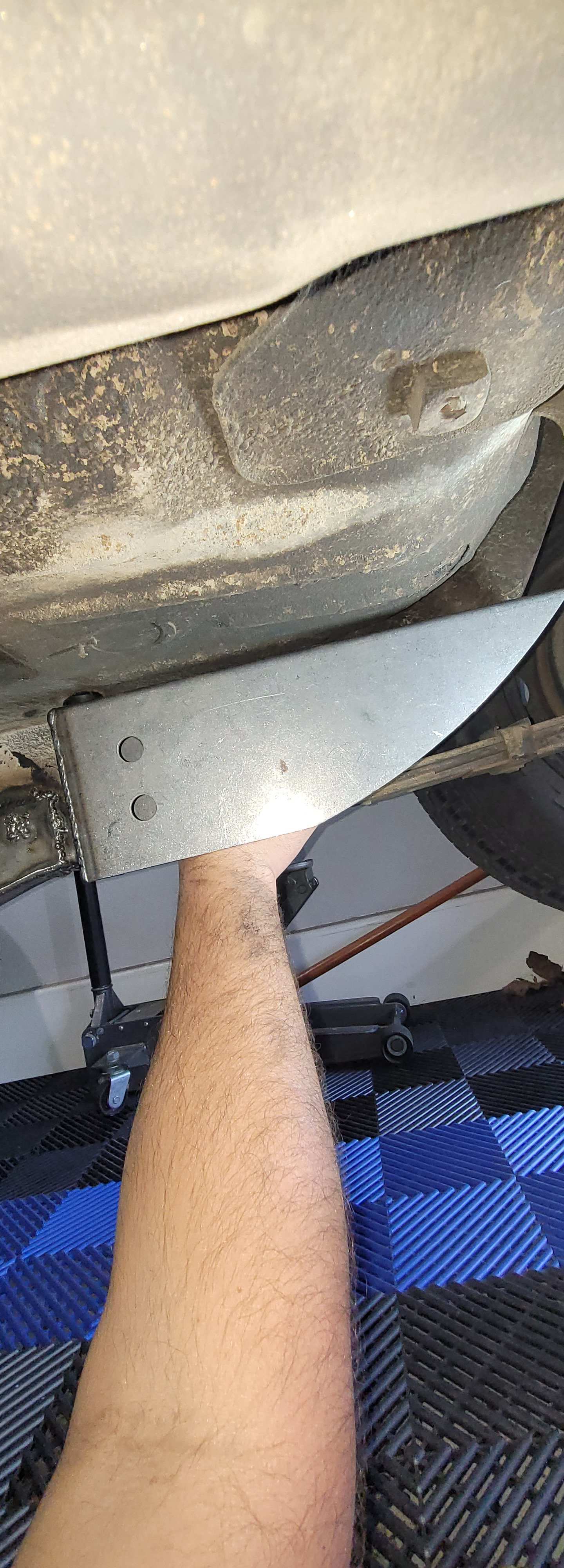

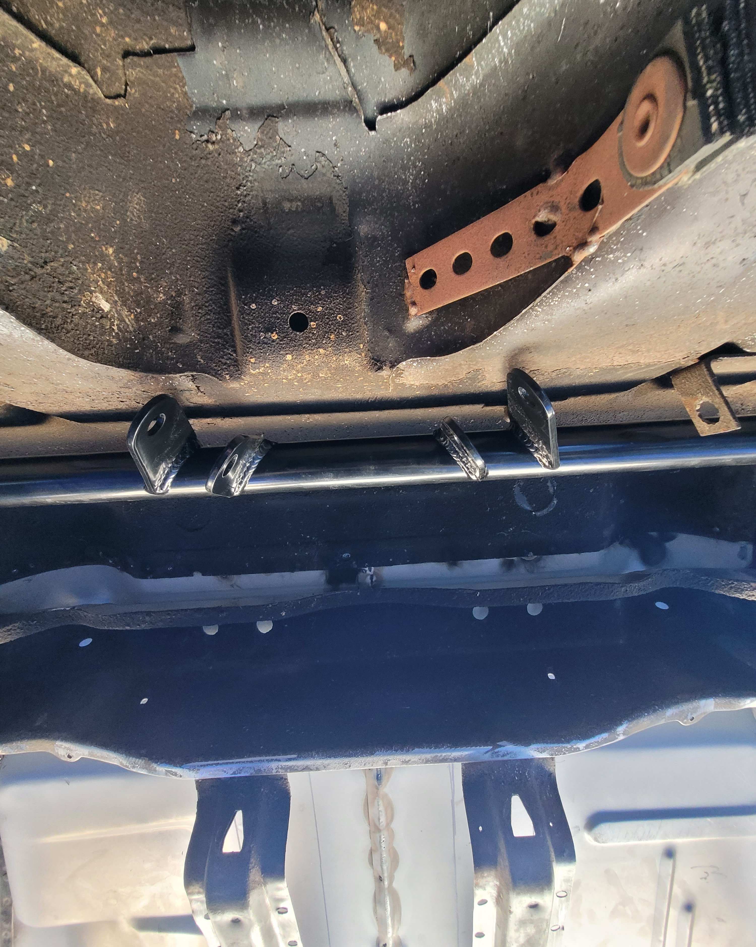

Hello all, I'm getting ready to start on the rear suspension and have some questions. I'm moving the rear 4 link control arms inboard with the brackets provided in the kit. I'm a little confused on the way they weld in. There is a bracket on the outboard side of the frame that looks to be part of the floor. When I cut the frame rail out this is going to go with it but do I need to replace it? The instructions I have don't show this so I'm not sure the proper way around it.
Does the new bracket mount flush to the floor? If so, how on earth am I supposed to weld it to the frame. If anyone has some photos or tips on how they did the install I'd appreciate it.

Not trolling at all, the pics you posted show a leaf spring suspension and the box you posted looks just like the one used to move the leafsprings inward on E bodies. Your original post said nothing at all about an RMS 4 LINK kit! The more info you provide, the more useful info you will get back pertaining to what you're doing. Just kind of how it works!

I guess the title and second sentence wasn't clear enough. Sorry for the miss communication. I'm installing an RMS 4 link kit and yes i haven't removed the old leaf springs as I still need it to roll around the garage. Just simply asking about the bracket.

You must be doing the inboard relocation version? I looked on the site and the instructions there are for the standard version and don't show any of that stuff. Your instructions don't show any views where that bracket needs to go? You need to contact RMS directly and they should be able to provide supplemental pictures or instructions.
If I was to take a guess, that bracket welds directly in place of the material that you cut out in the frame rail, but don't take that to the bank. Get verification.

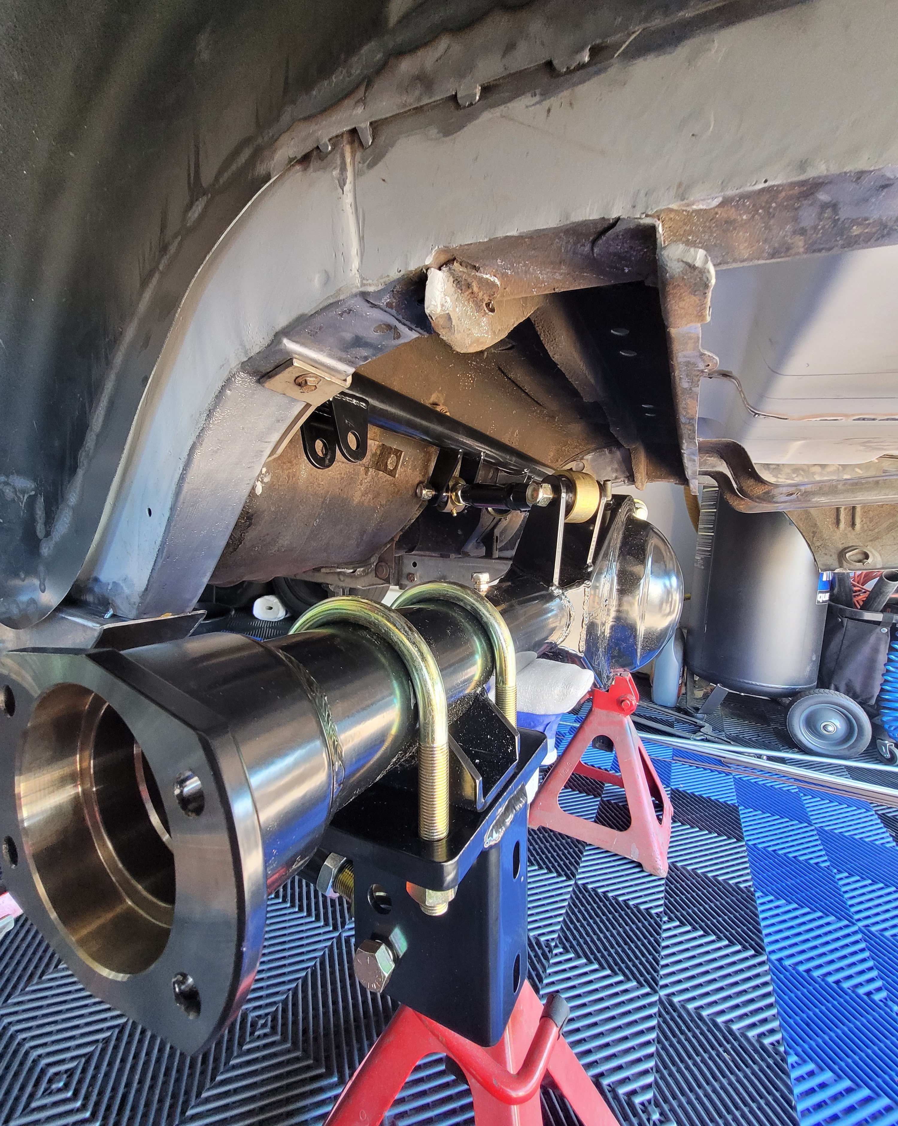

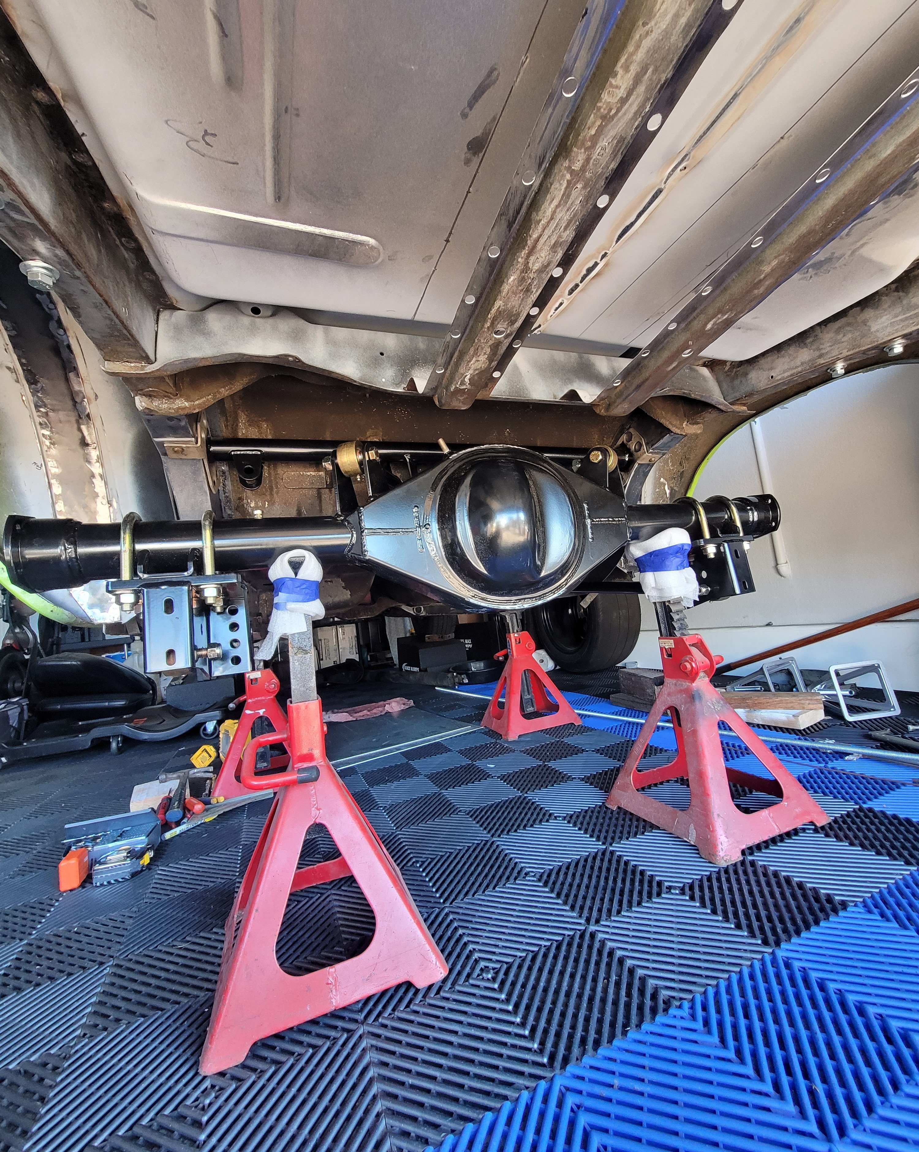

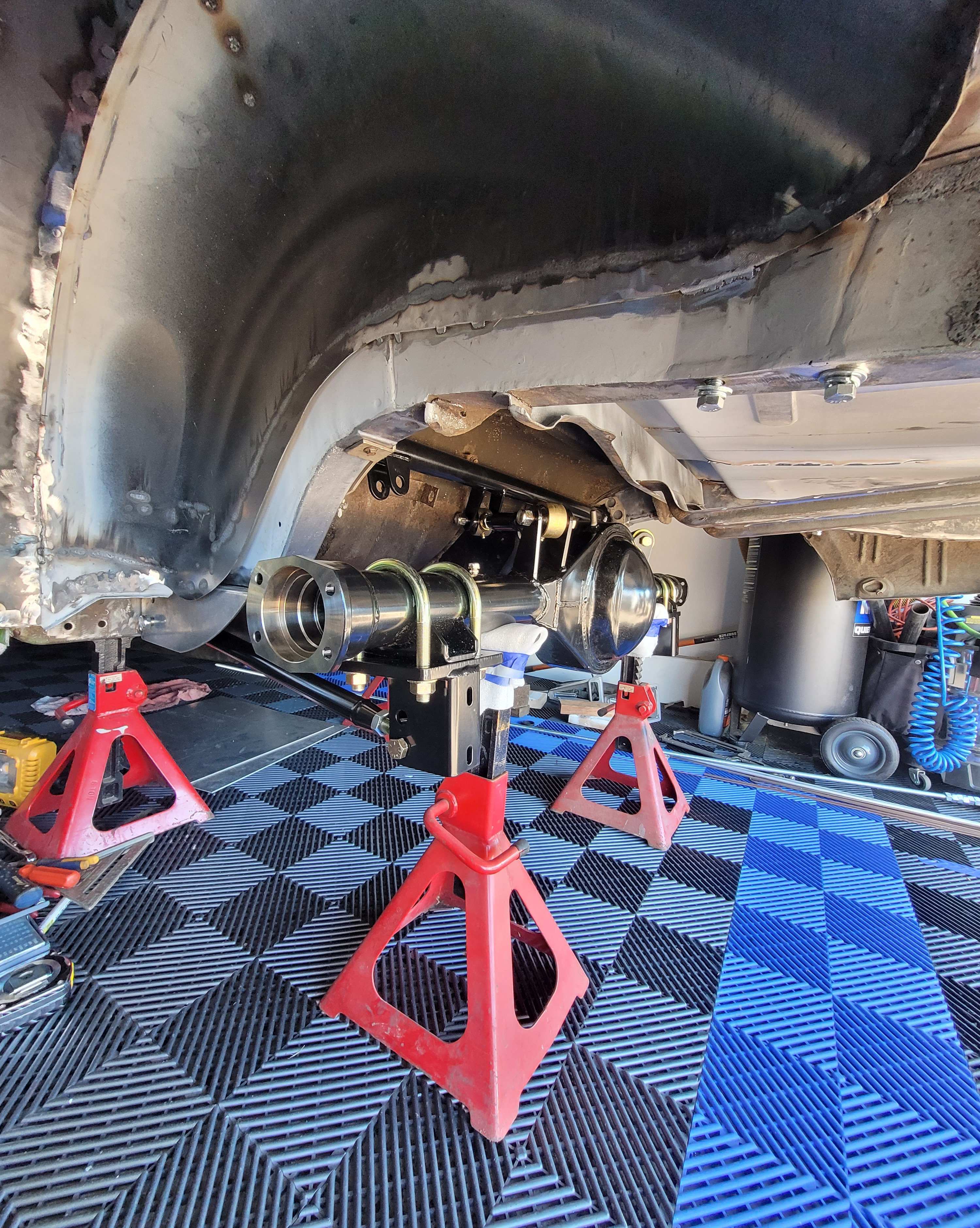

Well... I was able to get everything mocked up over the last few days. Now I need to remove everything and finish up the welding.
