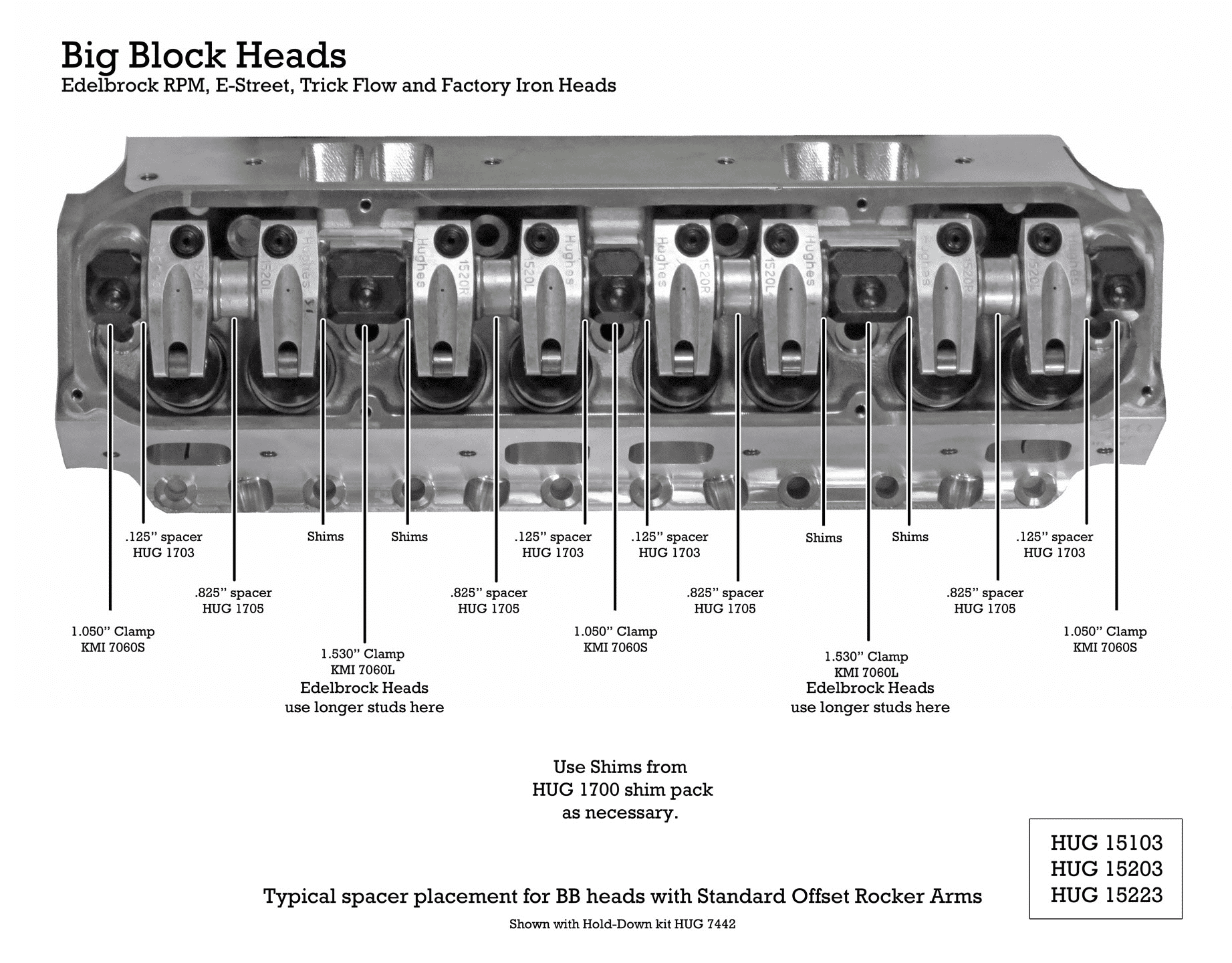

I chose Hughes rockers with the Trickflow 240 heads on the last bb stroker build. Really like em. I’ve ran the 440 source in the past without failure but, prefer bushed.
