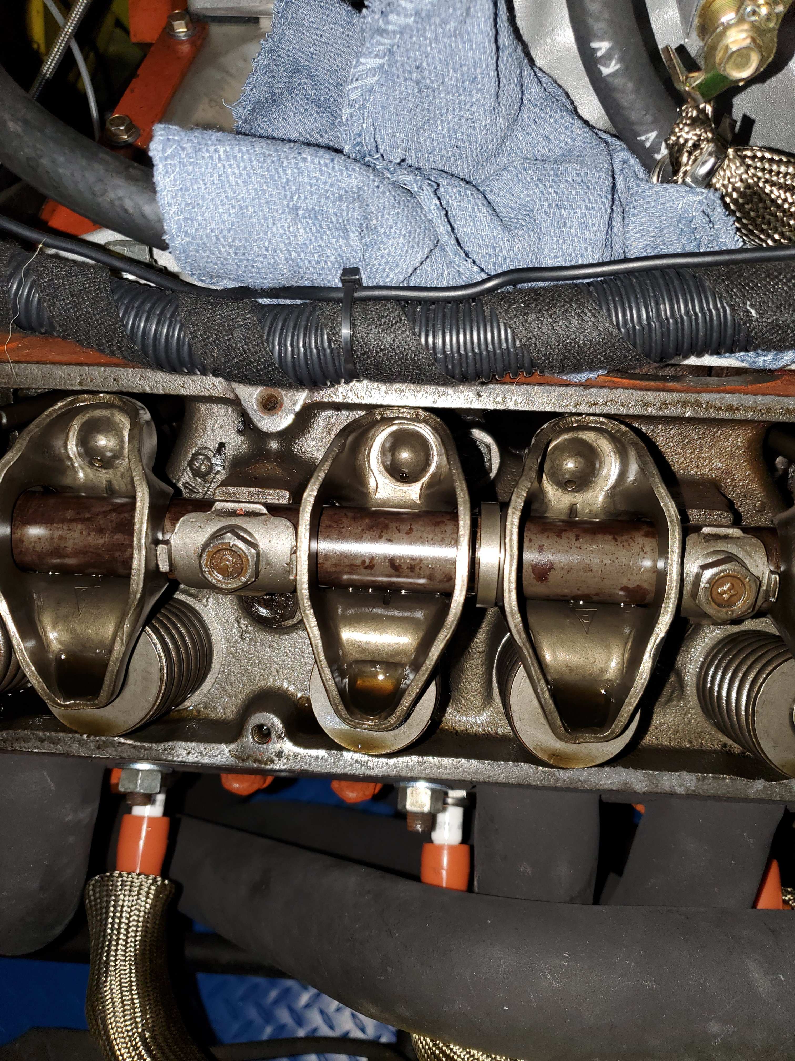

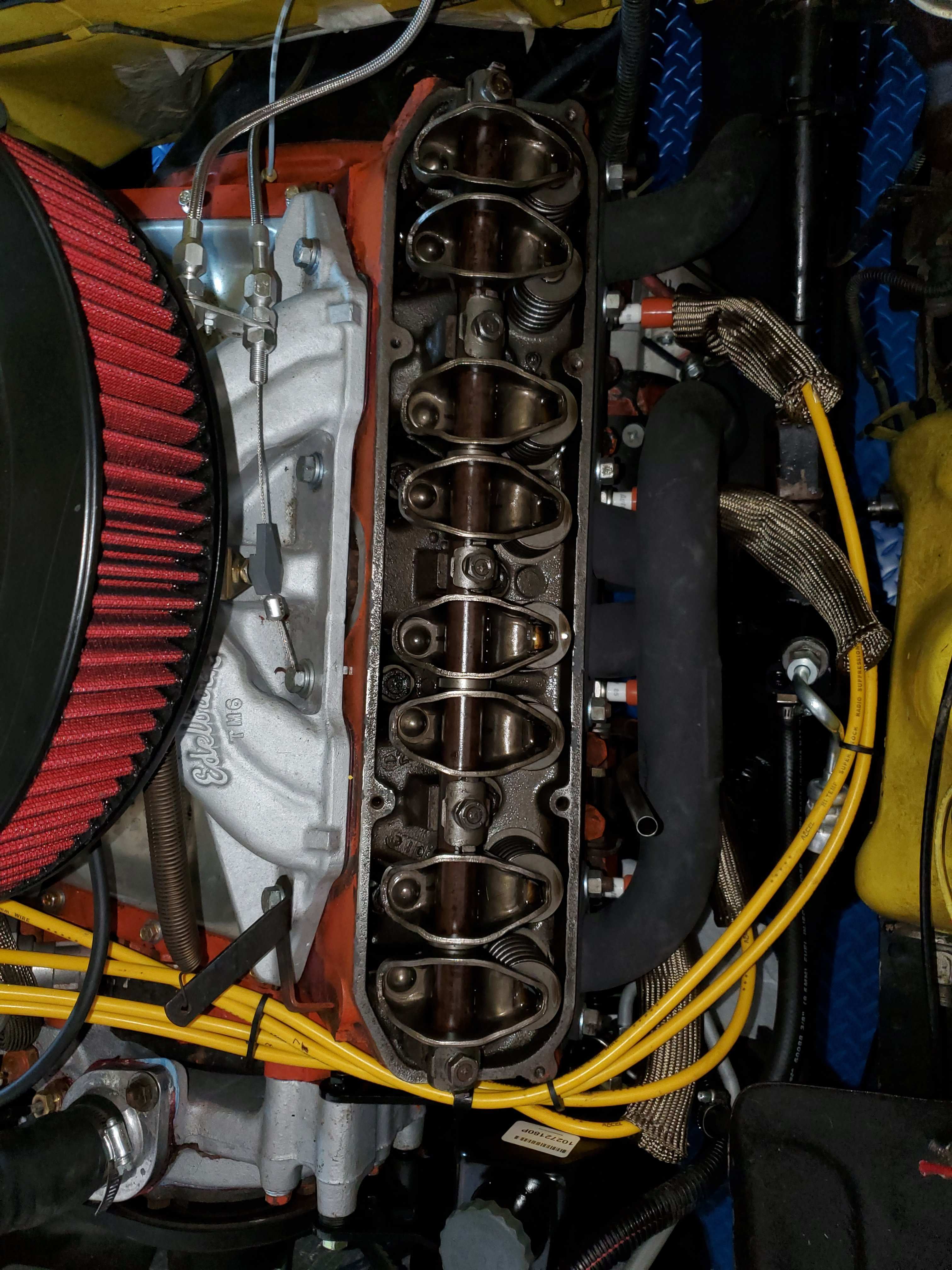

Just looking for peace of mind and replacing gaskets , pics are of both sides and the 3rd pic I can wiggle them slightly not tight like the others , it's the #6 piston .
Does it make noise when running? The rockers are not tight on the shaft and only contact the bottom of the rocker and shaft.
it has hydraulic lifters they pump up from the oil pressure when the engine is running .. when the valves are fully closed you can wiggle them a little that is normal if it doesn;t clack when running you are good to go
