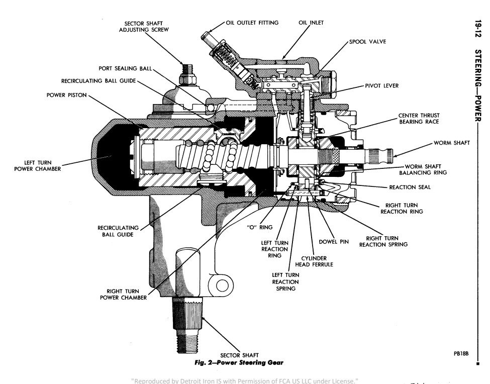

I finally was able to get all my steering components replaced that needed to be. Had an alignment done and the care seems to drive "very tight".
I was told that sometimes, newly installed components take time to "loosen up or break in", which results in steering returning to normal.
I've noticed that the steering seems "very tight" and that I feel some creaks- and even can hear the lower collar closest to the dash sometimes struggling to turn either way. Is this mainly due to "new parts not broken in", the column and steering assembly being too tight, or the column needing to be fully lubricated?
I did not experience any of these symptoms until after replacing the worn components.
Thoughts?
