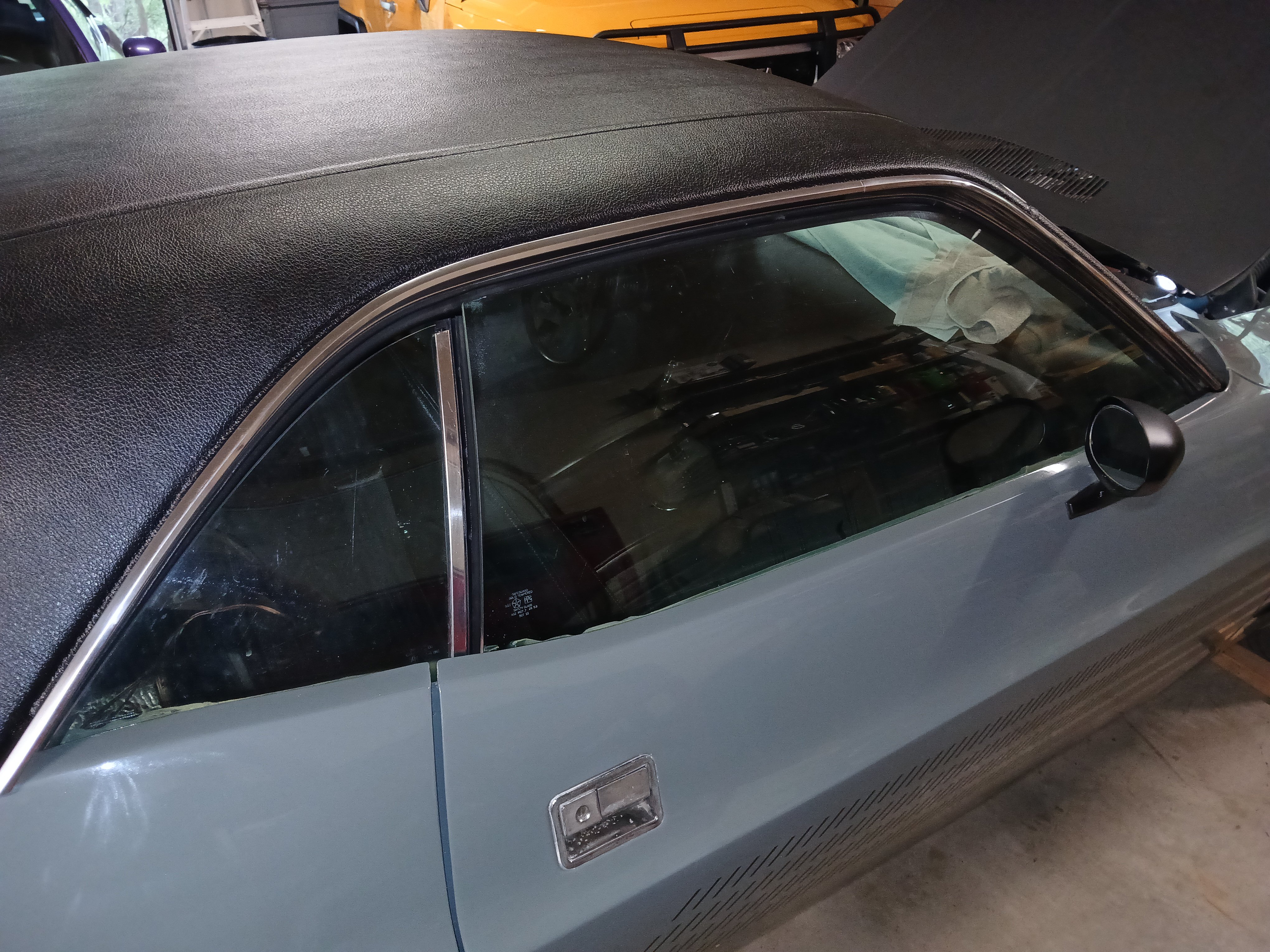

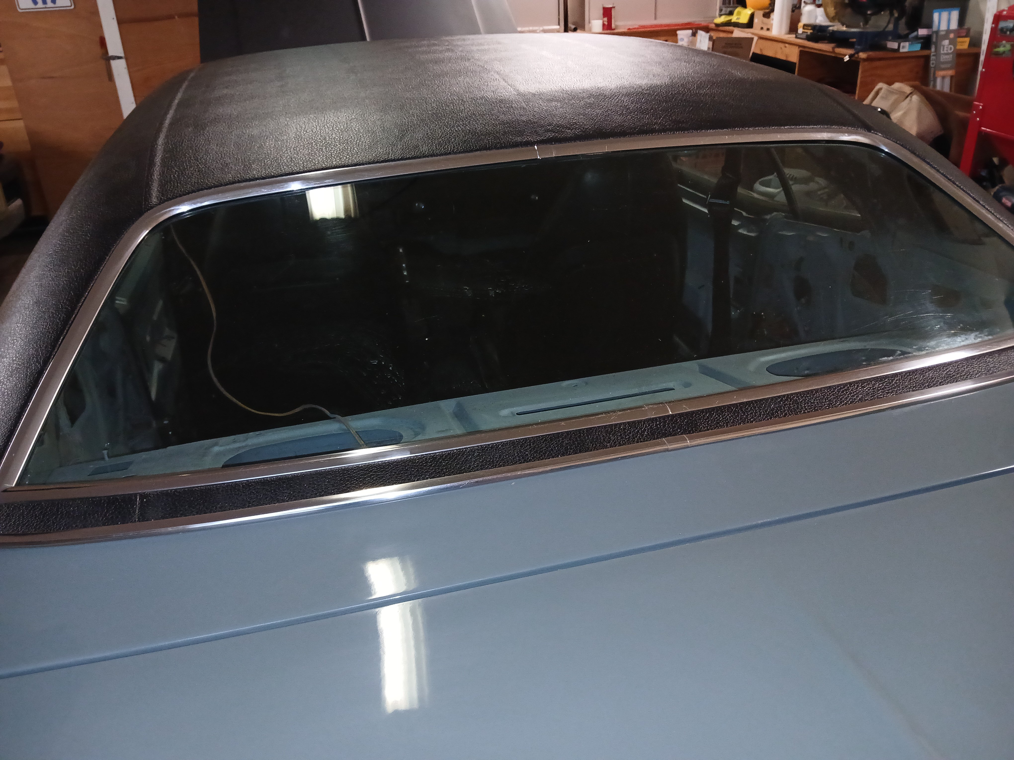

Anyone have any instructions, tips, hints, photos, or videos on the installation of roof rail trim and weatherstrip? We’re making a little progress on the 70 Cuda and this one of our next steps. Many thanks in advance for your help.

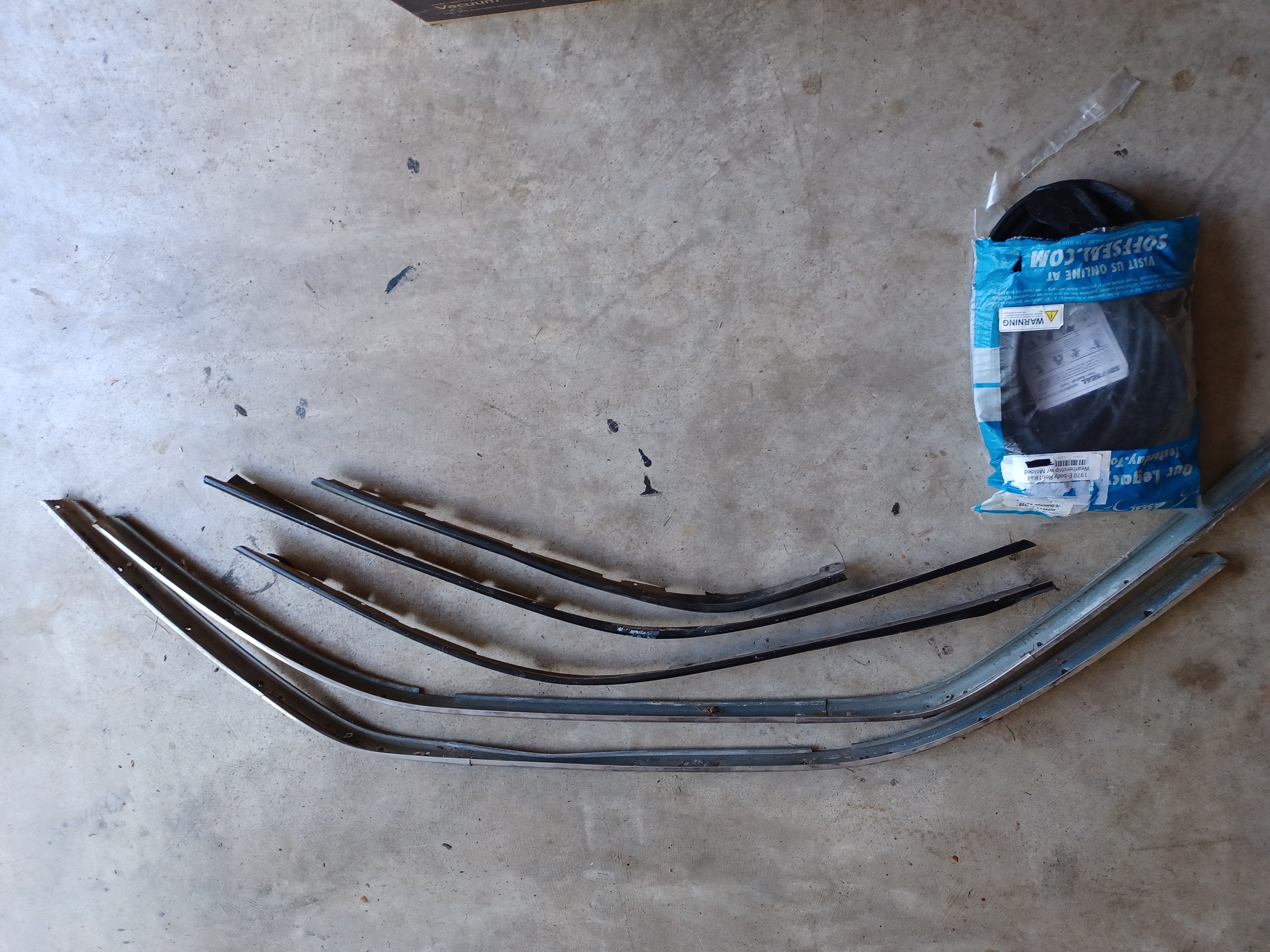

there are 2 parts , the drip rail is screwed on first with a low profile screws , then a foam strip is added between & the molding holding the window seal is screwed on & the rubber seal

Kinda what I remember and some online photos I’ve been looking at. Any clean closeup photos will be a huge help. Thanks.
