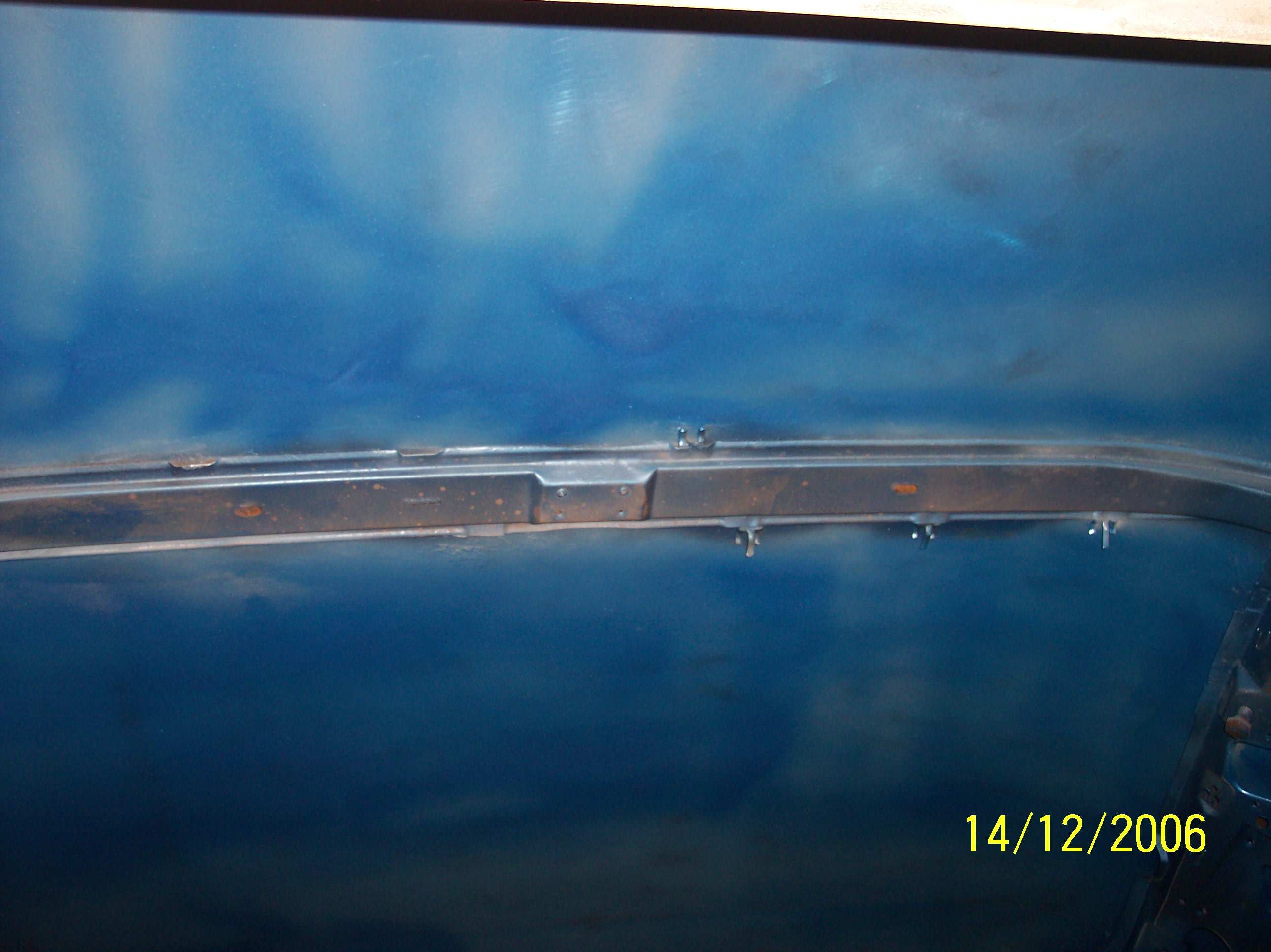

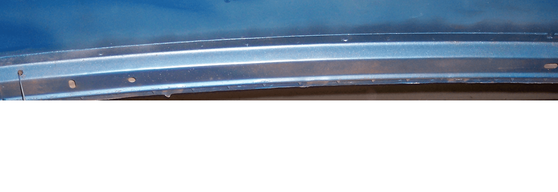

I don’t remember anything being between the roof skin and braces on mine, but if you look closely at the top of the braces when the skin is off you may see if there was anything up there, or not. I agree with the foam tape idea.
