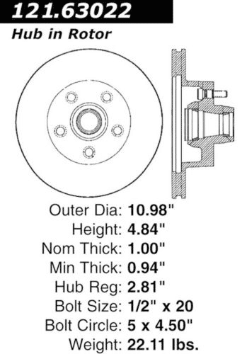

Just saw your post that the original O.D. was 10.75. That's close enough to Centric's 10.98 not to cause any problems. Thanks again!
340challconvert
Feb 13, 2011
5,456
2,928
Parsippany, NJ
Steve, I physically measured the width my original 2 piece rotors to get a comparison.
Came out to 10 7/8 in which = 10.875 vs. the Centric rotor at 10.98: (difference of .105) not enough to be of any real difference.
I also went with the centric left and right brake calipers and will also put away the originals which can always be rebuilt and reinstalled if desired)
Good luck with your brake rebuild.

I just measured my rotors from a 71 440-6 cuda
2 piece and they are 11 1/8 - 11 3/16 and min thickness is .940, mine are .958 and .937 roughly

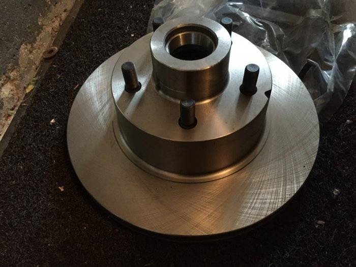

Steve,
Centric Rotors fit well
Just installed with standard size bearings for 1970.
Fits perfectly within the backing plate
