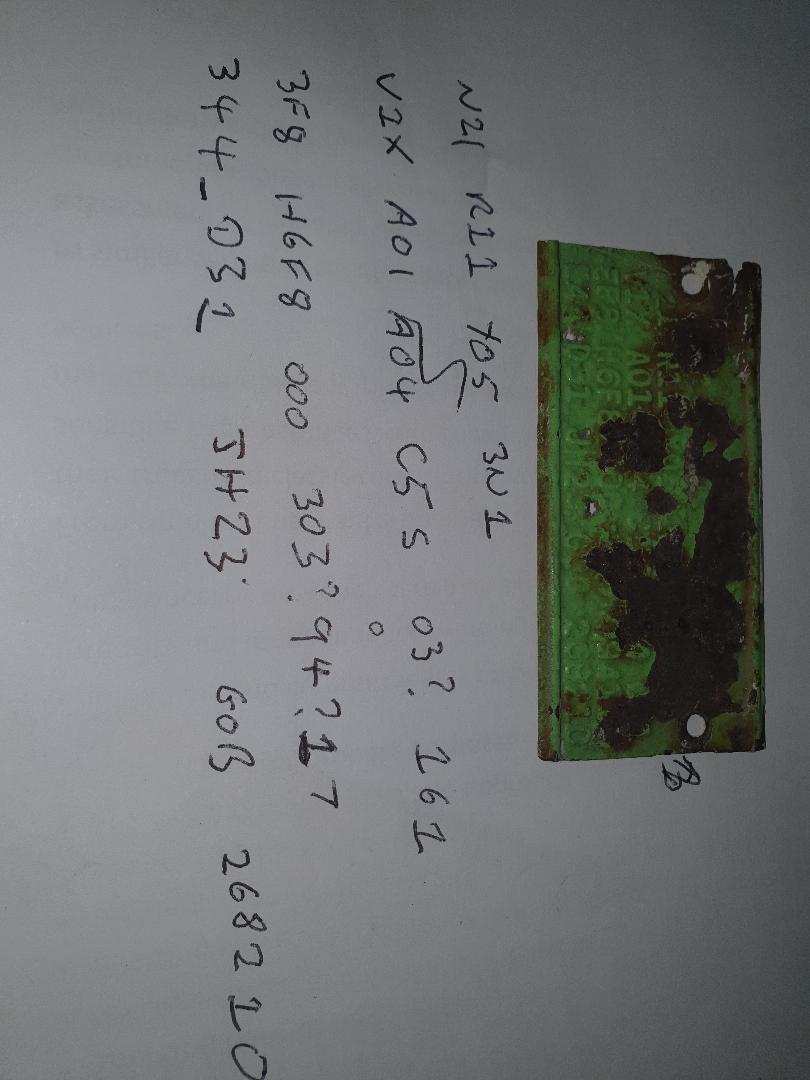

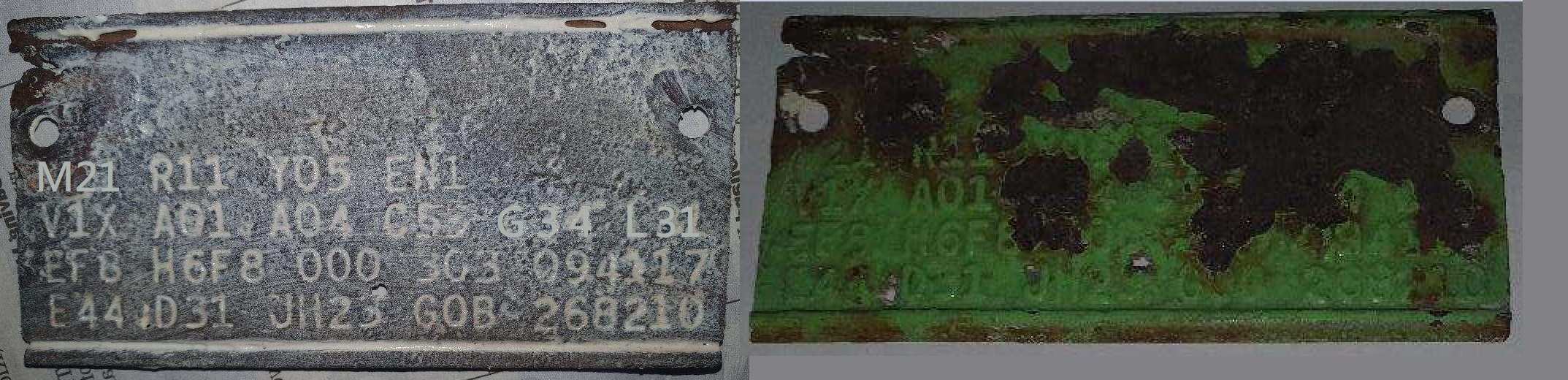

I am restoring a '70 Challenger. The fender tag is only partially readable due to rust damage. Does anyone know where I can obtain the original tag details, and have a duplicate made up?

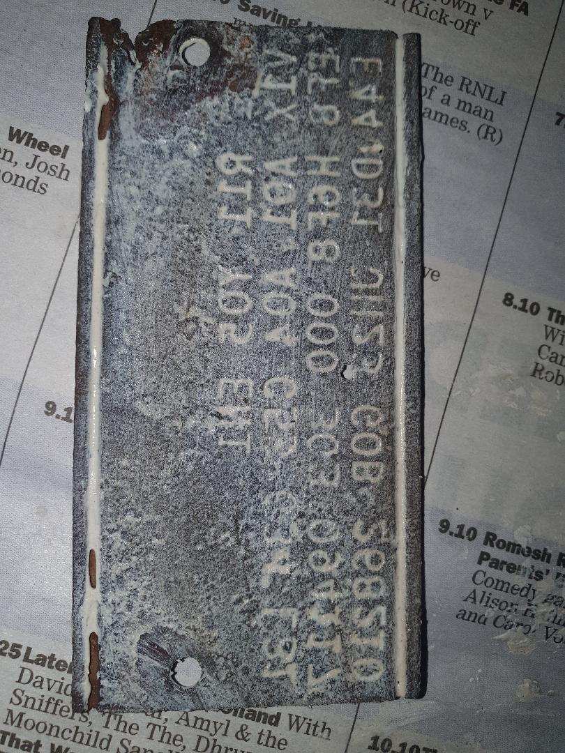

Depending on how badly they’re rusted often times the back is still legible. Have you removed it yet?

Post a good picture of the back side of it and I will see if I can invert the image for you.

Thanks for the reply. I have since done that and after rubbing it with cutting compound, most of the details came up. I am looking to having a new one made up.

top line M21
3rd line G34 L31
2nd line Ef8 VON-094117
If you didn't figure out those few codes above already.

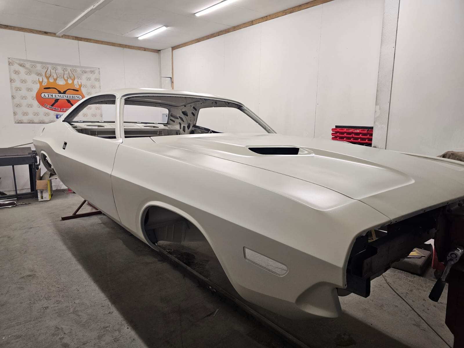

Thanks for posting the picture .
The car looks AWESOME !!!
Are you going back to original color? (or going to fc7)? haha

Thanks and Nah - Kowalski all the way!

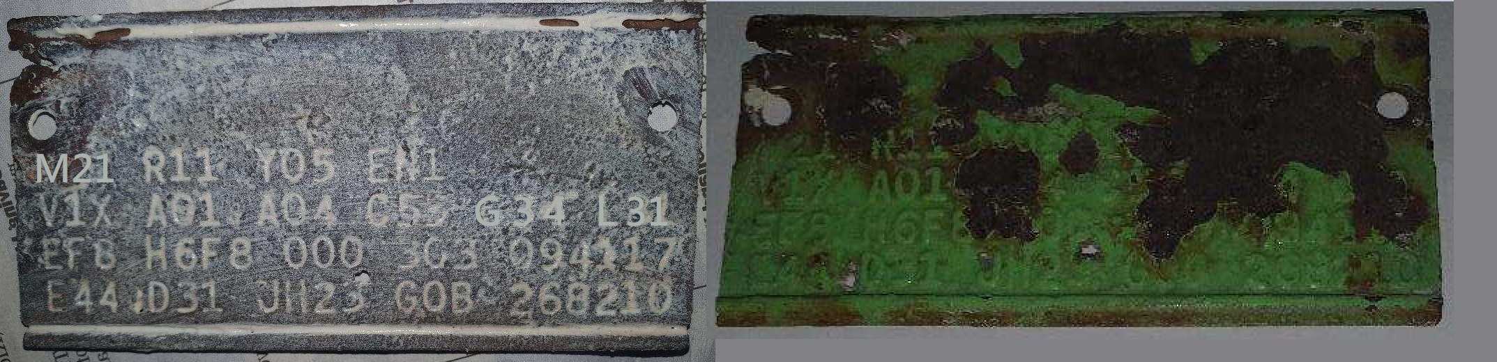

JH23G0B268210
Line 1:
E44 - 318 V8 Engine Code
D31 - 904 Torqueflite Automatic Transmission
J - Challenger
H- High Pricing
23 - Hardtop
G - 318 V-8
0 - 1970 model year
B - Hamtramck, Michigan Assembly Plant
268210 - VIN Sequence Number (168,210th in sequence, starts with 100,001)
Line 2:
EF8 - Dark Green Poly
H6 - Vinyl Buckets
F8 - Green Interior (dash, carpet, and door panels)
303 - Scheduled Production Date (SPD) of Tuesday, March 3, 1970.
094117 - Vehicle Order Number (VON), typically from dealer order form.
Line 3:
V1X - Vinyl Top, X = Black
A01 - Light package
A04 - Basic Group (see the option codes and details HERE plus enter all of your fender tag codes for a detailed custom PDF to print/save).
C55 - Bucket seats
G34 - Painted Driver's Sport Mirror
L31 - Fender Turn Signal Indicators
Line 4:
M21 - Drip Rail Mouldings
R11 - AM Radio
Y05 - US Spec
EN1 - End of codes (Assembly Line 1)

Wow! You cleaned that picture up good. Very readable now.

Okay I am impressed. Really. Many thanks for this. When I joined I had no idea how helpful you guys could be.

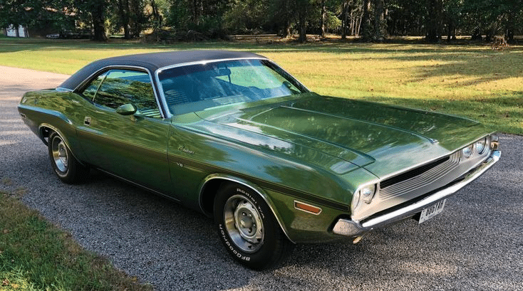

Also am intrigued by the dark green paint. It was lime green in the engine bay and matt black when I got it...

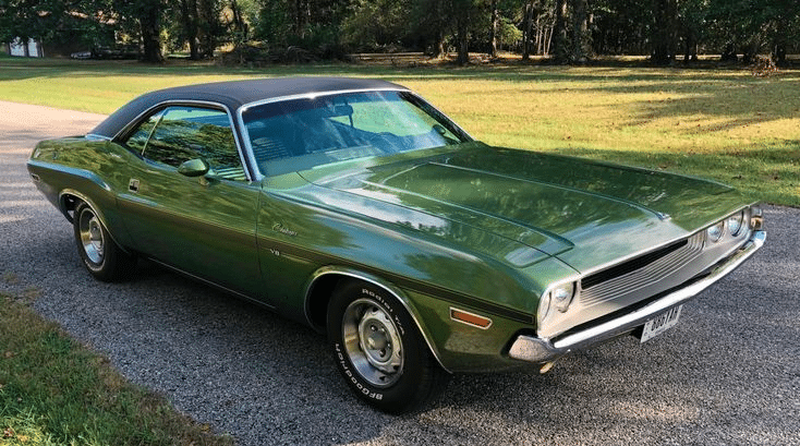

Similar 70 in green paint/green interior/black vinyl top combo.
Delete the passenger side, painted mirror and the longitudinal stripe to match the original look of JH23G0B268210.
You need a broadcast sheet, sales invoice, or window sticker to determine the factory wheels (steelies, Rallyes, or Magnums).
V8 fender callout emblem is standard for a 318 Challenger.

I have to say that is one of the nicest Challenger colours I have seen"
