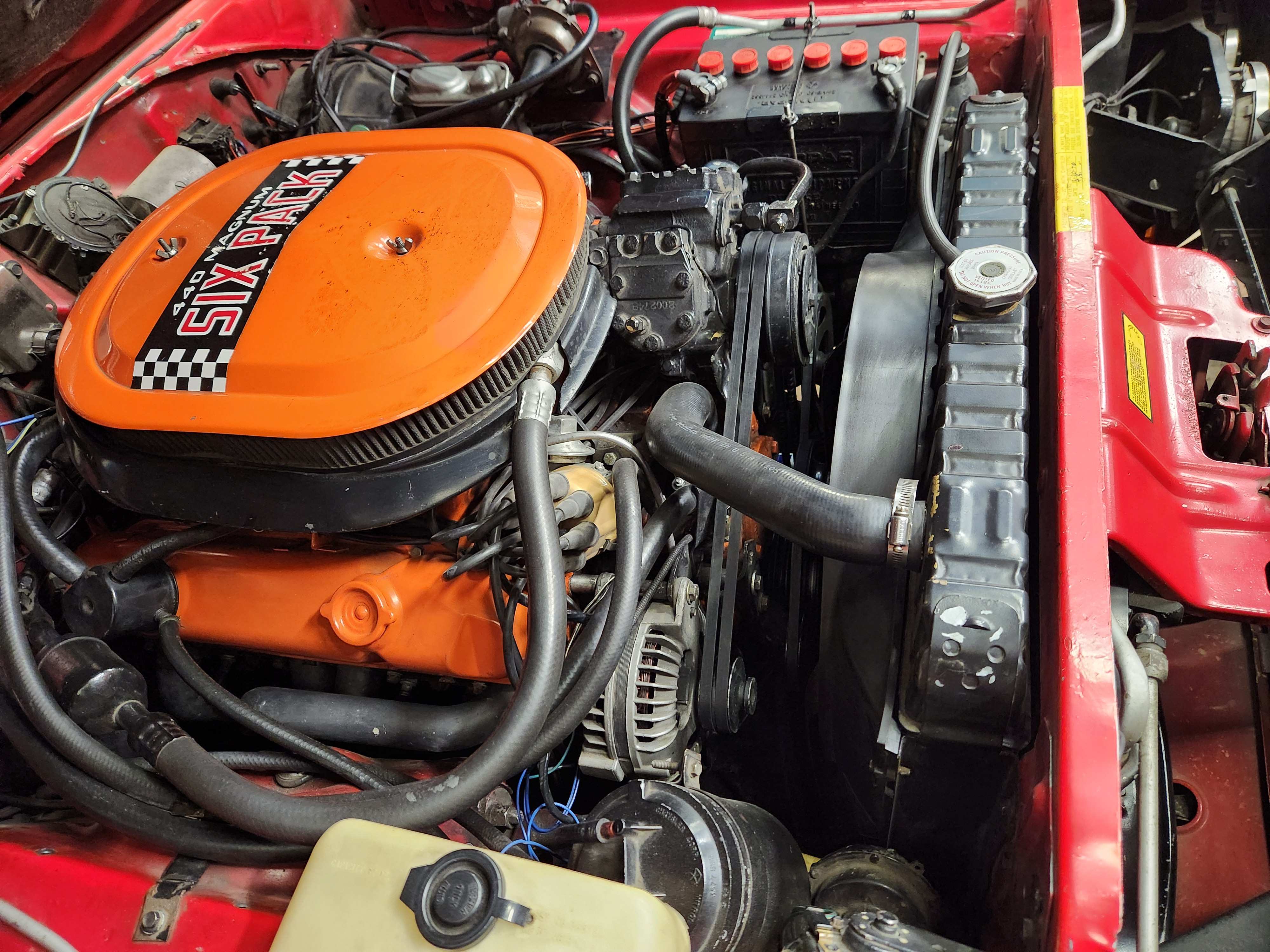

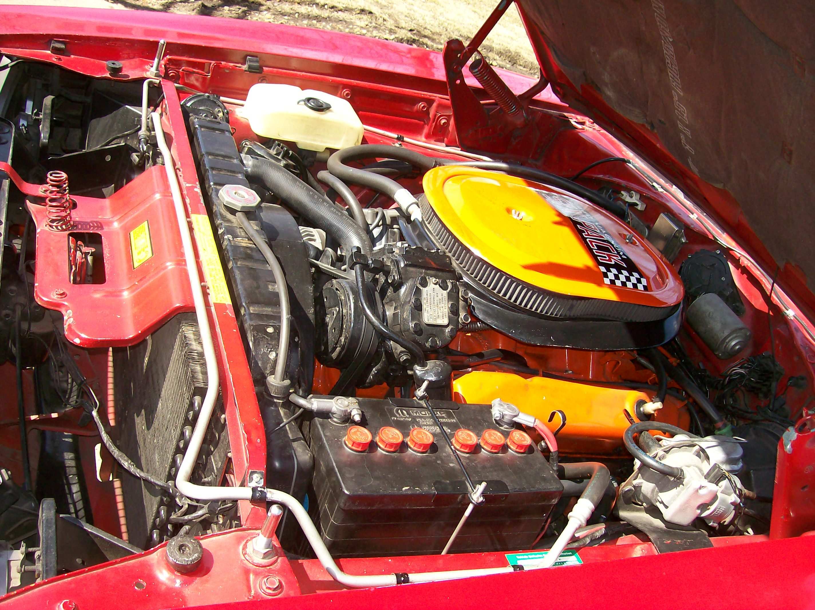

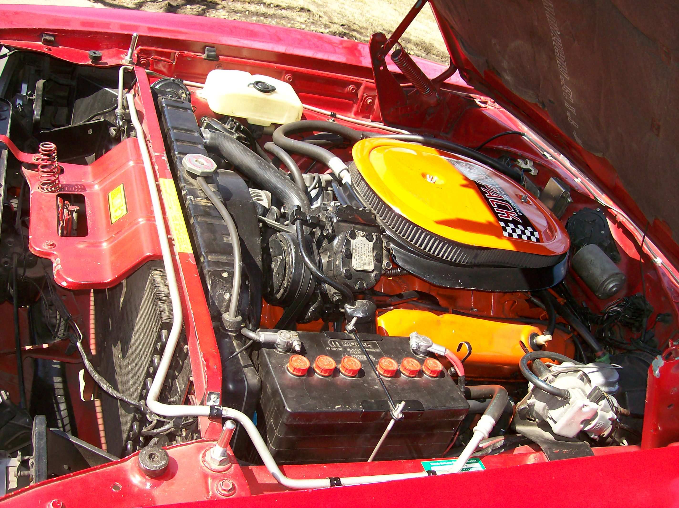

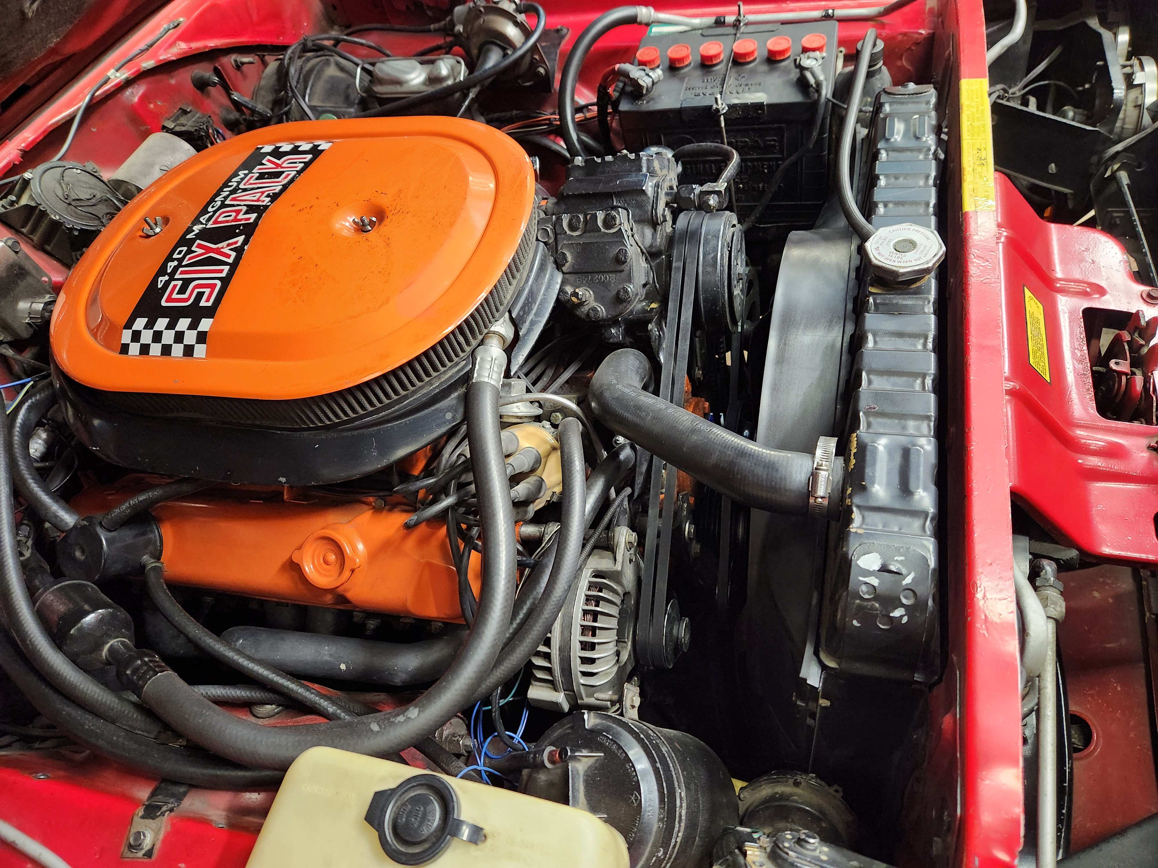

The smaller Sanden compressor would help. I know it is a different car and not a Shaker, but I have had a Sixpack set up on my 70 Charger R/T S.E. with A/C for the last 37 years that I had to notch the base.
