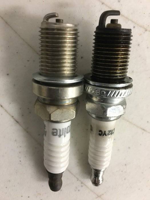

Good, what plugs, gap did you use and just make sure the gap didn’t close up on one (accidentally).
fasjac
Dec 27, 2019
2,475
1,244
Arkansas
The autolite on the left is new out of the box. The champions is what I currently use gapped at .045. I’m not an autolite fan but, a lot of friends have good luck with them. They may go in mine when needed, as the champions just don’t last long.

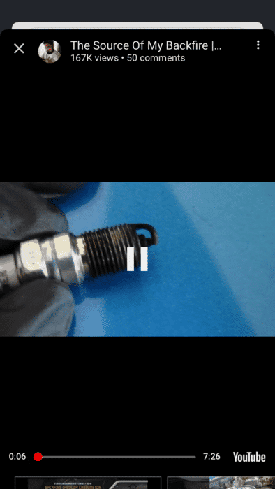

your video wont open

It was just a video from yotube. I think you’re past all that anyway. It was just the basic stuff.

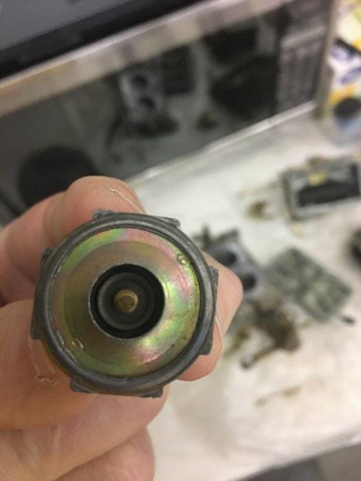

I’m running out of the box carbs from 10 years ago with no problems. My center jets are #62 I think the outboards are #84 ( would have to confirm). My power valve has a”6” on it. I know the auxiliary diaphragm is a 31. Had to replace due to dripping fuel.

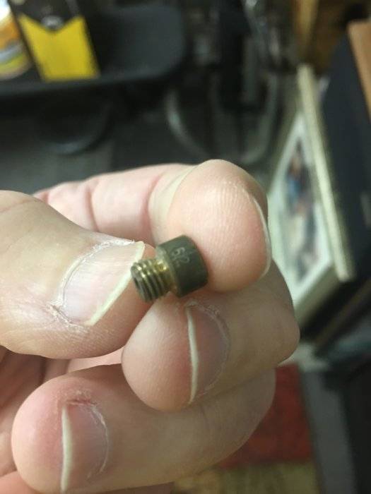

I’ll tell ya, the out of box did really good on mine. I have two center carbs.
Here’s what in them.
fasjac
Dec 27, 2019
2,475
1,244
Arkansas
Here’s what’s in mine. The 6 is all I can see on the PV, but 62 for sure on the jets.

61 or 62 is normal in the center carb , accelerator tunign may get rid of a stumble but often low intake vacuum & air bleed that are typically too big can cause a problem too , inserting a piece of welding wire usually .035 into the bleeds can tell you if that is part of the problem , I make a horse shoe & slide it behind the squirter to trap it with both ends into the bleeds
