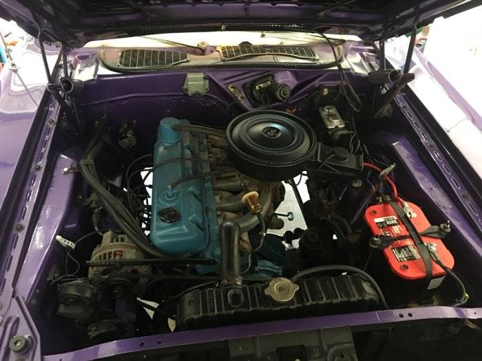

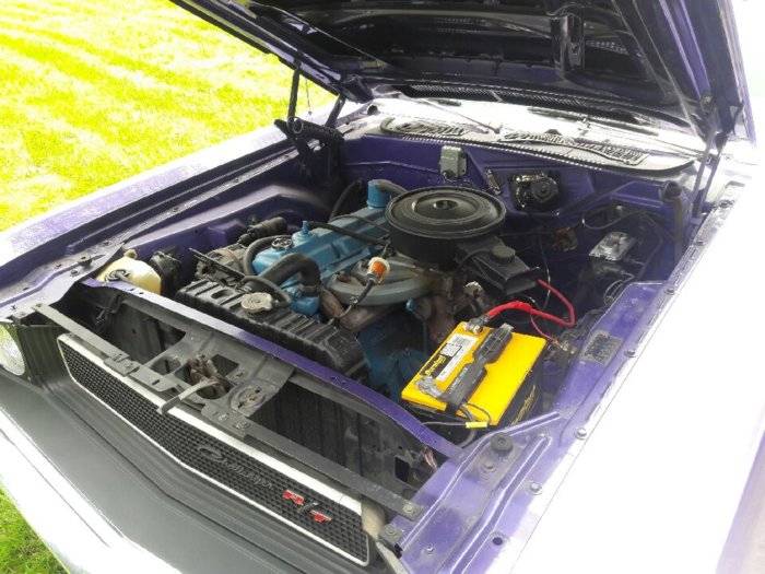

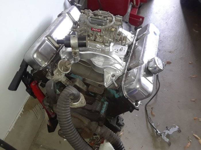

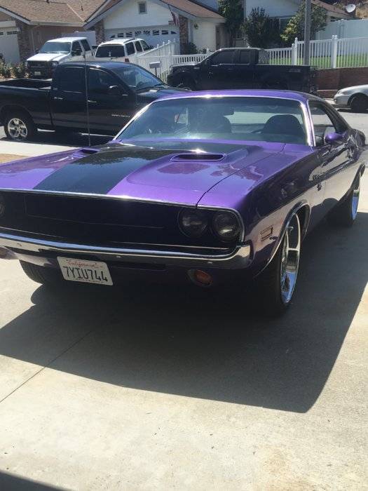

Here goes folks, received my date code correct 440 today as well as my A833. Have the 8 3/4 rear end all rebuilt and ready to install as well. Here is a couple before pics. Stay tuned
Nothing wrong, its been rebuilt and runs like a champ. I am just wanting MORE power, and 4-speed

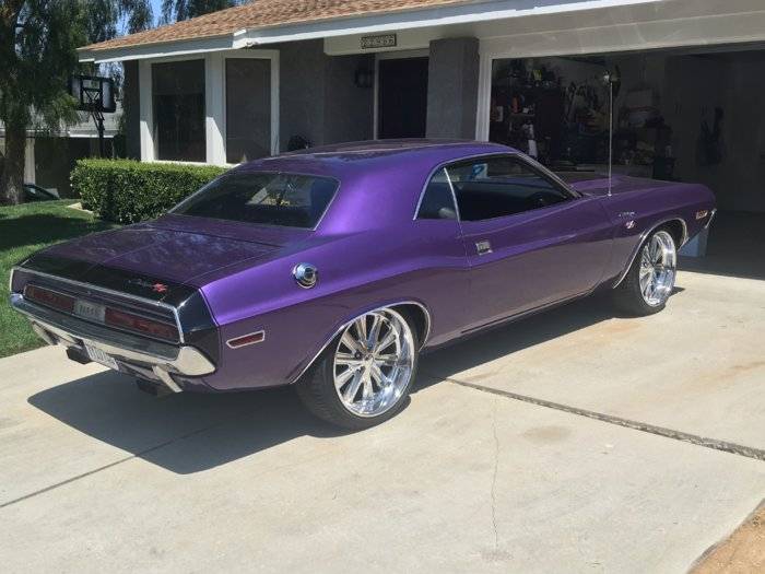

She is certainly worthy of a 440. Needless to say; It will become a different car all together, you will know what I mean the first time you drive it with a 440 in it. It's not just the extra power!
I owned a Challenger with a slant 6 for about 10 years and drove it to work everyday, never got a ticket and it was very good on gas, I take it you have other plans! LOL.
Best of luck
Are you going to swap the K frame or use conversion mounts? if you use conversion mounts it will be easier to go back to original, you probably never will though. I wonder how many slant cars still have 6cyl engines not many I bet.
Idid not know there were conversion mounts, if so I would consider it instead of swapping out the K frame and all the suspension. Anyone know where to find the conversion mounts?
What size carb? and what else have you done to the engine? it looks really nice. Do you have a sure grip in the 8 3/4? you will need it with all that torque going through a 4 speed.

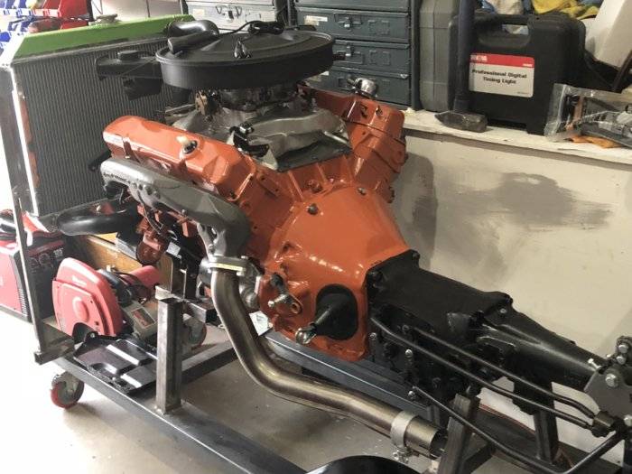

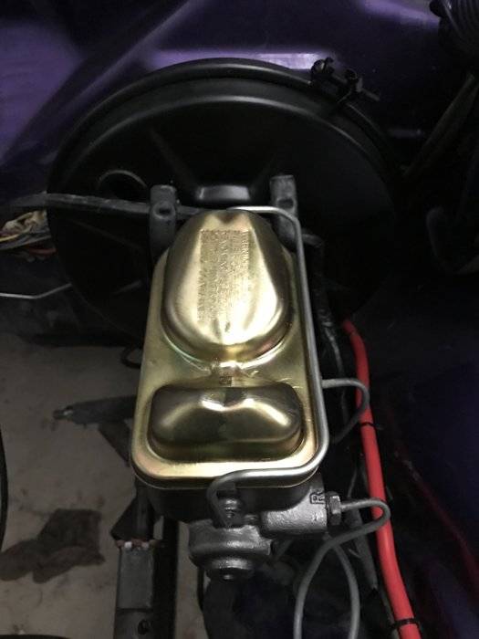

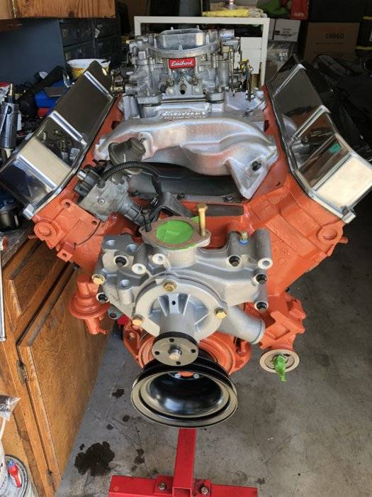

Ok, So engine is complete and I finished building my engine test stand. 6 is out, 3 speed out. New K frame in and all new STOCK big block suspension. Can't wait to get her home and put in the power brake upgrade. I still need to wire the engine stand, but should be finished this week and can see how she runs.
Very nice. Btw, shouldn’t the weep hole on the water pump be pointing down?
Good Catch Adam, as my brother was installing this as I was welding up my test stand.... Much appreciated
Man, going from a /6 to a fresh 440.....gonna be a whole lot of smiles!!!!!

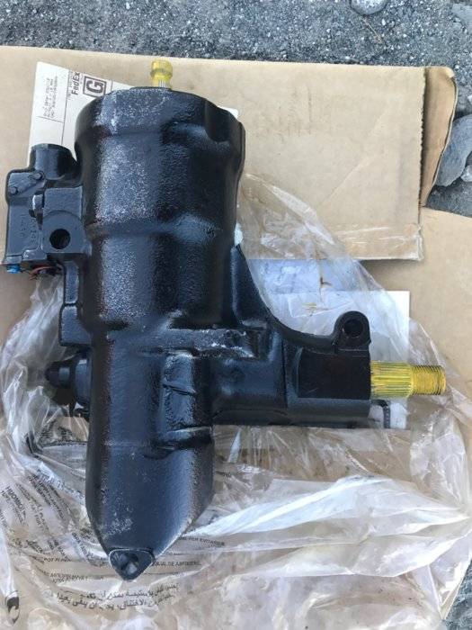

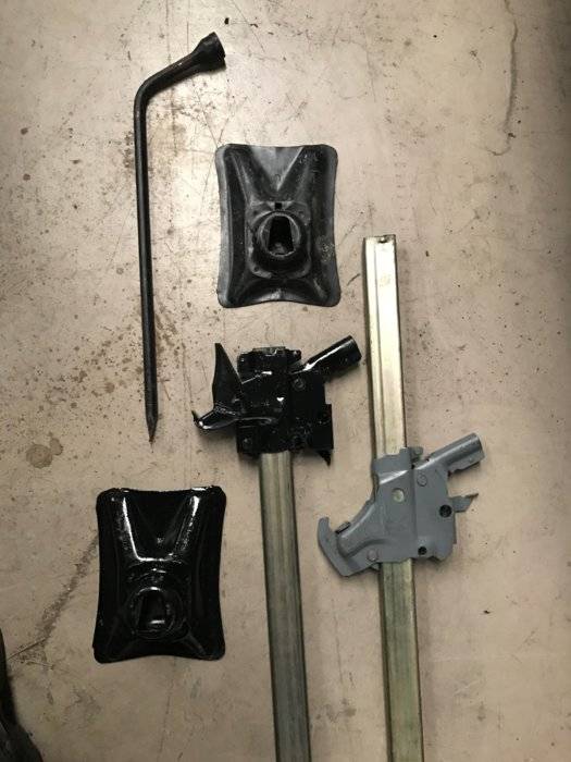

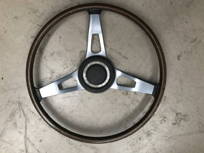

Ok so I am updating, found a few restored parts and ready to put in Correct steering wheel, correct jack ( I know its's not perfect) but, is a 70, and a rebuilt steering gearbox

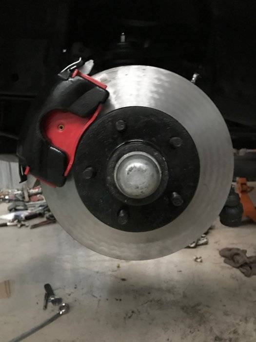

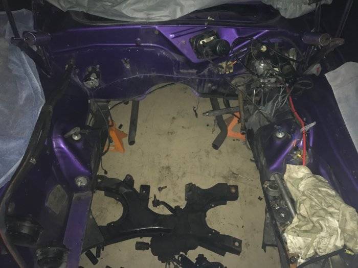

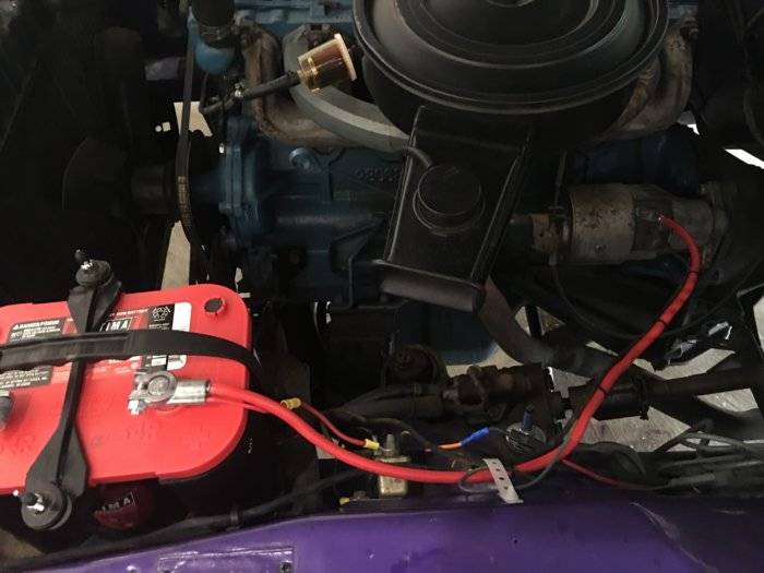

Ok so here is the Engine bay ready for rebuilding to carry the 440 put in all the suspension and converted to 70 correct disk brakes.
