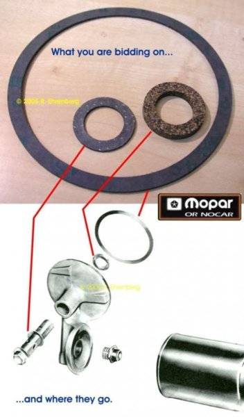

Just for reference:

.and you need to be very careful mating the adapter body to block with the cork ring that is compressed during torque down. It is very easy to have it get off center and with the rest of the bolt tightening and outer seal fiasco going on end up crimping that cork ring. Then you have an epic mess and a chance to buy more gaskets and do it all over again. Don't ask how I know.
