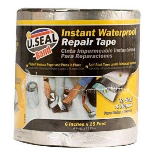

I use this in my dart and truck actually think it is easier to lay down and way cheaper also.

I have used both Dynamat in my 74 Challenger and almost broke the bank. I used a similar product to what Halifaxhop has listed but purchased it from the local HomeDepot. 1/4 of the cost, almost identical to the dynamite and has better adhesion. Im a firm believer in the Homedepot version for less than $100. IMOP its a great product.
