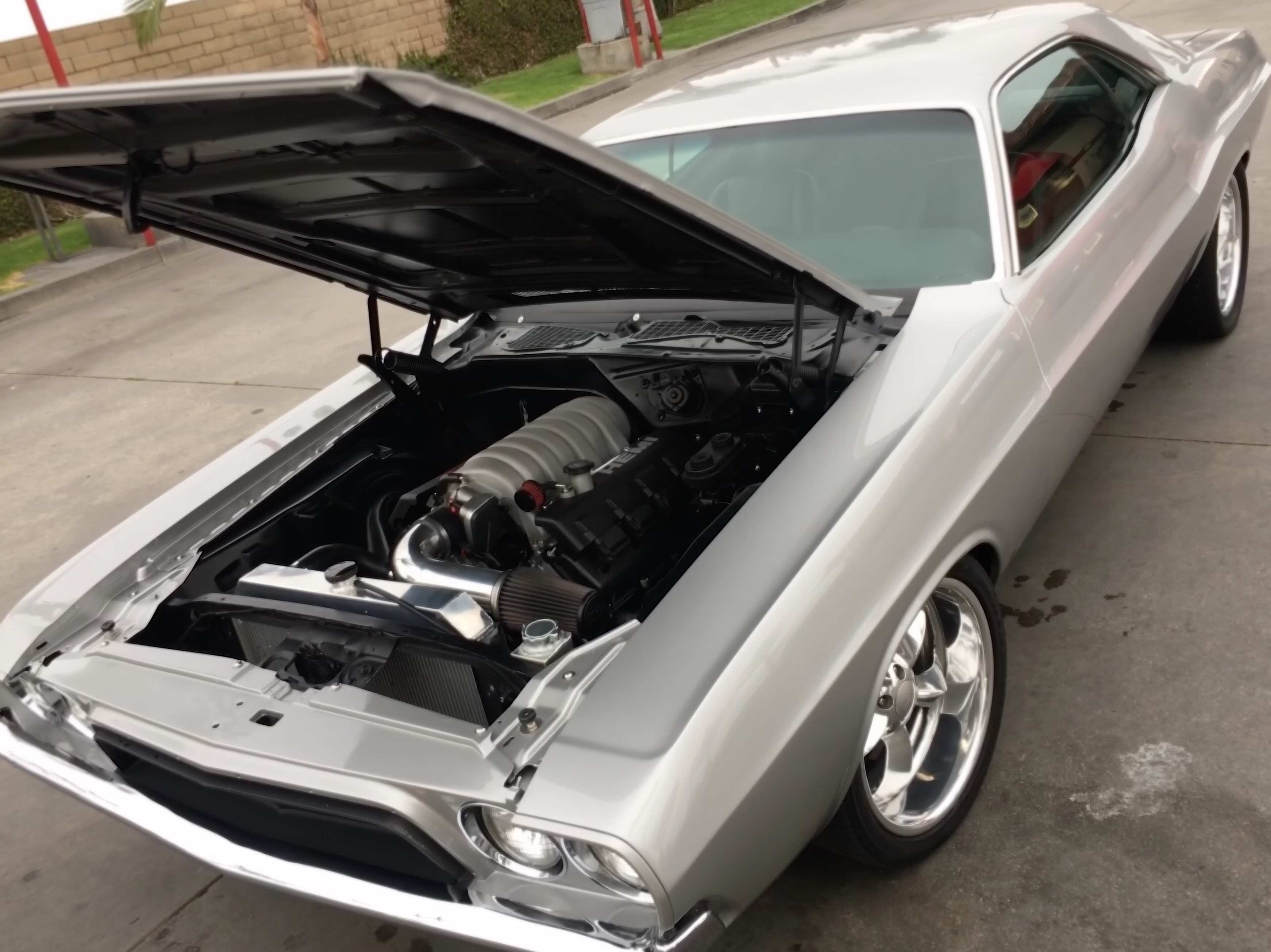

I have done this swap with the 6.1 .. It as said makes 425 stock with much better internals rods , pistons etc no Mds .. I do run the 545rfe with an 2008 Ram 1500 computer and Hotwire harness. With the 3.91 gear , it does a nice cruise plus i can get into it a bit without a problem , very fun car to drive

Wow, the car looks awesome! Sounds like a blast to drive as well. Thanks for the input. Finding a 6.1 around here is proving to be harder then originally expected but I am still trying to maintain that as my goal. I picked up a Aisin AR5 to bolt to it, so will be doing a bunch of information to learn as much as I can about that as well.
