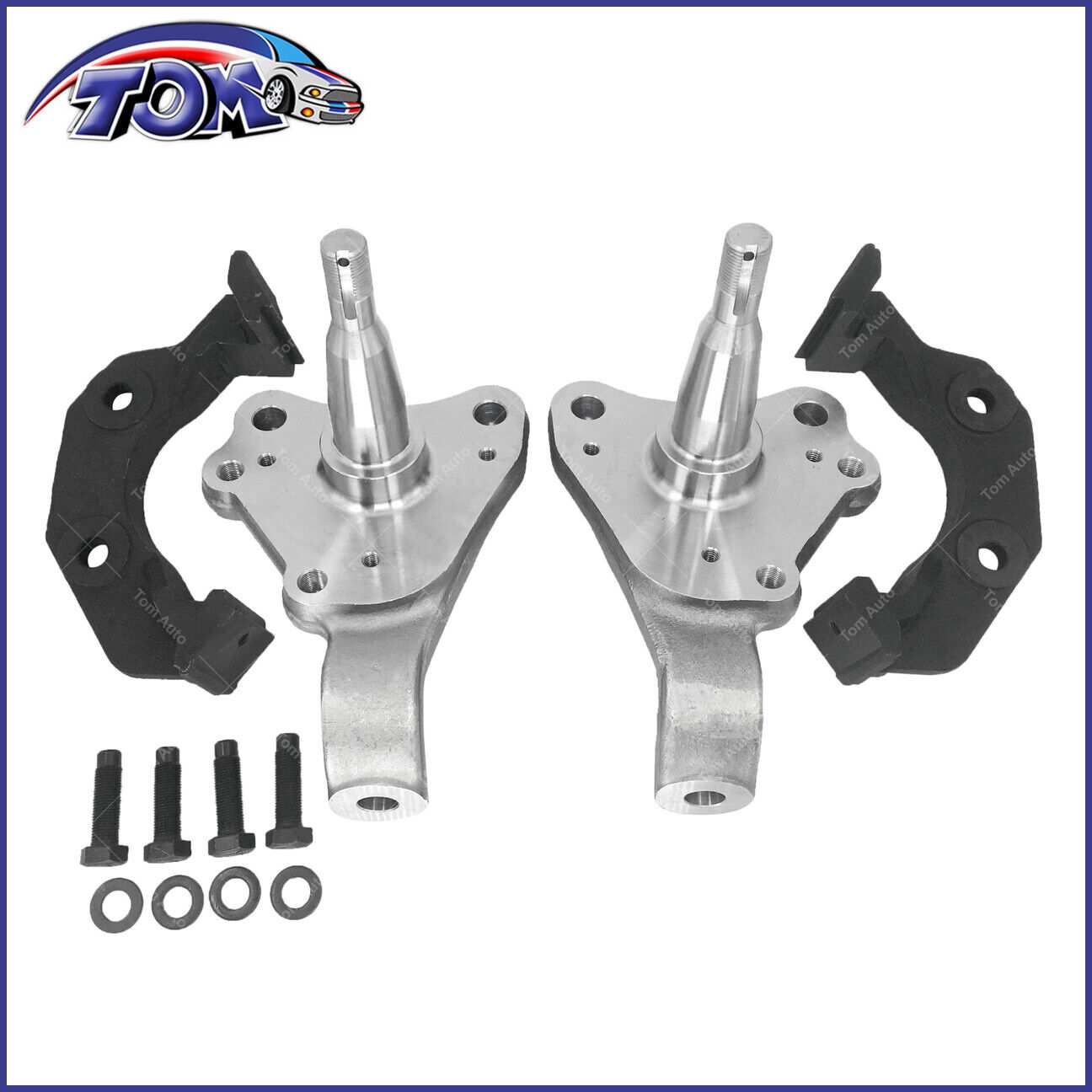

Anyone have experience with these spindles on eBay? Are they any good or just cheap China stuff? Thanks

They are all made in the same foundry, probably in Taiwan where all the rest of the AMD/Goodmark/Dynacorn stuff is made. They are copies of 73 and up A body spindles, which are exactly the same as 73-74 E body spindles. A bodies had the slider calipers like pictured above, while the E bodies kept the pin type calipers throughout all 5 years of production.
Thanks! That explains why all pictures from different vendors are the same.

If you have time to look around a bit, you can find factory spindles at a fairly reasonable price. You can even use spindles from F/M/J body cars. Aspen-Volare-Diplomat-5th Ave. The spindles from those cars are 3/8" taller than factory A & E 73-74 spindles, but that doesn't hurt a thing. Supposedly, it actually helps with front end alignment. If you can find spindles, you can build from the spindles out from NAPA, AutoZone, O'Reilly's, etc. If you can find caliper brackets for 11.75 rotors, the 11.75 rotors are a direct fit to 73 and up A&E spindles, and also the F/M/J spindles. Same bearings and seals as the 10.87 rotors that are stock on A, E, F, M, J cars. The bigger rotors came on late B bodies like Cordobas and Chargers.
