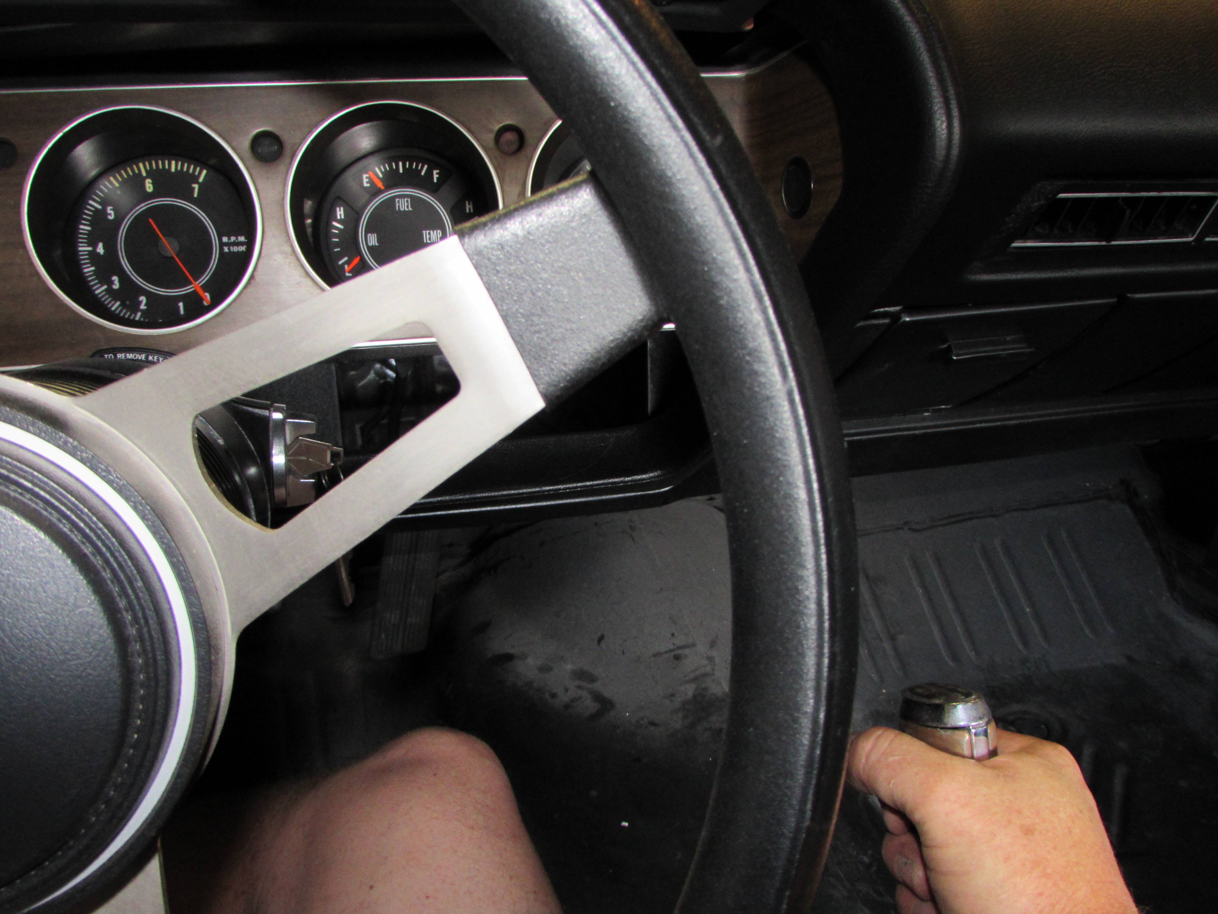

Like a tough wheel or something aftermarket? This is a photo of one from Classic several years ago.

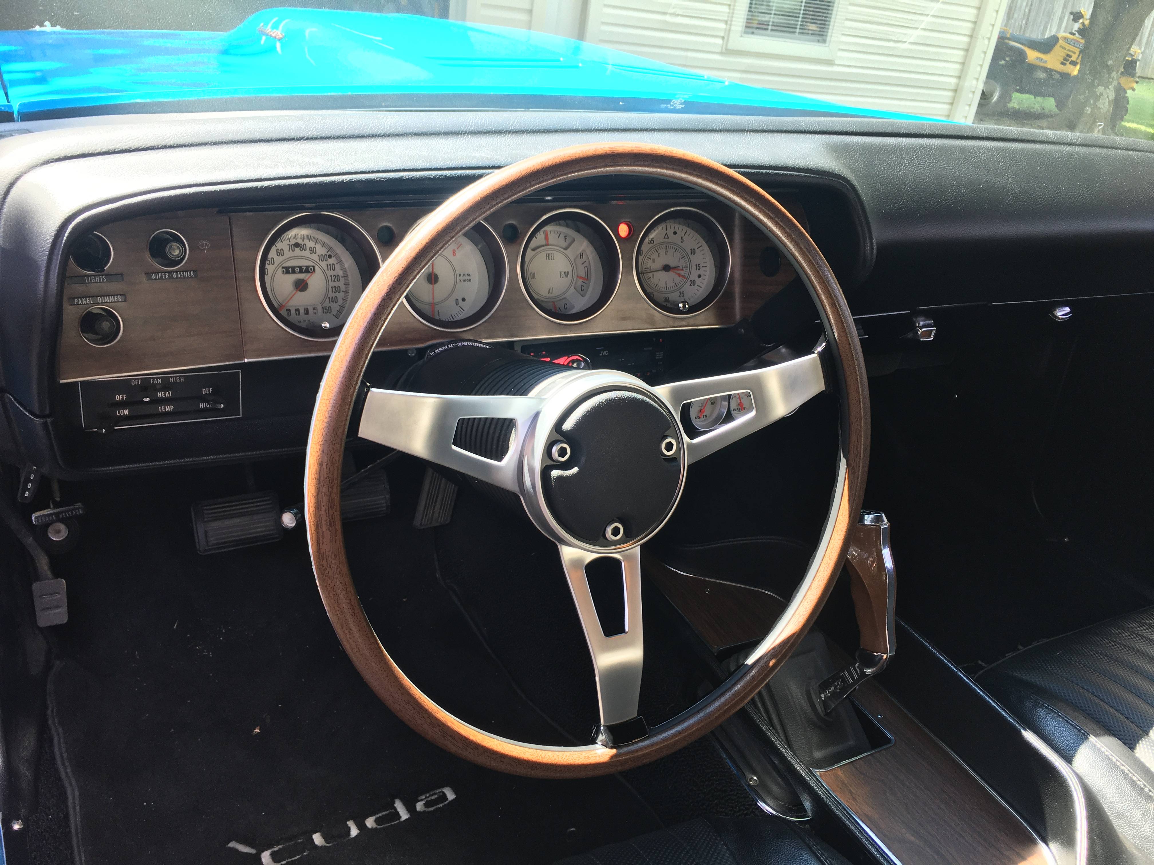

Just to chime in, I haven’t measured the rimblow wheel but, I can tell you it’s very comfortable driving. It’s probably 15” or about. This one is from OER.

The rim blow (last wheel shown above) is pretty big and if you don't have 6 way seats or a tilt column you might find it difficult to live with (getting in and out). A tuff wheel (first one shown) is pretty common and there are a lot of them out there both original and after market. There are some very good aftermarket ones available and they run $200+ and there are some cheap versions like the Grant Challenger which is typically less that $50. The Grant looks the part but the spokes are very thin and basically just stamped plate and the wheel is foam wrapped.
I have Tuff wheels on my Challenger as well as my 52 B3B and I like them.

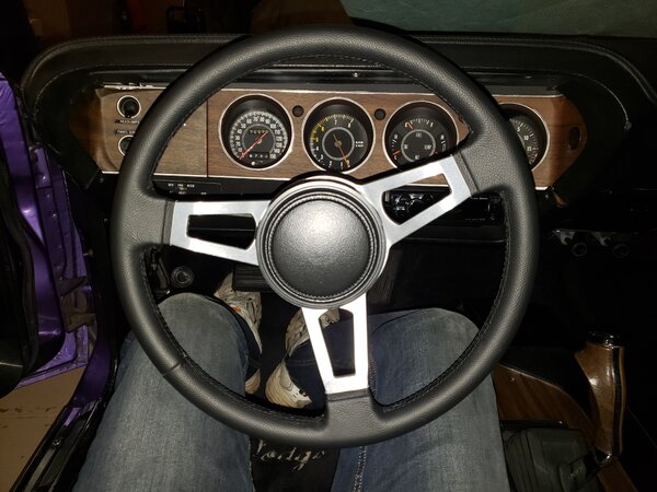

I had the same thoughts when I was looking for a new steering wheel. I had a 15" wheel from a '72-74 but never really liked that look and I felt like it was a school bus steering wheel. I went with this 14" Flaming River Tuff Wheel:
Satin Finish Mopar Tuff Wheel New Leather Design - Black with Satin Aluminum Spokes
I'm happy with it. It's not exactly the same as the original tuff wheels were but it's nice quality and pretty solid. I didn't think it would, but that 14" diameter made it feel so much better to me.

Flaming River Wheel:

Hey Jimmmay, That’s it, that’s the one I’m looking for. I agree, a 15” still feels like driving a school bus. The stock 16” wheel is just too big. I want to take advantage of the new quick ratio steering box, and the 14” wheel should be perfect. Thanks for the info.

The Flaming River "Tuff" wheel is 14" diameter (better!)... and has a leather-like material... better than slippery OE rubber. I'd recommend the Flaming River wheel over the factory OE or the Grant.
These above wheels (Grant or Flaming River), bolt directly onto the steering columns using the three studs.

Yeah, I agree. I went back and forth for a while between the Flaming River and getting the cheaper Grant wheel, but I wanted the smallest tuff wheel possible. Flaming River is actually right down the street from me too, so I felt like I was at least doing my part in supporting local businesses. Haha... I know how you feel. I don't know if I've said "wow, that part is cheap!" while working on this car yet. No adapter plate needed on the ebody, either. The wheel fits right up to the three studs on the crush can.

I bought the Flaming River Tuff wheel, but returned it. Originally, the Flaming River Tuff wheel had stainless spokes and used the factory horn button assembly. I think it also had the countersunk mounting holes to use the factory nuts and provide a more secure mounting than through holes. Currently, their Tuff wheel has through hole mounting holes (no countersinks), aluminum spokes and a flimsy, thin plastic (non OEM) horn button. Other than that, the diameter is perfect and the look and feel of the leather grip is very nice.
