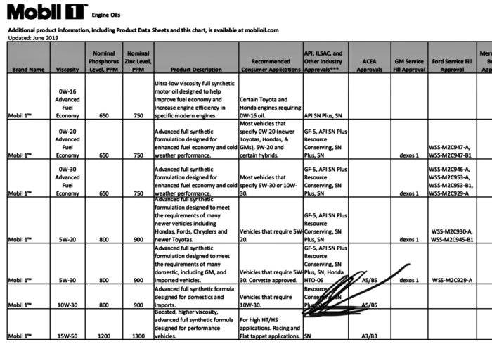

If I remember right there is a mobil 1 oil that’s good with flat tappet cams. Has a decent amount of zinc also available at Walmart.
Found it. Look at bottom line of page 3 15w50. If it’s good enough for flat tappet I’m sure it’s good for most everything else. Additives like zinc sometimes fight with oil additives already in most oils. So just adding zinc may or may not be good.
https://mobiloil.com/~/media/amer/us/pvl/files/pdfs/mobil-1-oil-product-specs-guide.pdf
