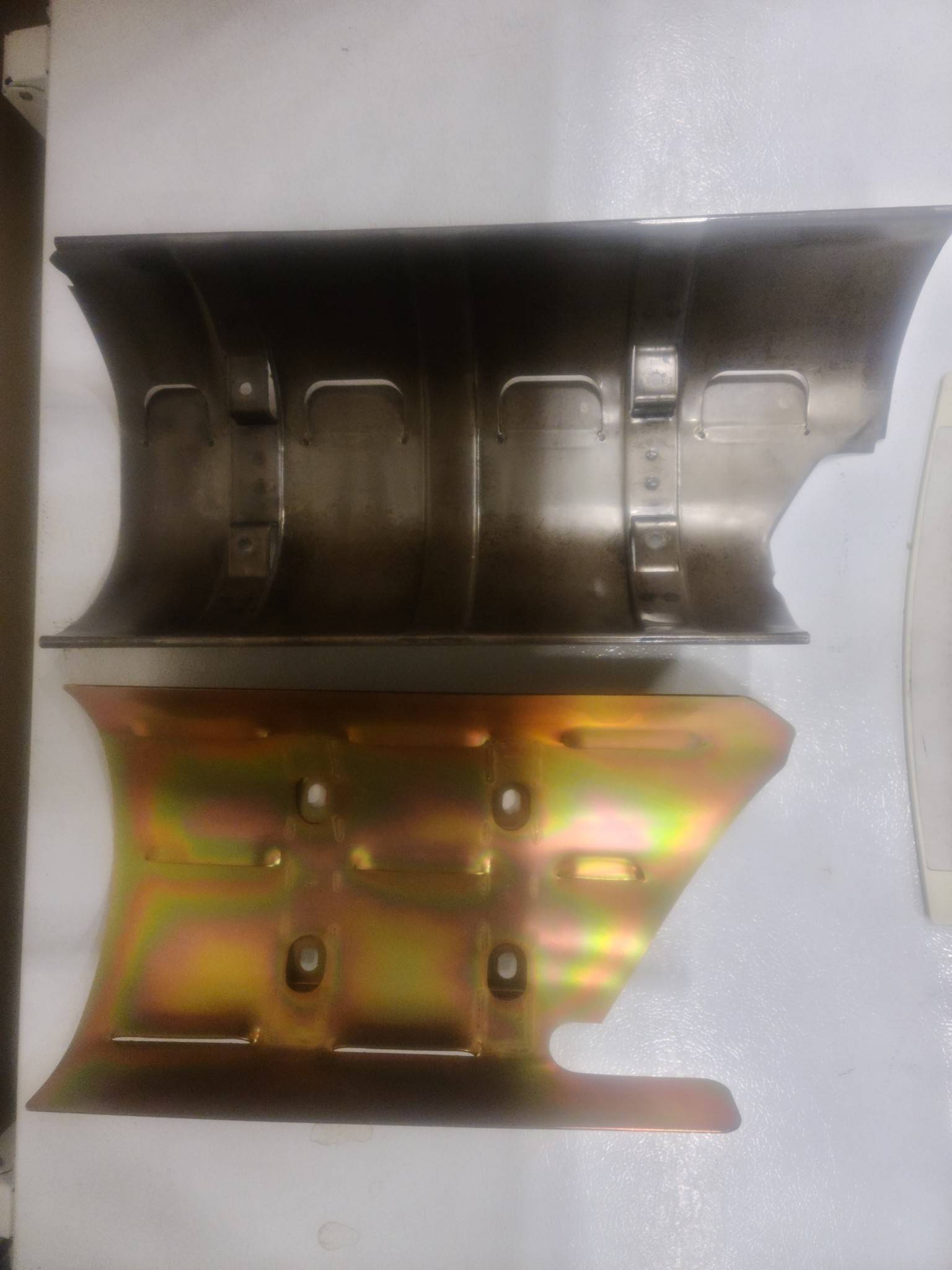

Windage Tray on 340 - Use the original or go with new Milodon windage tray with new larger Milodon oil pan? Is there a difference?

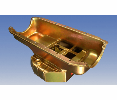

Is this the road race pan thats gated?
I have the milodon U weld it gated pan kit, that I was going to use on my next motor, but it has a full T head shape.

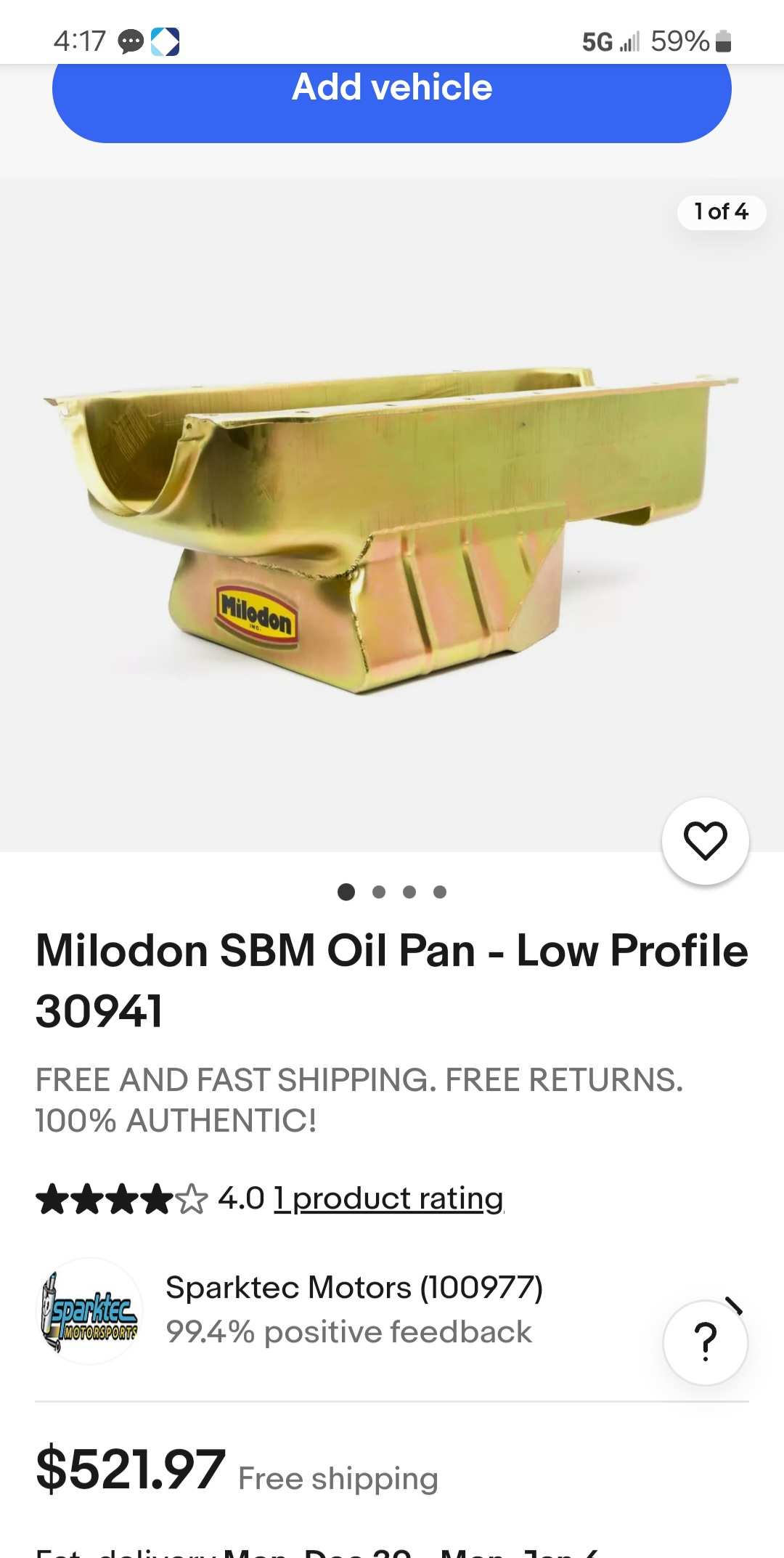

No. That’s the “Low Pro”. It has the notch in middle to create a higher spillover wall during acceleration. That feature was used in the road race pan too.
p/n 31590 for 340
Milodon Road Race Oil Pan
Your right, it was moroso.

I expect that pan would be $800 if the other one is mid $500

$614 from Mancini

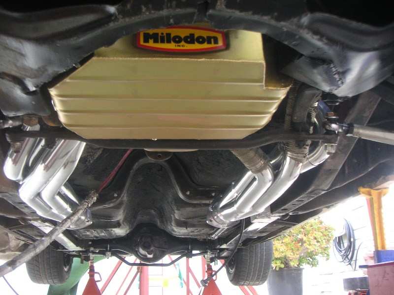

The curve of K-member rear lip creates wide pan issues.
Really so in A-body 73-76 K-member applications I help test fit it on.

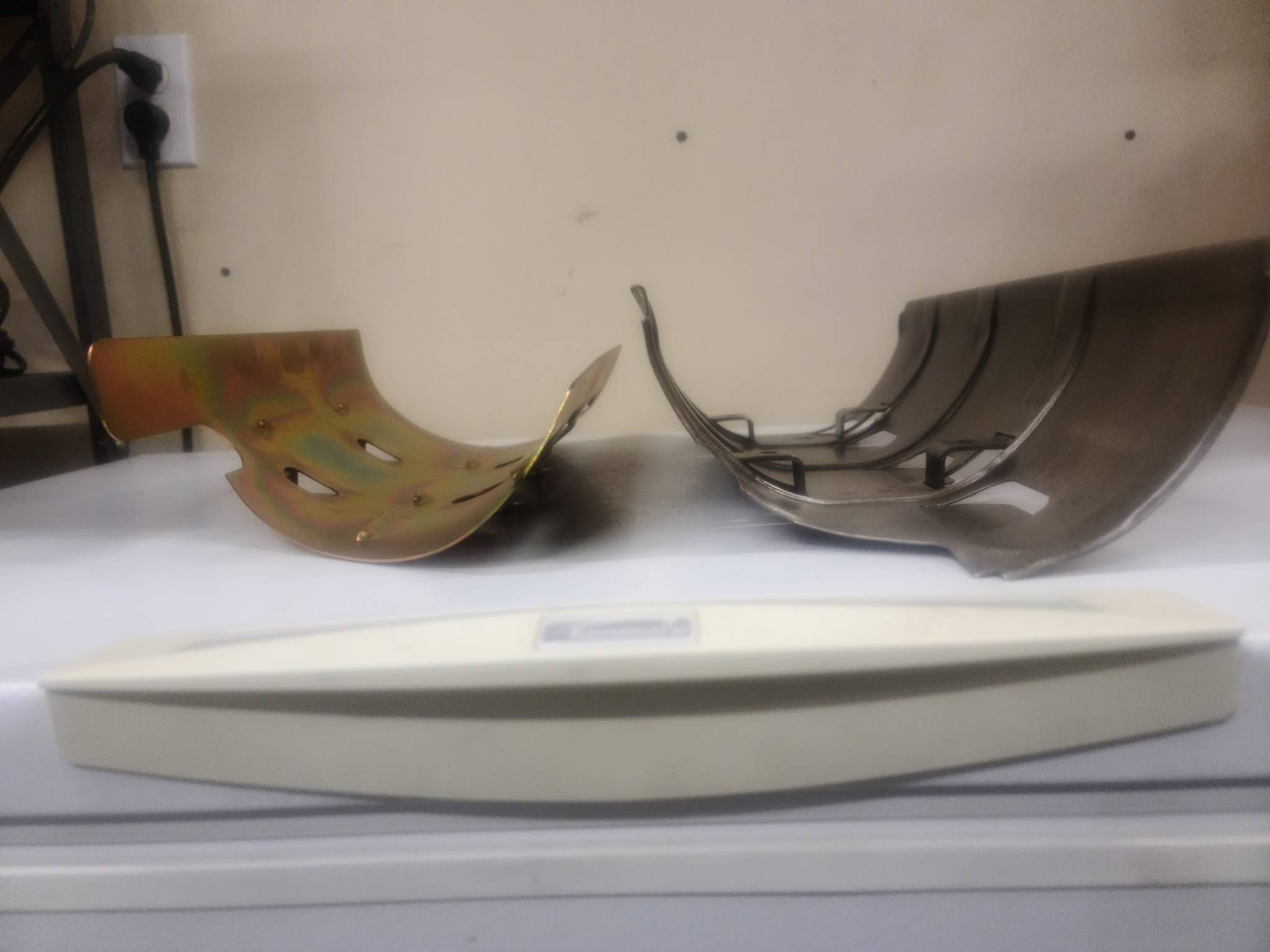

Mancini makes a replica of the original which faithfully replicates the original design for the windage, fyi.
Awesome. I was able to recondition the original tray, have the crank cap bolts both are in great shape, but am curious is to what type of bolts will screw to the cab bolts. Anybody ever change them out?

Looks like you used header wrap to protect the starter/wires. Are your headers ceramic coated as well? I just got my set of Doug Thorley headers. Motor is still at machine shop. Did you have to loosen your engine and raise it to get your headers in?
I put the headers in at the same time as the motor. But it was in an A-body. So tighter engine compartment than an E-body. And I run a 73-76 Spool type motor mount K-member that even tighter. With this 73-76 K-member in an A-body, the motor can only be put in without the trans connected.
I got it cleared through the wife and the new tray and hardware are on their way. Better piece of mind. Thank you for your help!
