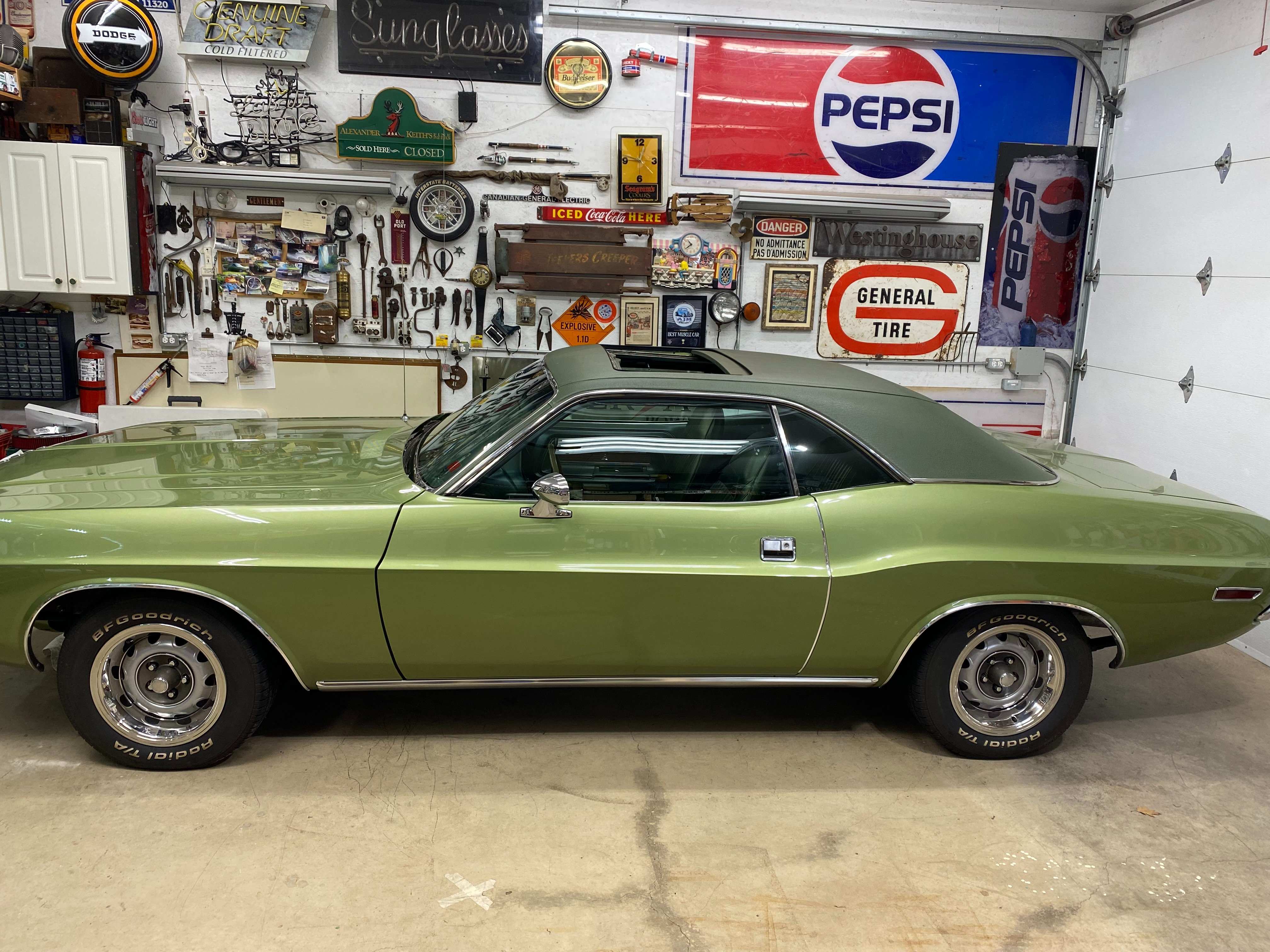

sorry for posting it wrong so i'll tell u what happened; I was never a person to work on a car except brakes and small stuff.I bought this car at 23 yrs old (1974)and tried to redo it myself 30 yrs later when i messed it up i parked it up until 8 yrs ago and could afford a frame up restoration. I have been driving it for 4 summers( Put 17000 miles)and enjoyed it immensely (i'm 71) well i always felt something wrong in the handling compared to when i first got it and had it looked at by 3 front end guys and they found nothing. Last week i heard a clump and jacked it up to find the bracket on the lower control arm that holds the sway bar broken I took it apart and got it welded.2 days ago when i reassembled it i found that the bar was installed in a 45 degree angle and was not fitting right. After checking on a 72 i figured that when they re assembled the car they put the wrong bar in and now am looking at an aftermarket part unless i get lucky and get an original.The body shop claims that they put in the same part but at 23 years old i was driving the*&^%% out of the car and never had a problem From 35000miles when i bought it to 83000 miles when i parked it in 1976. I now have 99740 miles and a wrong swaybay.So that's why i am where i am.Sorry for posting it wrong,i thought it was in wanted to buy i'lltry reposting later thanks for the info
