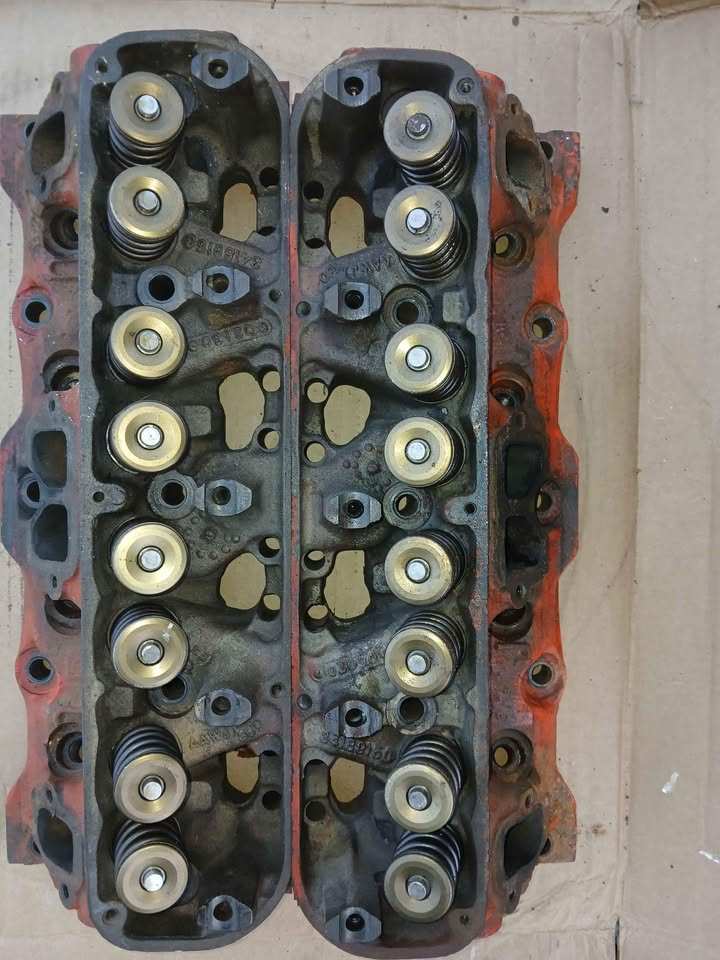

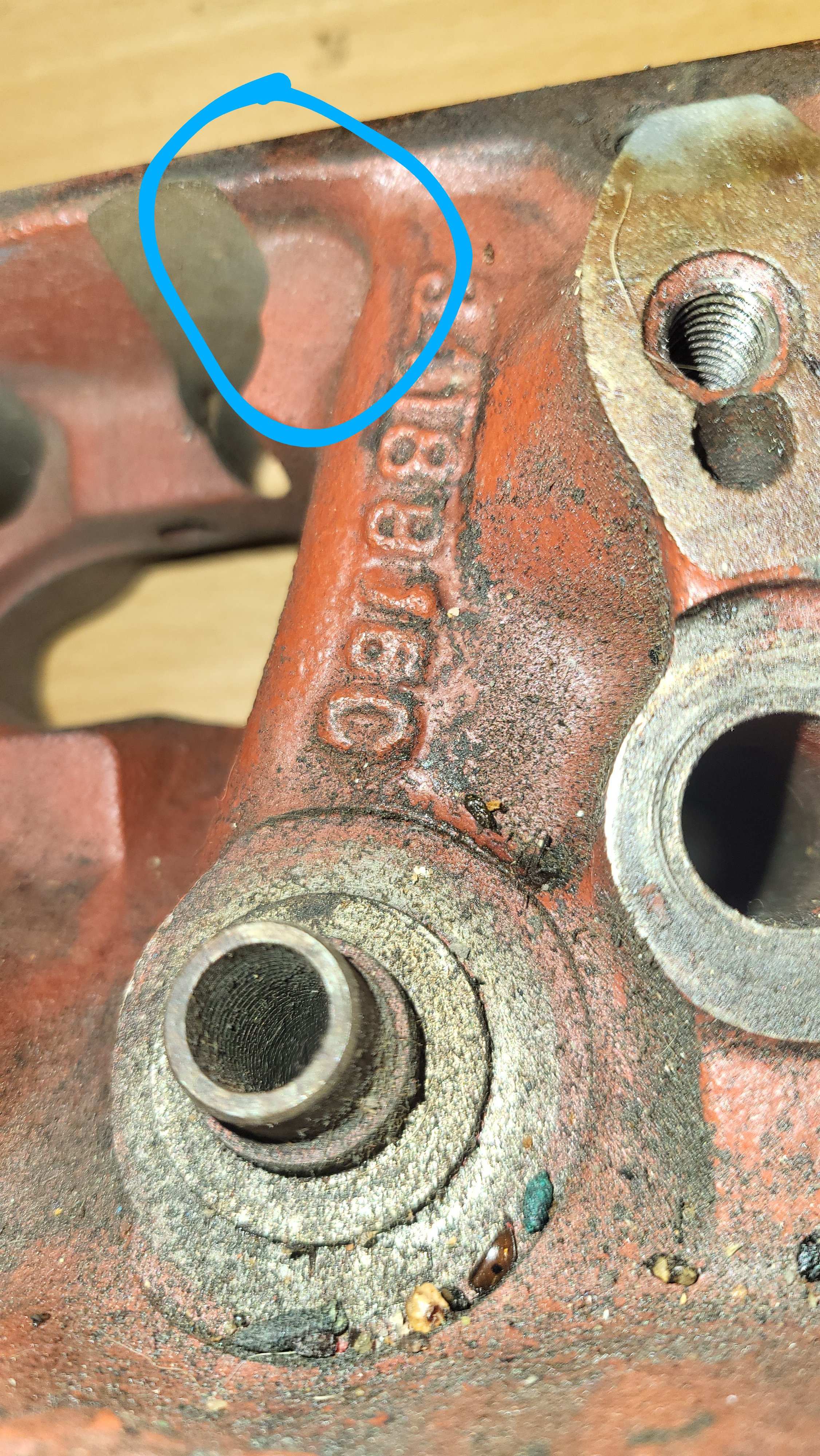

His heads are definitely TA heads as the non TA pushrod indent is on his heads. See circle below. Thinking more about it, this 360 could be built up with those heads and more gas pump friendly compression pistons and ~.500" lift camshaft and last basically forever without ever blowing a head gasket!
Yeah I'm trying to decide what I want to do. I could build it but I would want to be conservative with it. My trans and rear end are stout but I would have to really beef up the car to handle a lot of power. 360 block and heads may should stay together
