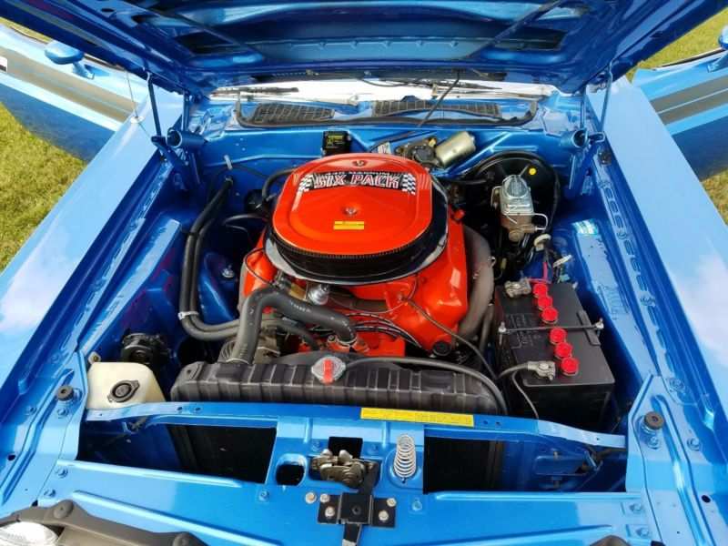

For those of you that have a T/A is the cowl & the fender bolt area satin black or organisol black ? Also could someone show a picture of where the hood pins go on the fender. Thanks

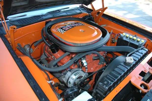

Something like this.

EV2RTSE
Dec 13, 2013
428
280

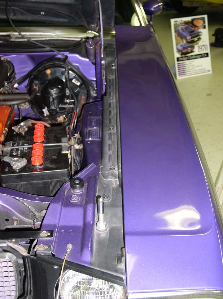

Here's a pic (not mine) of a T/A fender and the hood pin.

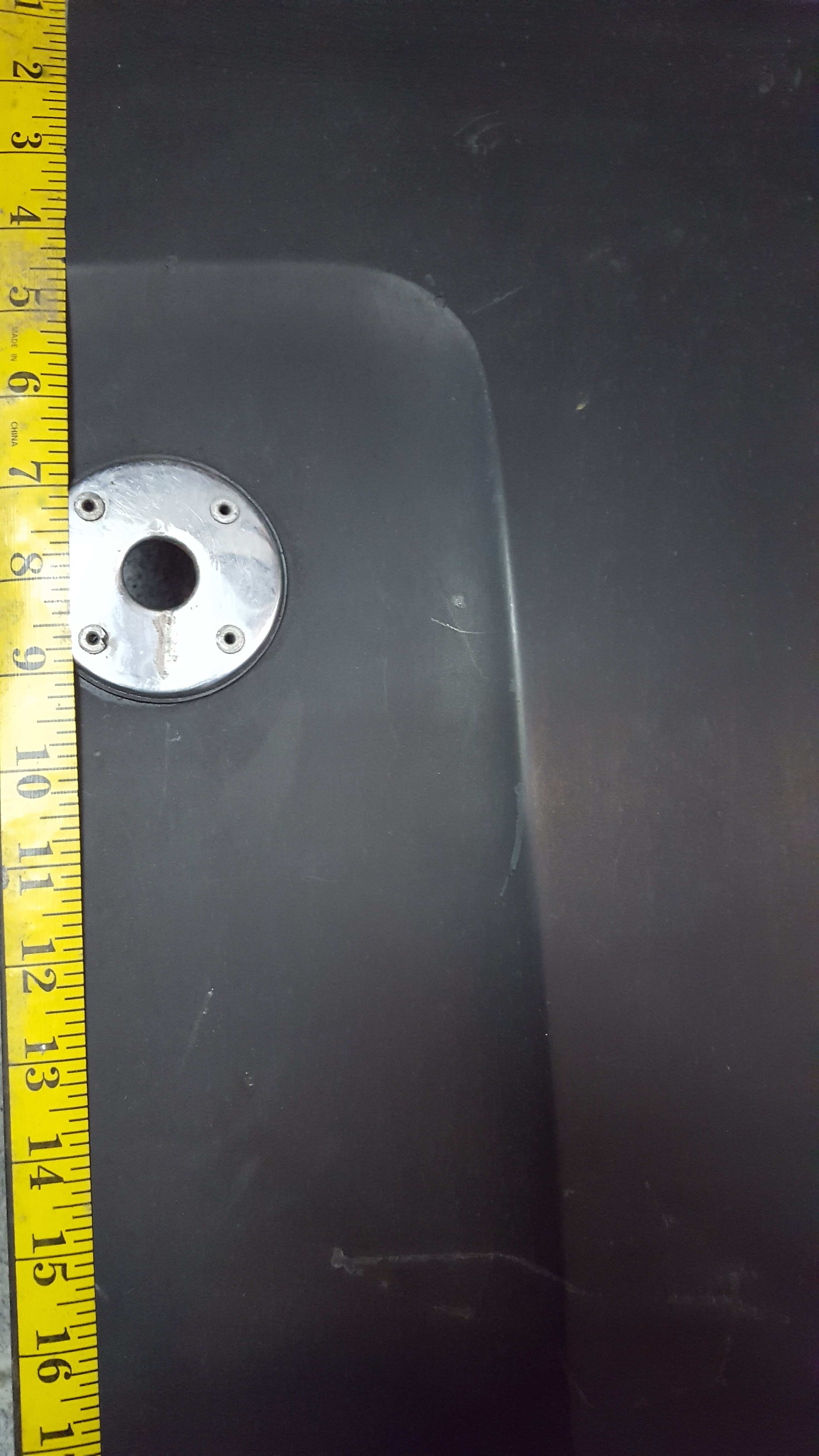

On the hood measurement from the front edge along the outside edge. Used a tape measure and a seamstress tape they both measured the same 8". At the 8" edge in 1 5/8" for center. I would drill a small hole to start and adjust as needed. For everyone of them can be just a little different.
