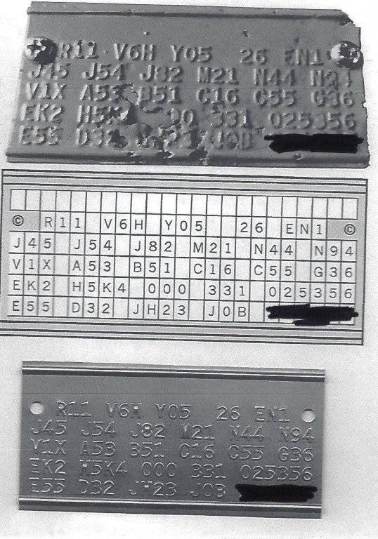

Is there any other TA's with H5K4 trim burnt orange with salt & pepper cloth inserts on seats with carpet trim on bottom of door panel.
Having the rusty fender tag redone by datatag the section where it is rusted has H5K4 then it looks like 000
Post a photo of the tag. There are some things that go with the carpet on the bottom of the door panels.
"000" is the color of the inside of the door. E bodies got this code since they weren't painted. Cars with full plastic door panels got the 000.
Most of the salt & pepper and leather seated cars I've seen had carpeted lower door panels.
Also has the red reflector on the carpet.
On the build sheet it also has under horn pad 02 K
Yes, that tag would have carpet on the lower section of the door panels with a single red reflector.
