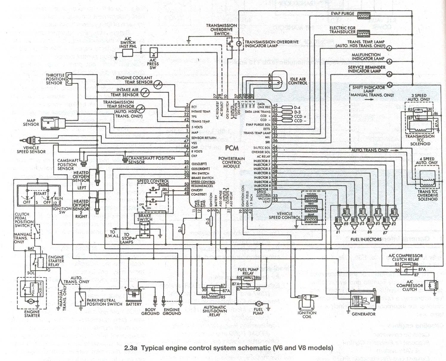

Putting a 6.4 in a 71 challenger. Got a crate motor from dodge a stock wiring harness and ecm. There is no dedicated tach wire. So how do you connect a tach. I have a new auto meter tach.
Don't know if this is a help. 2012 diagram. 19 bottom right. You might need a tach adaptor. Different signal?
I went and did more research. I have a auto meter tach and they have some adapters. But it looks like wire 19 in the schematic maybe I connection point. I am checking with there tech support tomorrow.

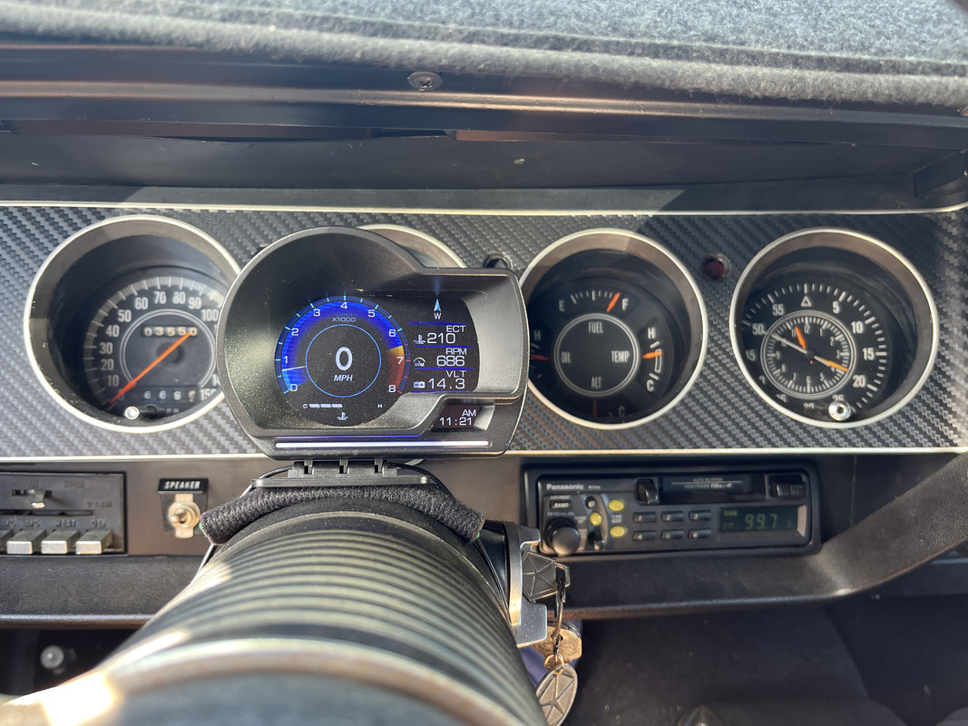

At the moment I have an ODB2 tach zip tied to steering column, works great, but would be nicer inside the factory spot.
I would however lose the other functions, voltage, temp, clock, error codes etc.
It would be perfect if round, but has weird shape.
