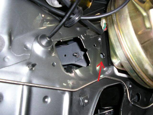

This is where the tach wire comes through the firewall. The wire is gray with a black tracer.

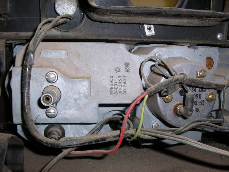

Here is the back of the tach. There are only 2 connections. The gray tach wire has a female spade connector and the blue wire has a rubber L.

Thanks, that's exactly the information I was looking for. The ground connection must go through the tachometer body to the instrument cluster. I see how the two wiring posts are insulated from the body with fiber washers.
I am surprised that the gray with bk tracer appears to go through the harness since it gets it's own hole through the firewall. If I can't find the wire through the firewall, I will run another wire from the negative side of the coil to the gray/bk wire and see what I have.
