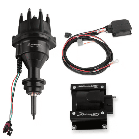

  • Buy the whole package as it's designed to work that way - ECU, ignition box/distributor, in-tank fuel pump, etc. That means don't cheap out on certain components (especially the ignition) as you will never achieve the full potential of the system.

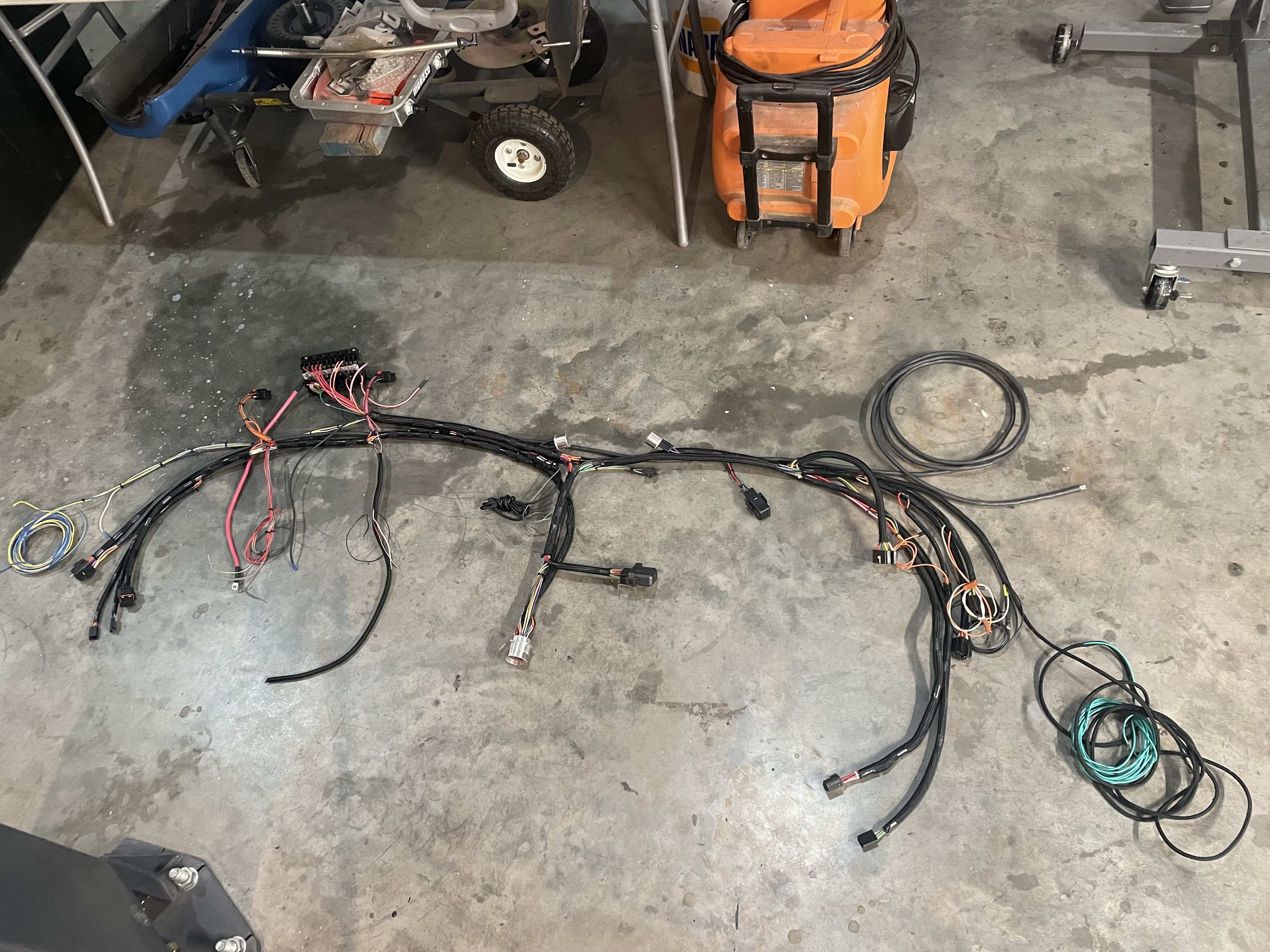

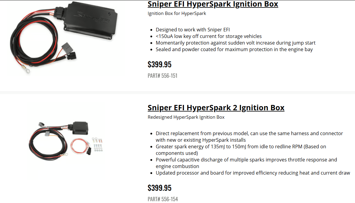

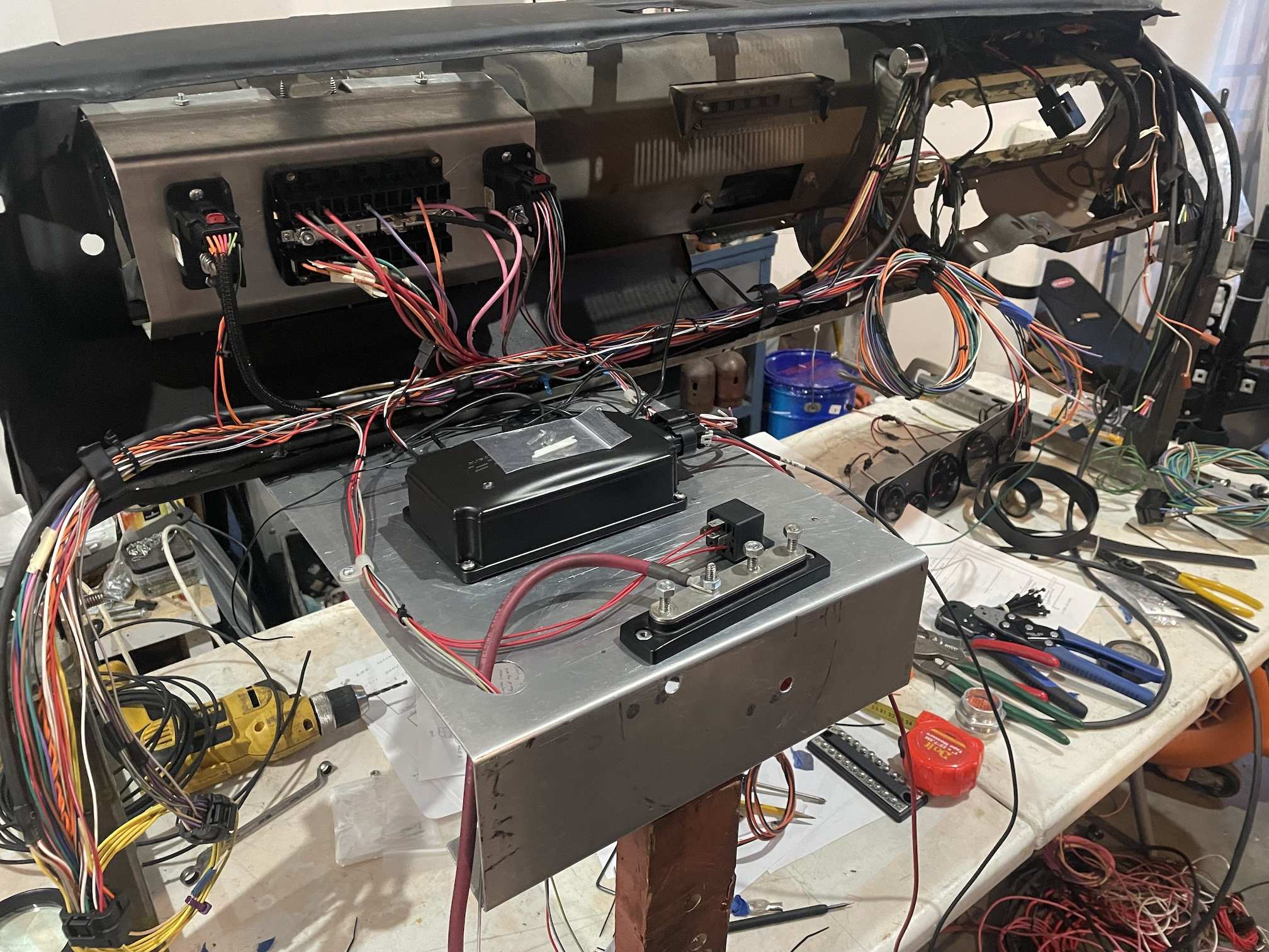

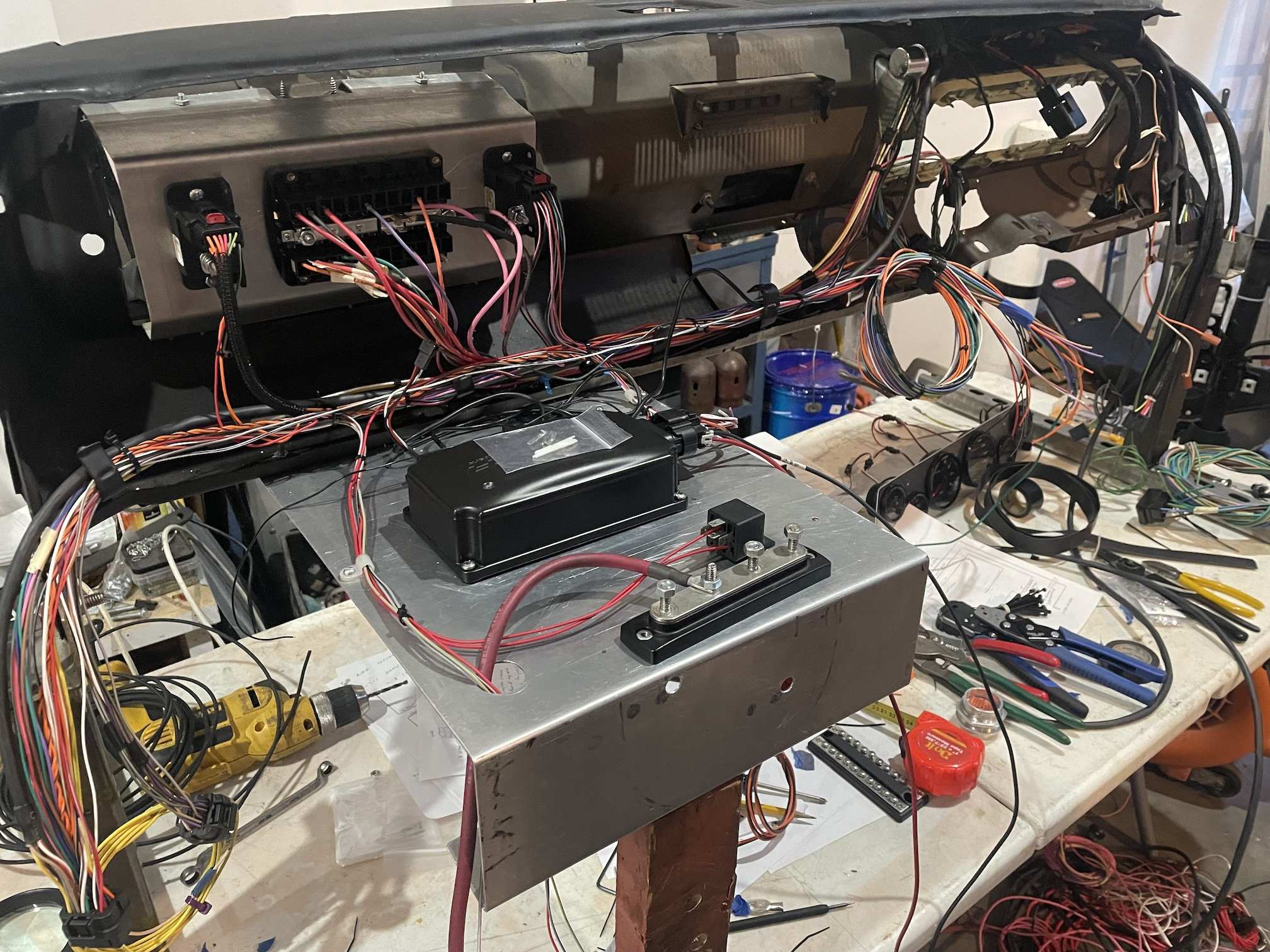

The Holley Sniper systems can do almost anything you want but I would not buy a system with the ECU in the throttle body. The Terminator X Stealth system, as noted by @rmchrgr has a separate ECU which can be installed in the interior of the car. The harness is long enough to locate your ECU and the Hyperspark 2 ignition box inside the car. I installed my ECU under the driver side dash under the cowl area and the ignition box on the lower firewall at the center of the transmission tunnel. Here is a good article from 2017 on the Terminator X Stealth system.

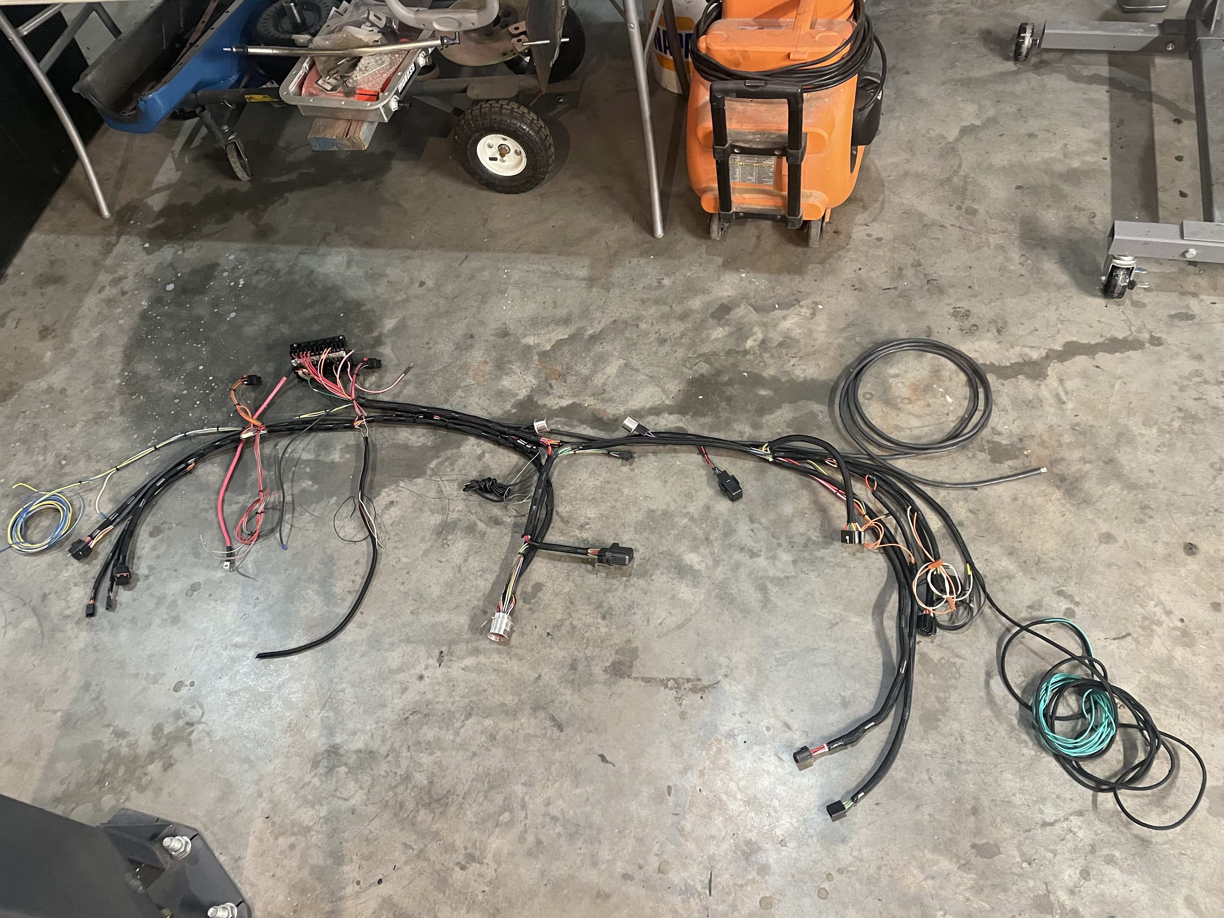

Electrical System - Upgrade to at least a 100-Amp alternator (Powermaster one-wire with internal regulator) and the Holley power module (these are a newer development and solve lots of power issues). All wiring should be properly thought out and routed accordingly. Buy the proper size loom coverings and make it look professional. You need to get this done properly the first time around as you will never make time to redo it.
