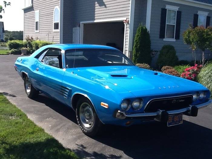

Welcome from Little Rock! Super nice ride. And love that color!
I think any mopar shifter with the two hole mount will work fine for the Tremec stub. Silversport can verify that though.
Greetings Little Rock! Enjoyed visits to your city in the early 2000s. Good folk and the best food!! Thanks for the compliments and I'll give Silversport a call. You know Petty was my racing hero in the early/mid 60's. Years later when this car showed up at the Dodge dealership - I HAD to have it! Car payment was a whopping $89/month for 36 months. Yikes. :)

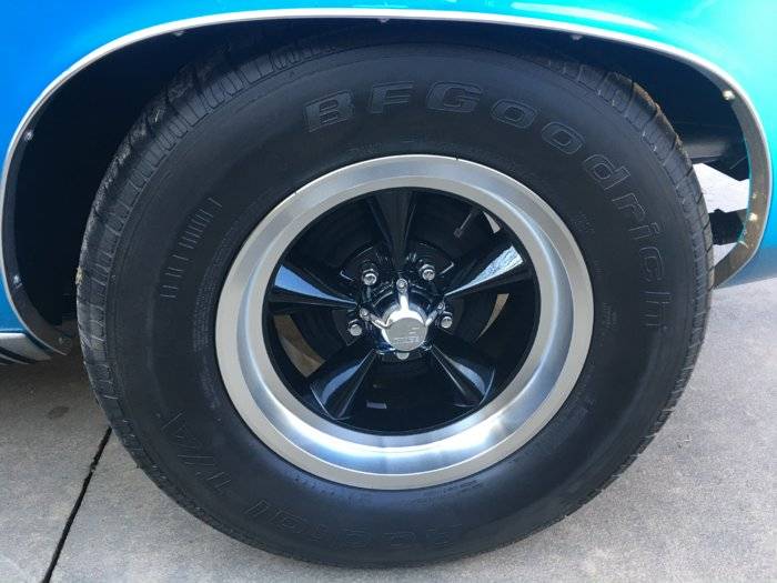

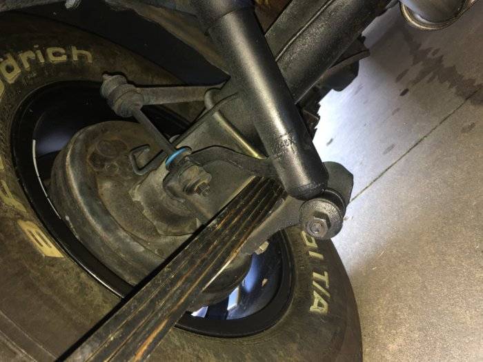

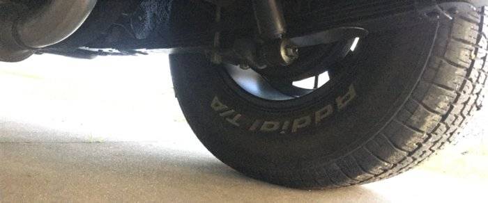

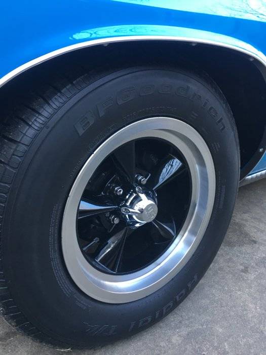

Thanks DW. The rear's are 275/60/15 fronts are 215/70/15 BFG radial t/a's on 15x7 ralley wheels with white letters out. Same size and brand tire on the black US racing wheels except, the black wheels are 15x8 rear and 15x7 front. The car has MP super stock leaf springs and BB/hemi torsion bars. Napa shocks all corners ( no air shocks) These E bodies seem to have a natural (little lower) stance in the rear. The leaf springs I use probably gave it an inch or so lift in the back, not sure exactly. Another thing is that mine could be a little lower in the front as well. My cuda came with 14 inch wheels as well. Just a little small for my liking.
also, you'll see on the site that guys are using several different size wheels and tires. My rear tires are very close to the lip on the quarter panel but, they don't rub at all.

HEY DW, let me verify the leaf springs that are on my car by part number. It's been so long ago I'm not so sure they are just heavy duty springs and not SS.
I'll look this weekend and send you a message.

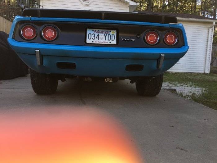

Fasjac, is it possible while you’re at it - to take a pix of the rear of your car from ground level? Showing the rear tires. The pix you have up now doesn’t show the rear tires much. Whatever you can do is greatly appreciated! I hope to return the favor someway/somehow! DW
