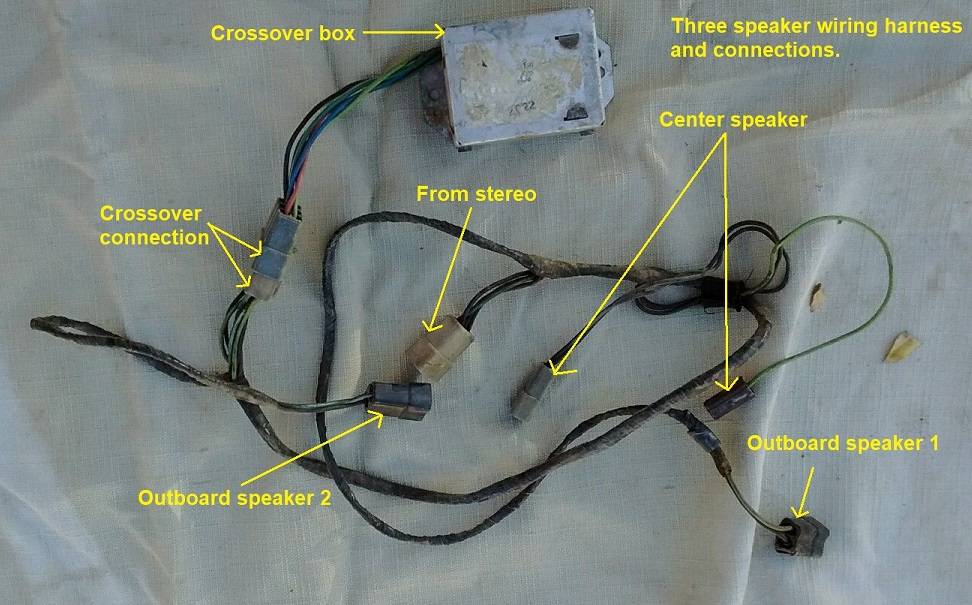

The factory used a special wiring harness and a "crossoverbox". I doubt it can't be properly done with an AM radio. Who knows, you might even have the wiring in your car already and those crossover boxes are on eBay. I did this conversion on my car and quite frankly can't remember if the harness was already there or not. I do remember having to find the crossover box and a factory AM/FM.

Thanks for that info it's very helpful in my planning. I was sick all last week so New Year's day is the first day I could work on the cuda again. I'm dropping the back axle and springs today.

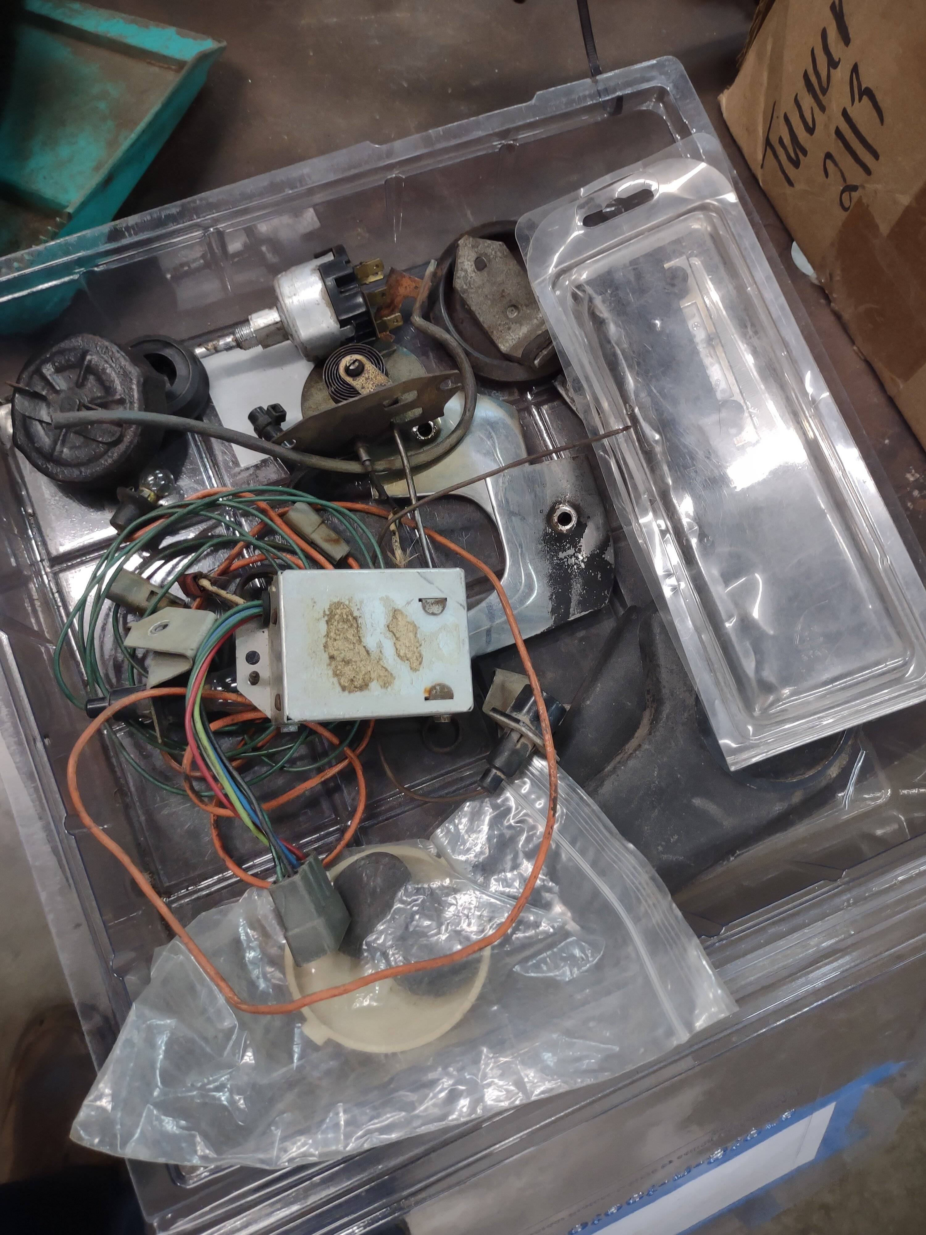

In a random box of parts I picked up recently. The crossover. I guess I still have to find a wiring harness or make one up

Good score. Cross your fingers you have that harness under dash. FWIW, last time I looked on eBay that wiring was available.
