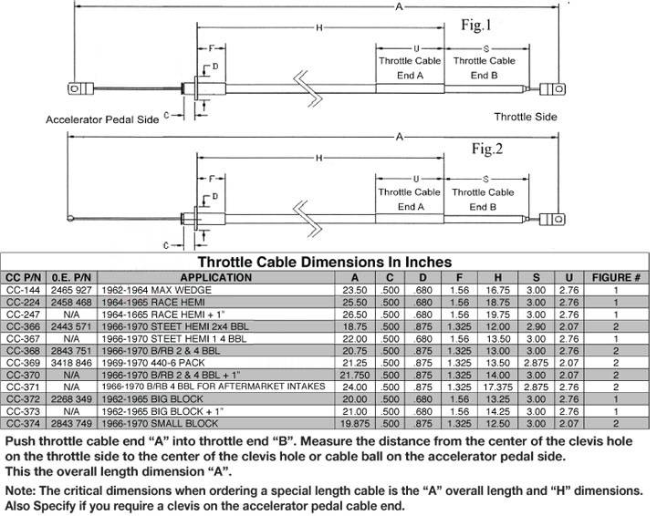

Hi Everyone- I have been struggling to find an answer for the throttle cable length for my 70 challenger. I have a 318 2 barrel carter and heard the 4 barrel cable is different. I want to run the 2 barrel and the one on the challenger is for a 4 barrel I think. Any help would be great!

This chart may help determine what you need for your application. It does not show a difference in the Small Block 2 or 4 BBL cable. Just one part number for either carb. There are lots of dimensions to verify before purchasing anything.
I used some other information which showed Pioneer part numbers (CA-####) that corresponded to the cables in the chart and made a spreadsheet.
I have only verified the two CA- numbers in Bold as compatible.

CC-1442465 092762-64 MAX WEDGE23.500.5000.6801.5616.753.002.763.751
CC-2242458 46864-65 RACE HEMI25.500.5000.6801.5618.753.002.763.751
CC-247N/A64-65 RACE HEMI + 1"26.500.5000.6801.5619.753.002.763.751
CC-3662443 57166-70 STREET HEMI 2x4BBL18.750.5000.8751.32512.002.902.073.752
CC-367N/A66-70 STREET HEMI 1x4BBL22.000.5000.6801.5613.503.002.765.501
CC-3682843 75166-70 B/RB 2BBL & 4BBLCA8420SQUARE20.750.5000.8751.32513.003.002.765.502
CC-3693418 84669-70 440-6CA8411SQUARE21.250.5000.8751.32513.503.002.074.752
CC-370N/A66-70 B/RB 2BBL & 4BBL + 1"21.750.5000.8751.32514.002.8752.074.752
CC-371N/A66-70 B/RB 4BBL Aftermarket Intakes24.000.5000.8751.32517.3752.8752.763.752
CC-3722268 34962-65 BIG BLOCK20.000.5000.6801.5613.253.002.763.751
CC-373N/A62-65 BIG BLOCK + 1"21.000.5000.6801.5614.253.002.763.751
CC-3742843 74966-70 SMALL BLOCKCA8414SQUARE19.8750.5000.8751.32512.503.002.073.752
Part Number:Cables with SQUARE PLASTIC firewall fittingApproximately
Part Number: PIO-CA-8414CA-8414SQUARE~19.7”
CA-8422SQUARE~20”
CA-8416SQUARE20.3”
PIO-CA-8420CA-8420SQUARE~20.8”
CA-8411SQUARE21.25”
CA-8413SQUARE25.8”
CA-8412SQUARE26.1”
