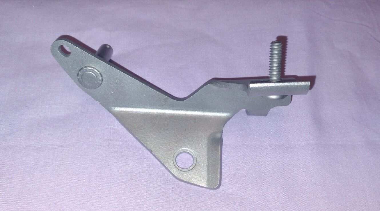

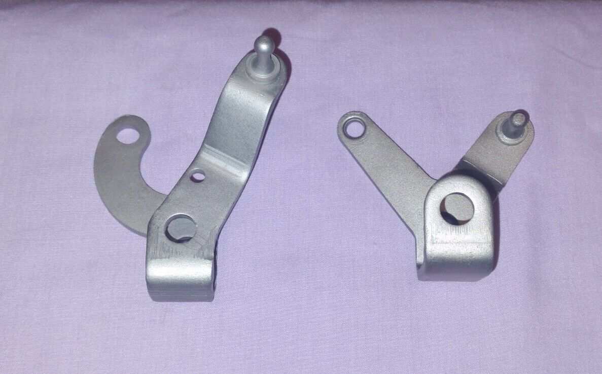

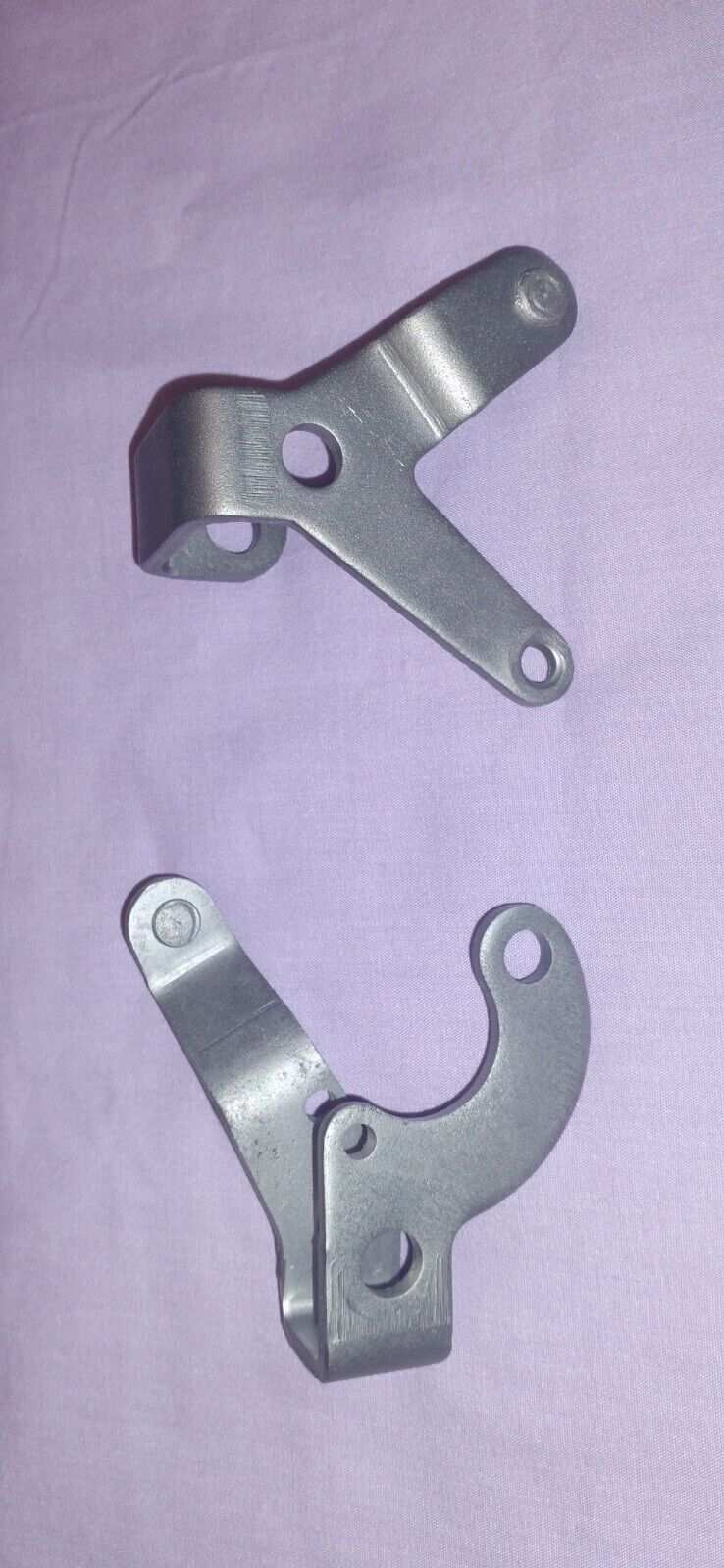

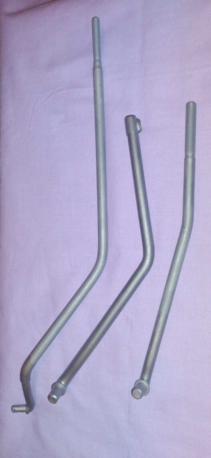

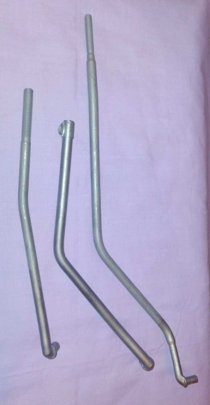

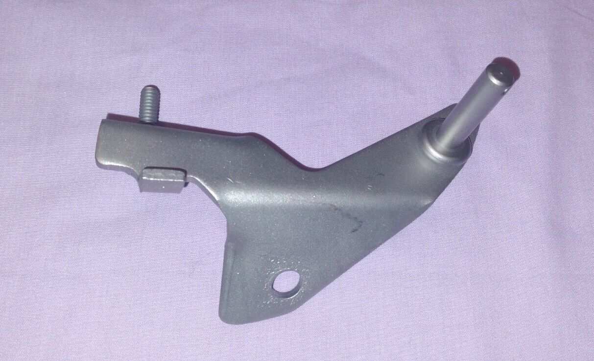

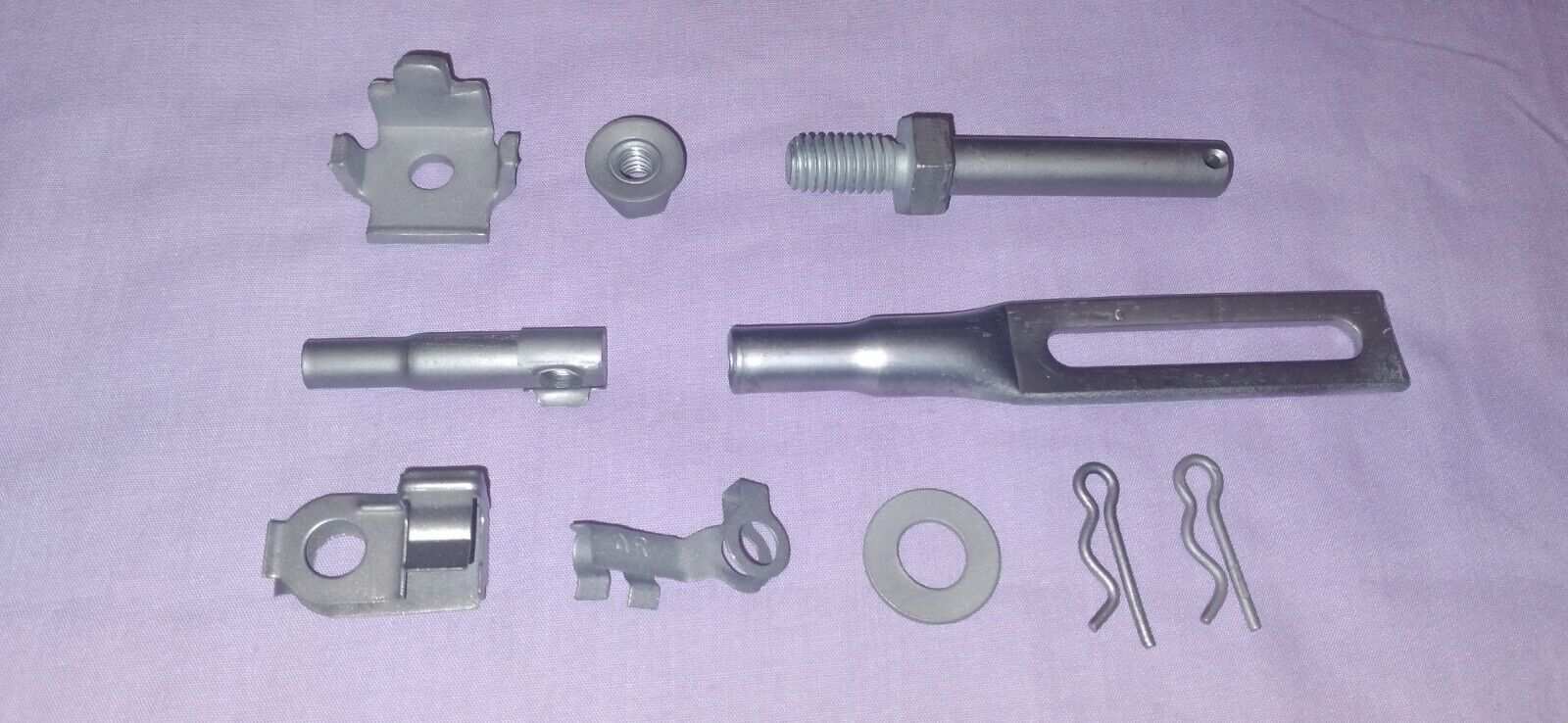

Hi, and I hope you're doing well.
I purchased a refinished set of throttle kickdown linkage from ebay for a '70 383 4 barrel/'68 727 trans combo. The engine and trans will eventually go into my '72 'cuda. My understanding is that the throttle linkage is for a B body and is complete.
I believe that the 727 is out of a '68 Charger. I'm not exactly sure originally where the 383 came from, yet it is a '70 engine.
I've included some photos for reference.
My questions: Will the linkage set in the attached photo work for my engine/trans configuration, and are all the parts in the photos correct for a 4 barrel 383/727 68-71? (Do the B body and E body interchange or do I need a new set? I was told today that the bracket in the photos is not correct for a 4 barrel and only works for a 2 barrel.)
Any and all help is welcome and greatly appreciated.

It looks correct to me. Yes, B-Body and E-Body kinkdown linkage is interchangeable. See photo from the E-Body Restoration Guide. It's for cruise control, but the linkage and bracket looks correct.

Update: Turns out, I've been informed that the first rod (which connects to the carb link) in the photos above is for a 2 barrel carb not for a 4 barrel carb. Additionally, the throttle bracket is correct for 66-67, but may work for other years. I'll update this thread with photos and info when I receive the correct rod and bracket.

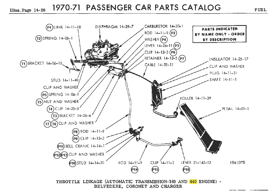

This topic can be really frustrating when you don't have a "correct example car" from which to compare yours to and learn from.
Many of the linkage parts between the 383 and 440 (4-barrel) configurations are interchangeable. Some exceptions are:
(image from a 1970 Parts Catalog for reference)
Rod 14-11-9 (P2) is a different part number between 2 and 4 barrel setups. This confirms it's likely a different part. The 4-barrel rod has to reach further than the 2-barrel rod.
Bracket 14-26-6 (T3) is also different (part numbers) between 383-2, 383-4 and 440-4 setups. The upper tab-portion of this bracket - where the throttle cable affixes and containing the threaded post - is longer (further medial) on the 383-2 bracket than the 383-4 bracket. The angle in the bends of the bracket vary between 383 and 440 setups. When bolted into place, the correct bracket places the post (on which Lever 14-26-11 P3 rotates) horizontally.
Rod 14-11-9 (P8) is different between 383 and 440 setups (440 is longer) but the same between all 383 configurations.
In terms of hook-up locations, the 727 transmission did not vary much between 1967 and 1974, so you won't have to adjust for this tranny being a 1967.
I have some of these parts and can take measurements, if there is need. Once you start bolting yours on, and adjusting it to the FSM, it will become evident of any of the parts are wrong.
