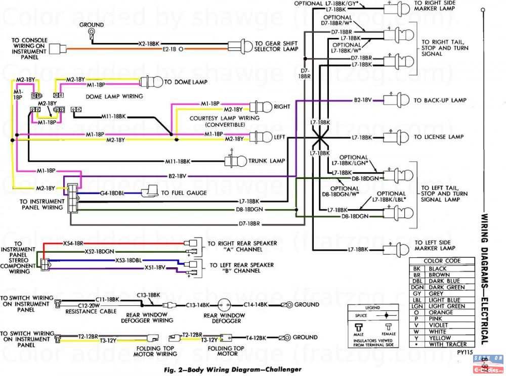

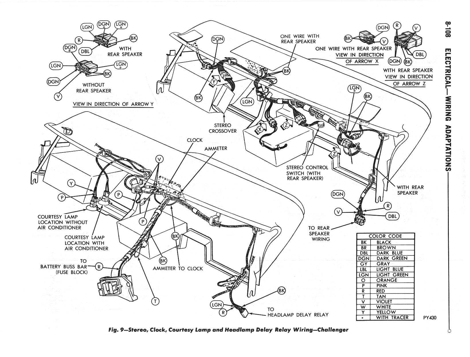

They have graphs printed out
If you saying they have a wiring diagram. The one I posted is it. Unless someone installed an aftermarket wring harness. If you have a Dakota gauge cluster I'm not an expert on that but I'm sure some one here is.

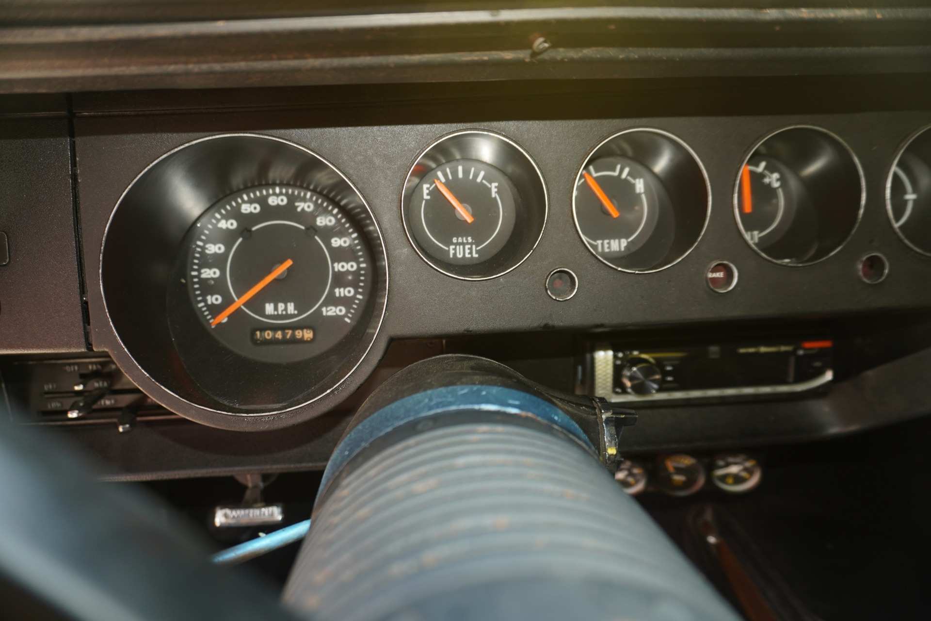

View attachment 130538This is the only pic I can get of the stereo and the cluster under the stereo .
That is a standard cluster should not be a problem. aftermarket stereo could be a problem with bad connections. I also see a set of under dash gauges and if there are loose wires or installed wrong could be a problem. The wires you moved up that were hanging down might have been them and caused the problem.
