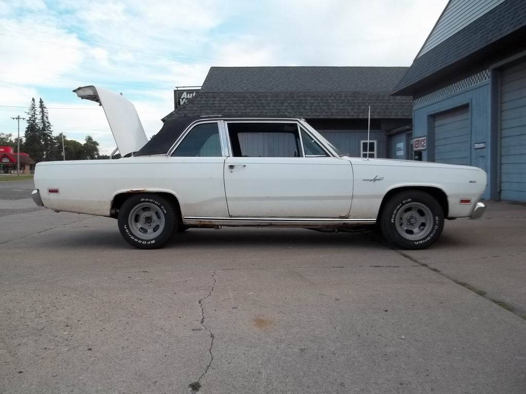

These are P235/60R-14s (25.1" overall height), F/R on my '69 Valiant, with much smaller wheel openings than an E-body:

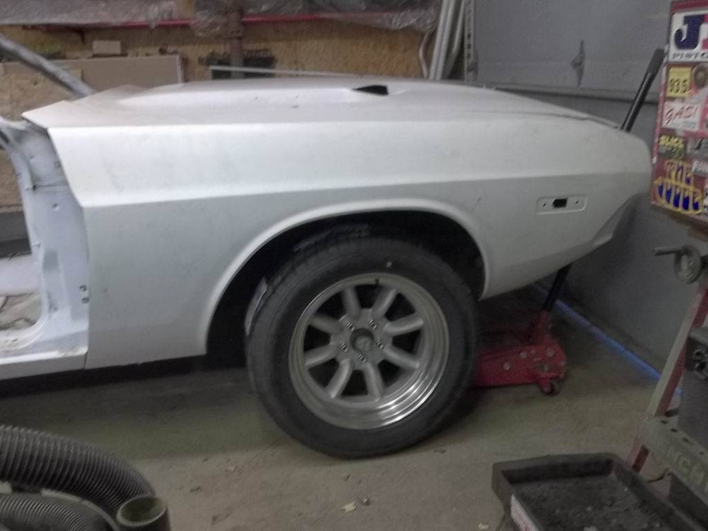

For comparison, here's a P255/50R-17 (27.0" overall height) on my '74 Challenger project:
The fender was just hung there temporarily, not aligned, so the wheel's not centered. Regardless, I think losing 2" of overall wheel/tire height would really detract from the look.

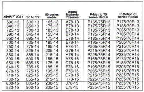

In the end you must have at least the same load capacity as the original sized tire. A tire is really just a bladder filled with air. Like a balloon. The volume of air not the shape of the balloon determines how much load it will carry. Push down on the top of a balloon and it will get shorter But it will also get wider. Same volume, different shape. So in tire sizing ( the old way before metric sizing) An "F" series tires regardless of profile indicated the load of the tire eg..That is why there are books/charts called load and inflation charts.
I will attach a dew charts and the page of oe sized tires for the E-body with various sizes for each engine size. Use the charts to find your factory recommended size. Find its olad capacity and the cross reference the other sizes that will safely work. Have fun.
