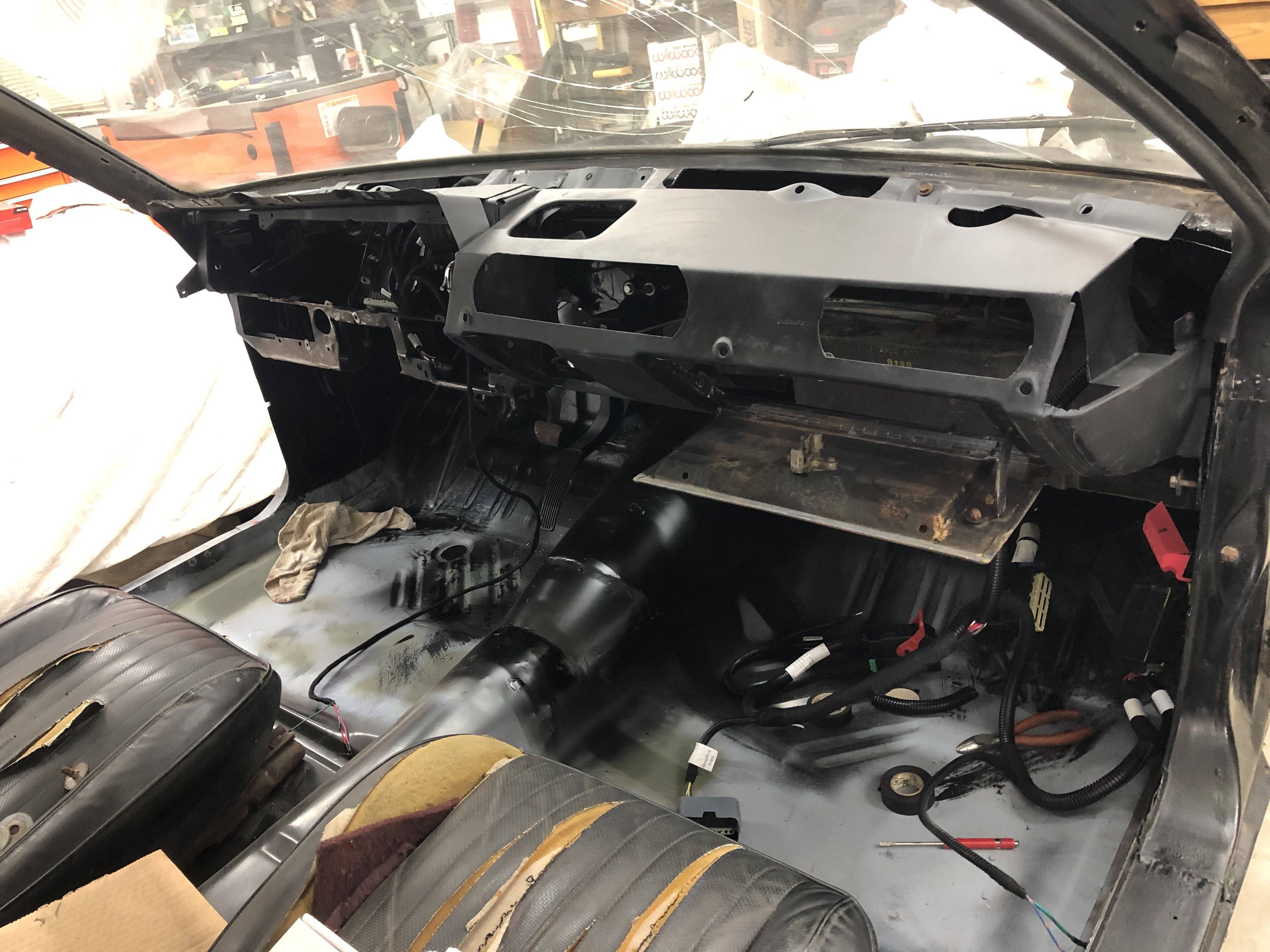

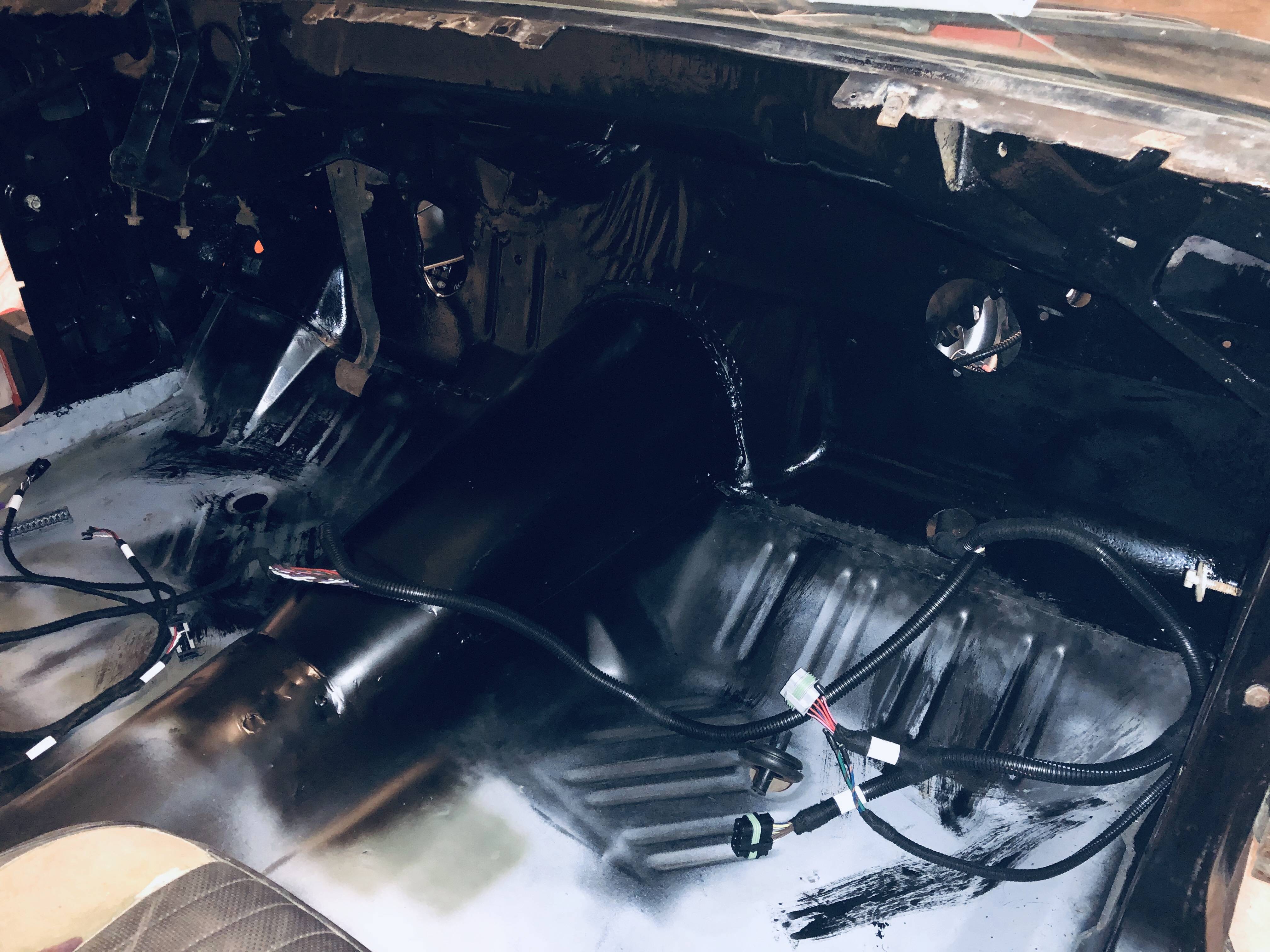

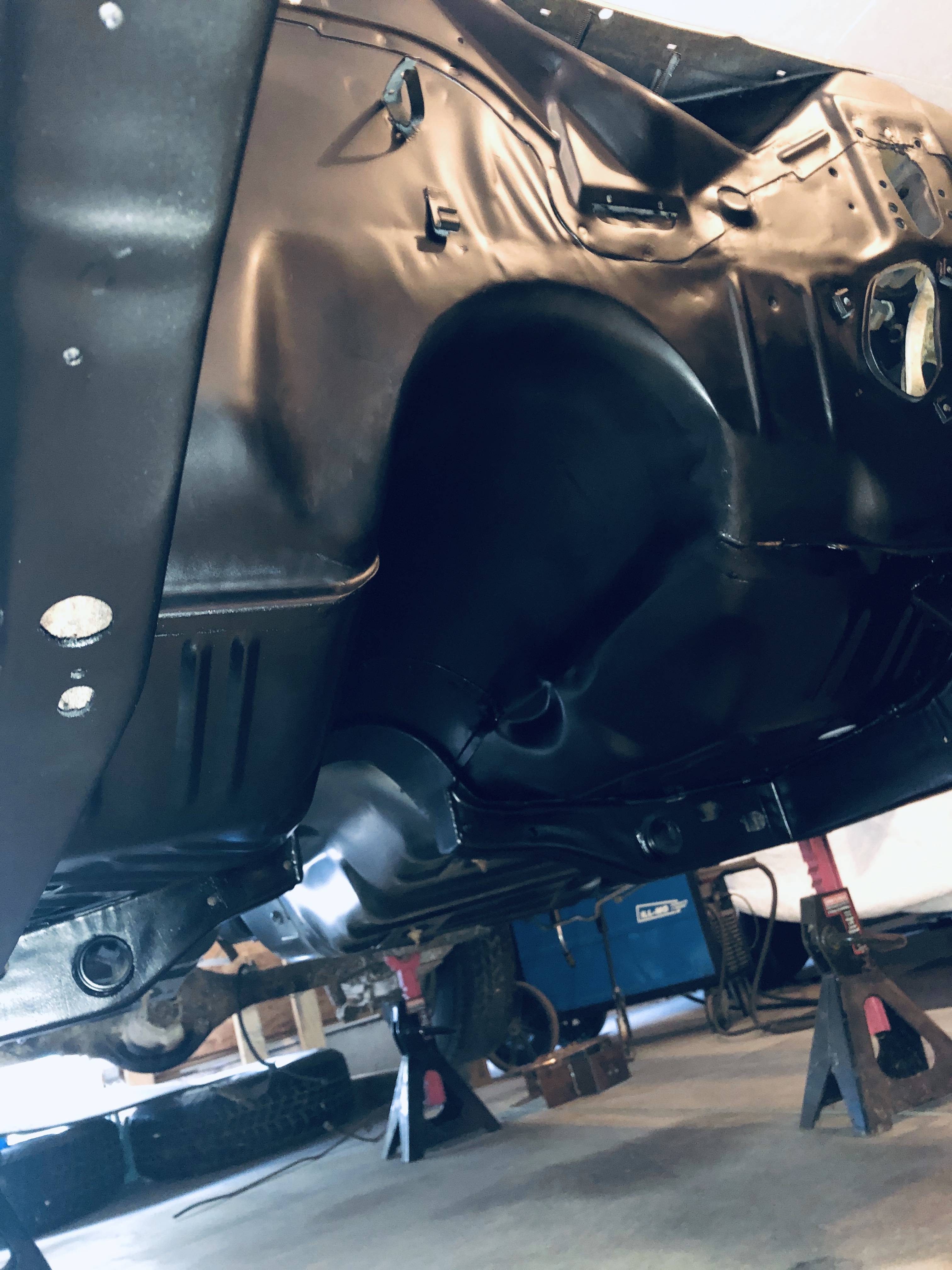

Couple of pictures of my trans tunnel on my 73 cuda incase you wanted some idea or reference points.
