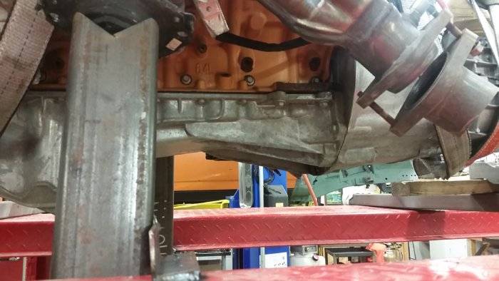

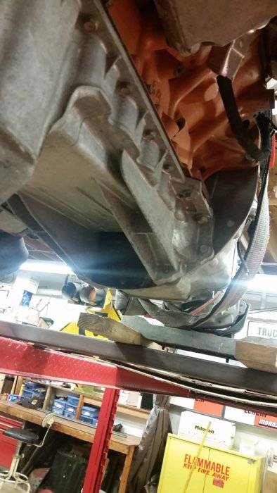

Im installing a 6.4 with the TR6060 into a 70 Mopar. Ok....nothing new here....but like all other transplants of this type I have to install the mid sump oil pan, Nothing new there either.....BUT....what have other people done about the dust cover needed in front of the Trans (TR6060) that is missing when you take the factory oil pan off the engine. AND ….has anyone considered the structural support needed to be installed between the TR6060 and the block...…...That was removed when the factory oil pan was removed? see pics...
