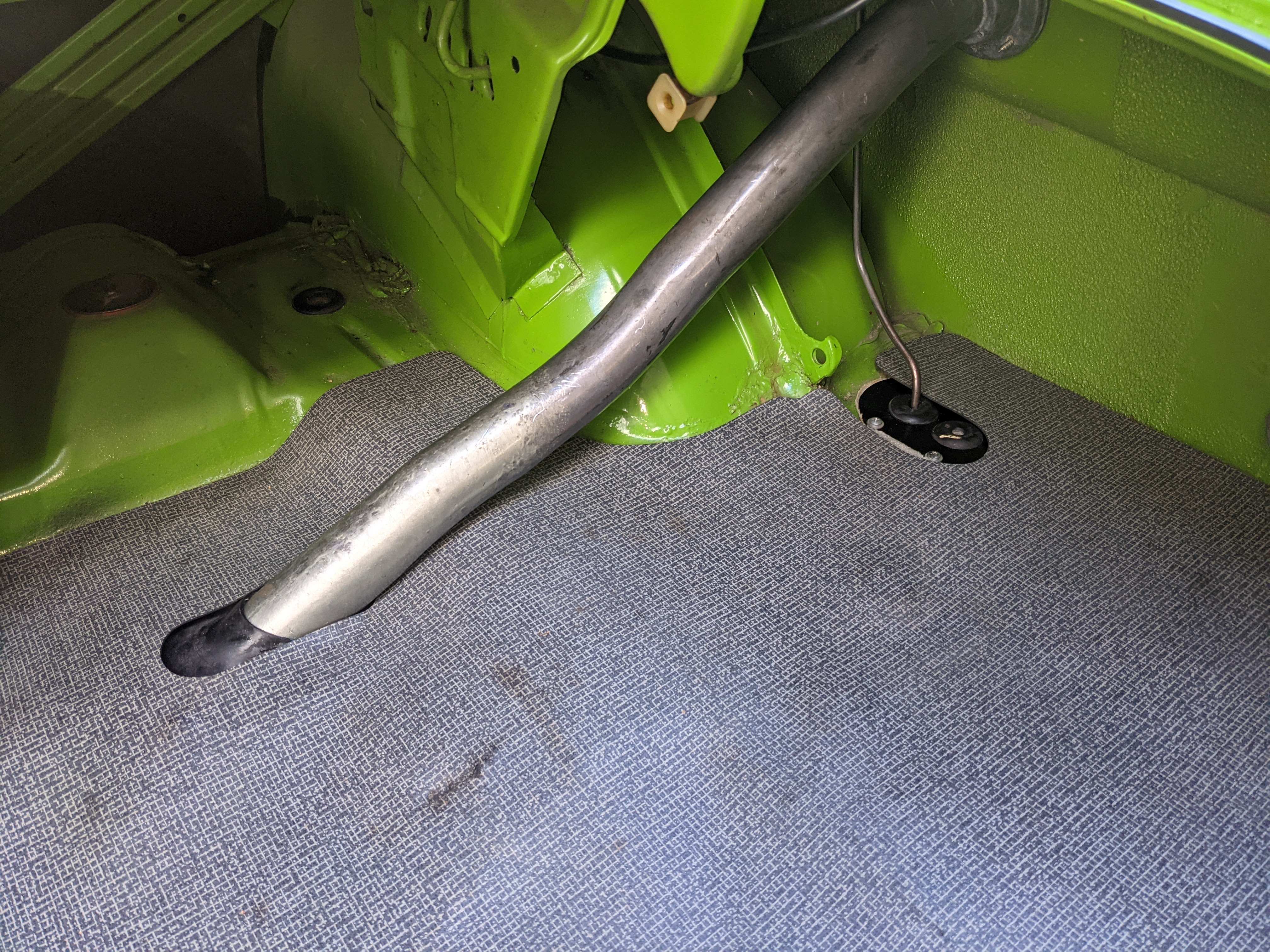

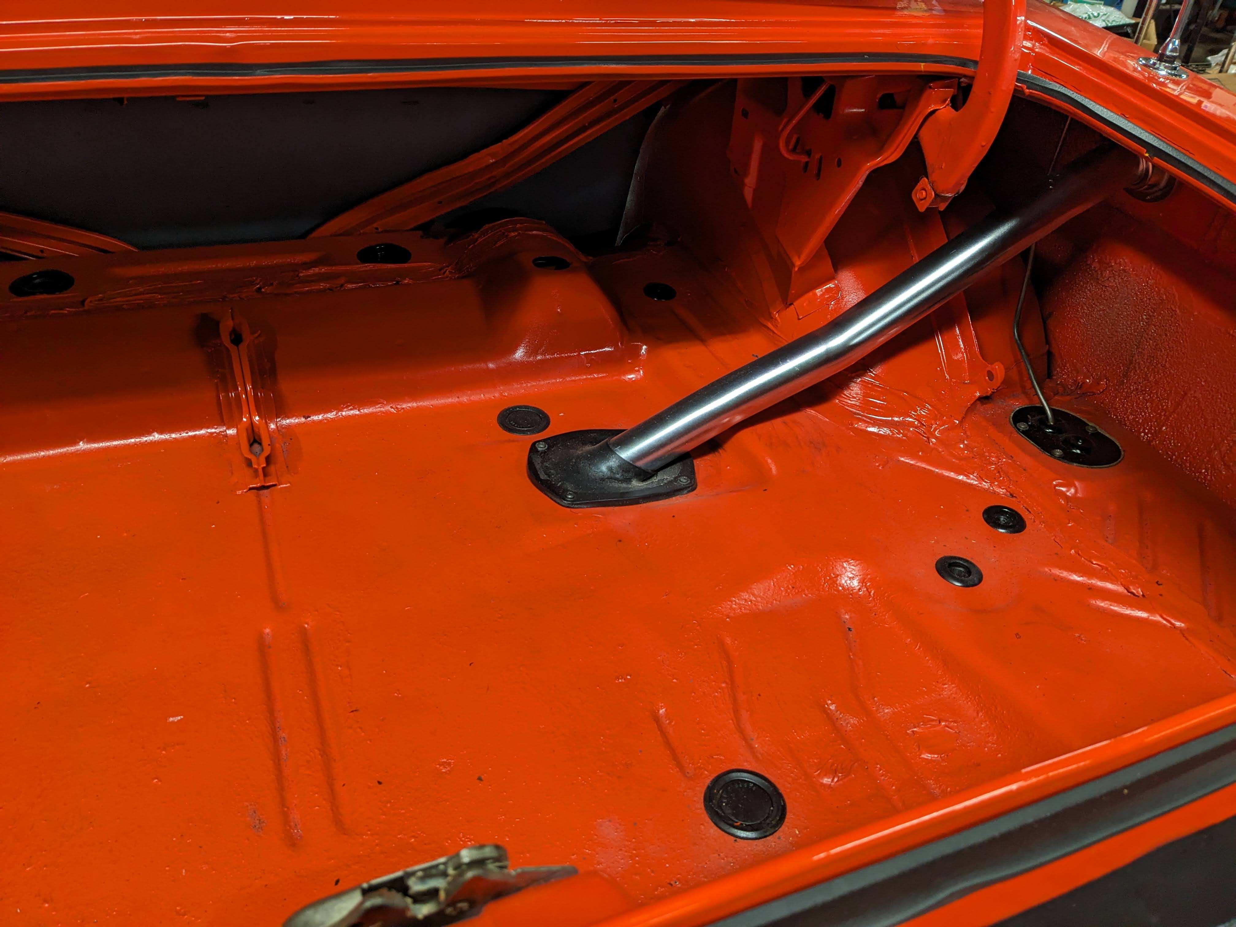

i did find that the trunk floor is body color
is the inside quarter panel undercoating sprayed over with body color
do the wheel wells get the sprayed body color undercoating
would bed liner work instead of undercoating
Yes, the inner panel coating is sprayed with body color. Both of the following in my Challengers have been repainted, but the coating is original.

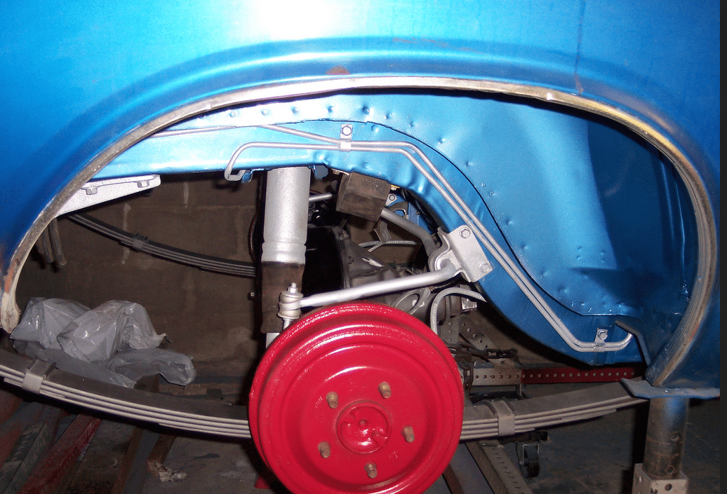

The wheel wells are not sprayed with coating other than possible overspray. The wells are body color.
Yes, although the texture will not exactly match but with effort can resemble original texture.

The info above is good. To add to it When I was in preservation mode, I got a little carried away. The rear wheels. I painted them and Later coated with KBS Diamond clear coat. The front I came to the concussion to apply truck bed liner. The reason I did so, was that I read that it helps with preventing stone dings to the fenders from the tires.
I noticed a small stone ding on one of my front fenders. Since the paint was new, and clean, I applied Dyna mat to the underside of the top faces of the fenders.
