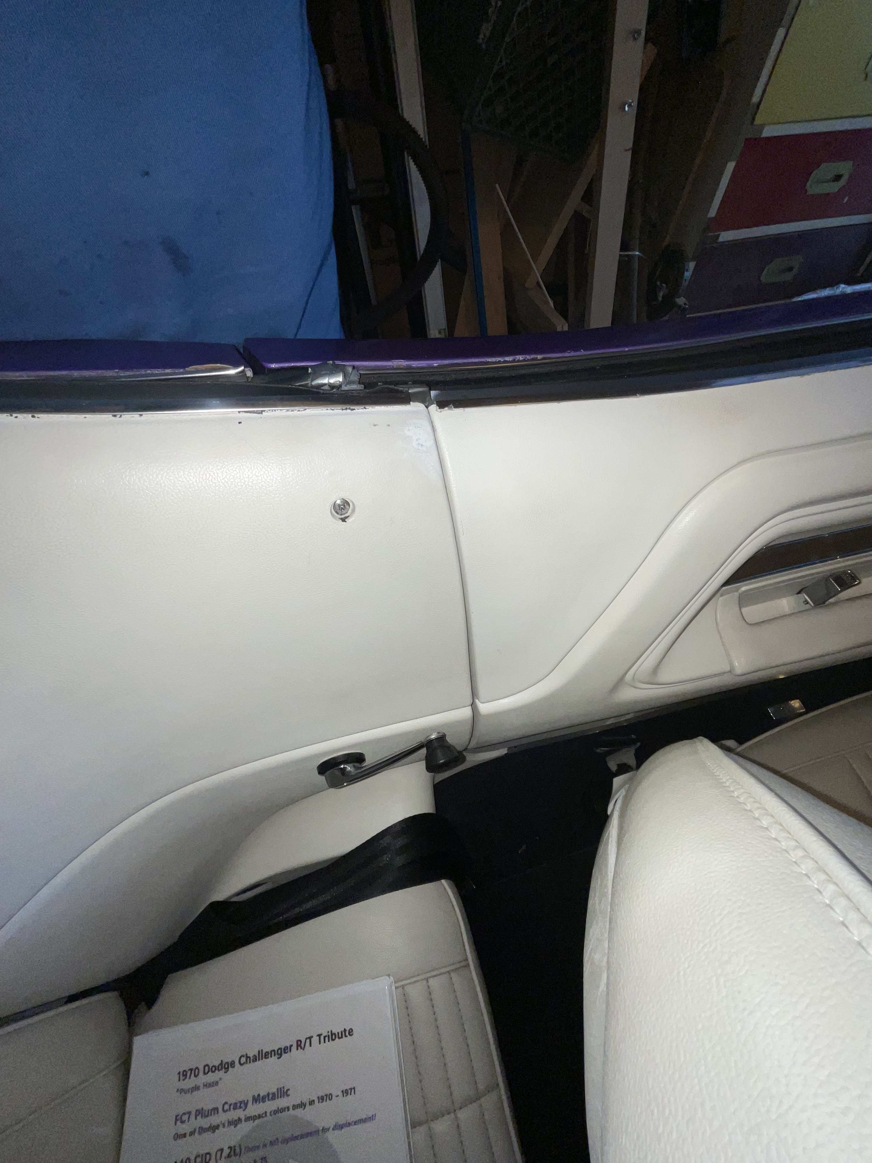

1970 Challenger convertible. Rear panels were originally black and have been sprayed white. They do not match the door panels so I want to clean them up and respray. New panels are $1,024 for the pair - not worth it for this car, especially because the panels are otherwise in good shape.
I can not find 1970 white interior paint. Classic has 1969 white, but not 1970. Anyone know if it is the same? Or, where I can get the 1970 white?
Last resort is to take them to a body shop and get them color matched and sprayed.

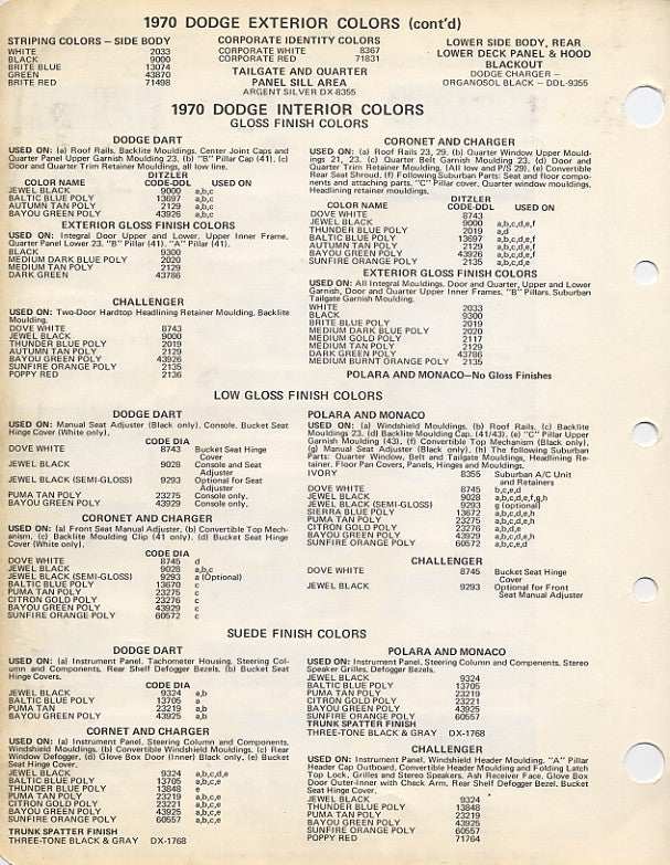

Looking at the chart found in the shop manual, the white used on some of the metal interior pieces in '70 was apparently known as Dove White. You could likely have that 8745 number mixed up in a SEM vinyl dye and at least you'd have something that was found elsewhere in the interior originally. My brother did this with his 70 green interior and the results were good.
