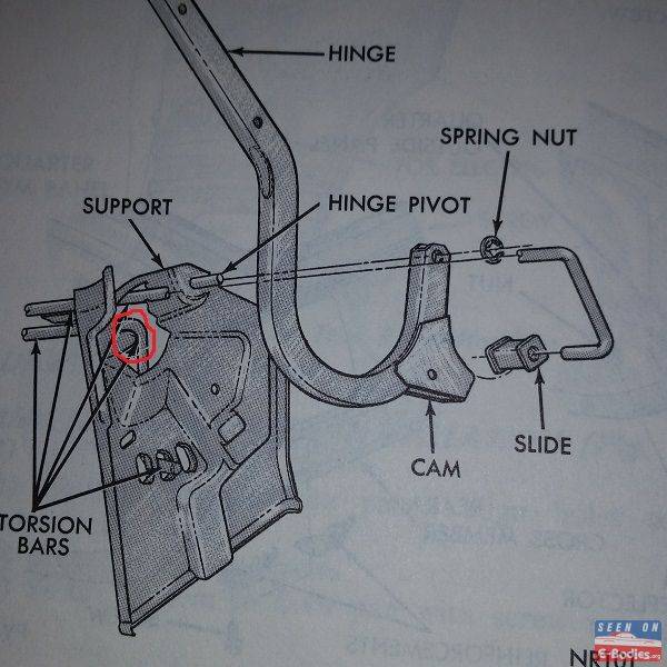

If the trunk spring is installed correctly, and not bent, I would have a look at the trunk hinge pin retainer to make sure it is there. It looks like a large push-nut (AMD sells them). You could also put a push nut on the end of the spring to hold the slider on. I use a little Vaseline on my slider/hinge arm.
Photo courtesy of the Web.
There's a tab under the dutchman panel, in the center, that holds the torsion rods in place. Maybe that's broken, missing or not folded over the bars.
Finally figured it out. the bottom of the hinge where the slider slides was badly worn after years of use had to bend the lower edge to keep it from popping off. THANKS for all the input and help.
