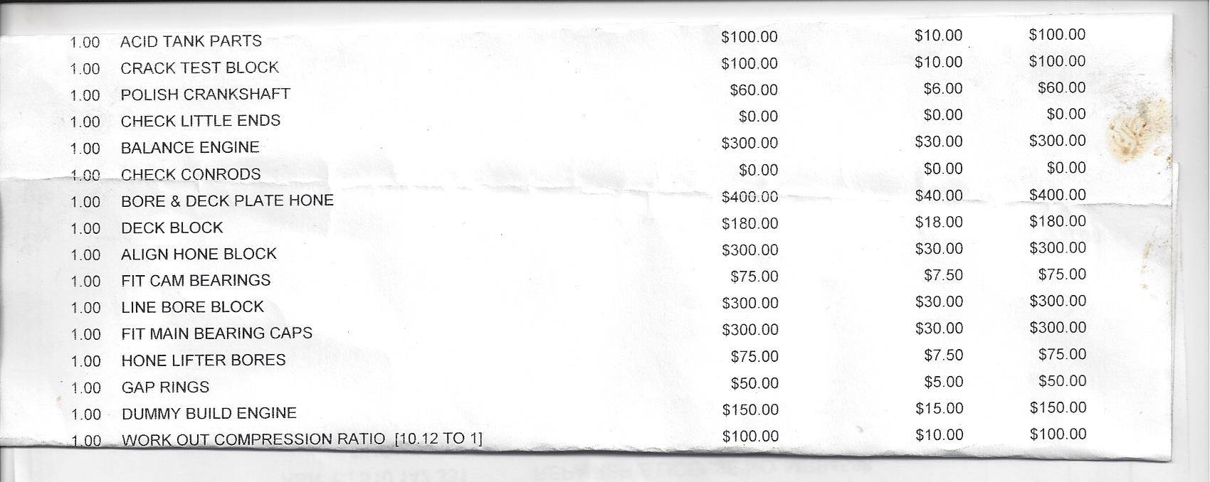

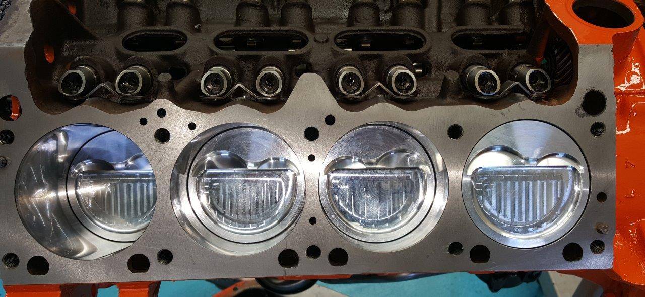

This is what we pay in Australia for performance 340 3.79 stroker includes drilling all the oil galleries & fitting the 4 bolt mains
JE custom pistons were around $1400 Aud
They do Zaps Rat plus most of the other door slammers in WA
