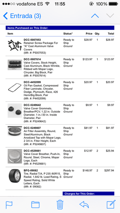

I purchase at Summit this parts from Mopar Performance:

The retainer screw package you bought says for "A" covers. Did you get the correct ones for your big block "B" motor?

Thank you moparlee. Ops then I have a mistake in the purchase :(
I cannt find in summit the right ones, can you help me with my B bolts??

Shut.........I looked at the Summit listing. It says the bolts are for various applications so they should be ok for the B valve covers. It has 12 bolts which is what you need.

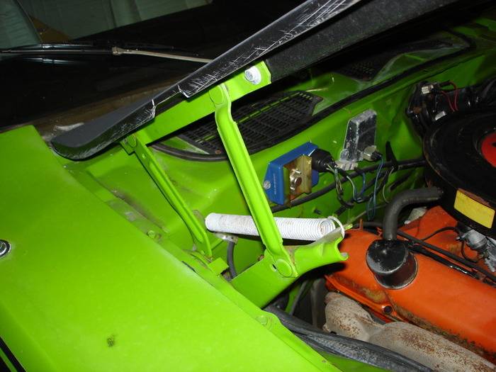

For Gods sake man.... paint that hood spring !!! :D
