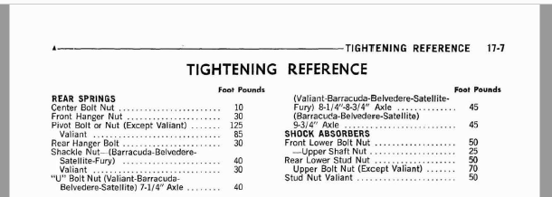

Upper rear shocks bolt&nut torque specs
Right there in the manual we can all freely download. 70 ft-lb which is on the higher side.
