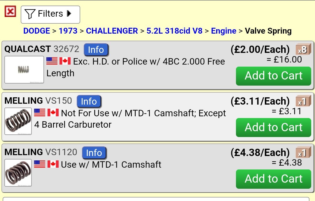

Hi all, help again please.
My car is a 318 stock (as far as I know).
Originally 2 barrel, now 4.
I believe I finally managed to track the ticking issue to a weak spring (I car turn it by hand and the rocker has some movement)
(Lifters are new, all rods were checked and are all same height and not bent)

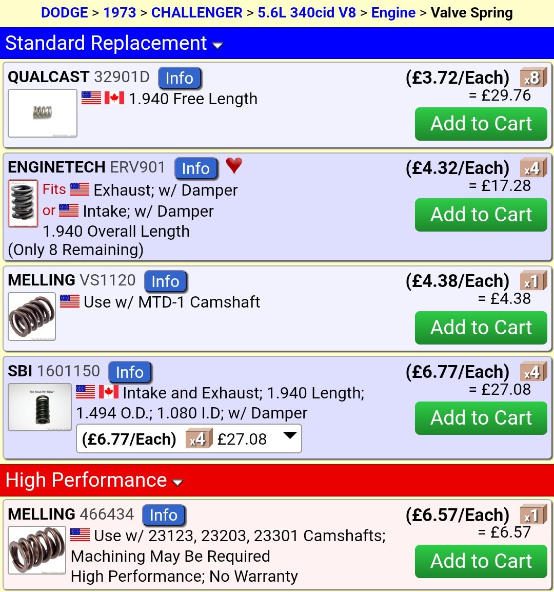

Anyway, which one of the following options should I order?

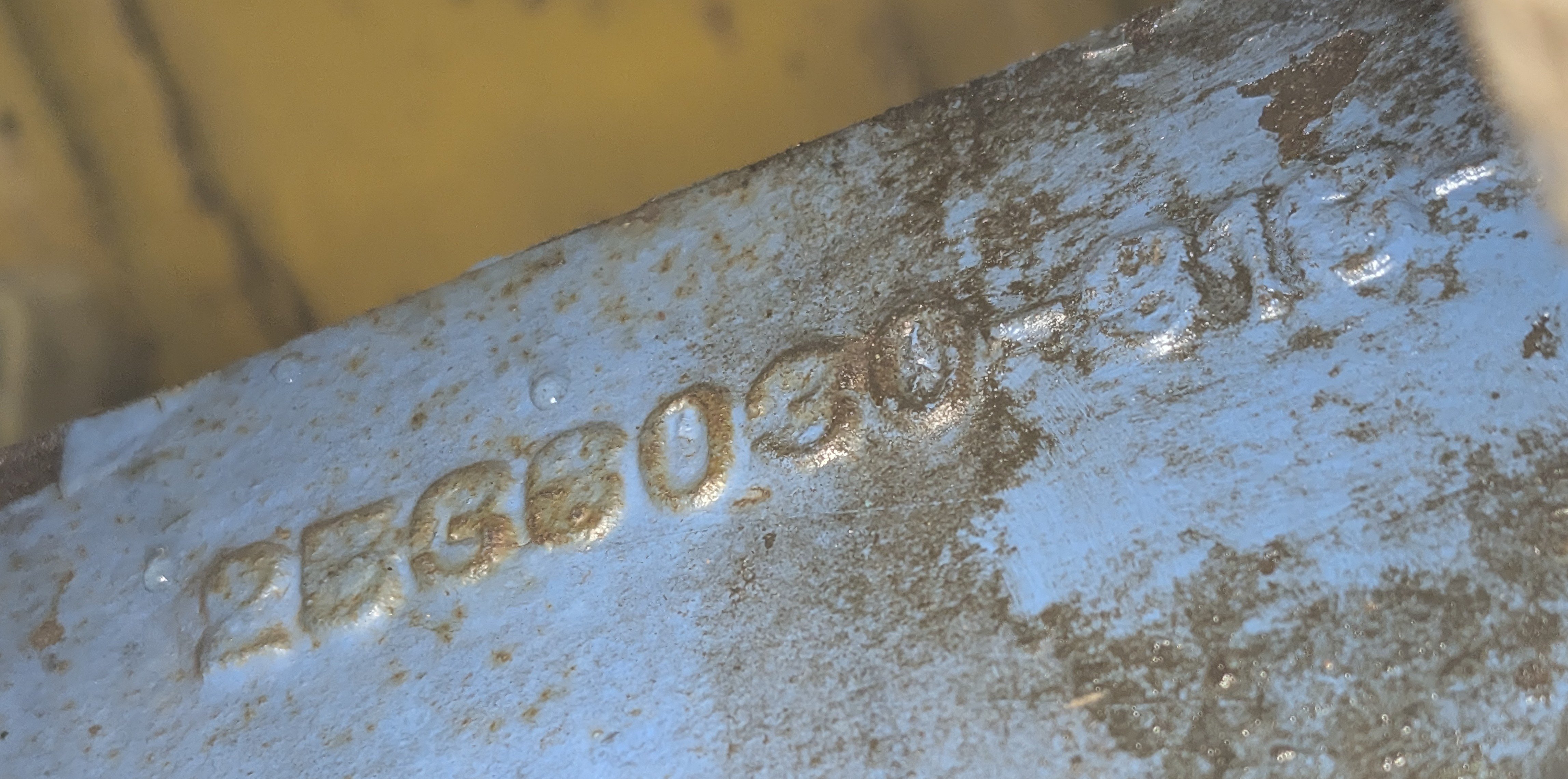

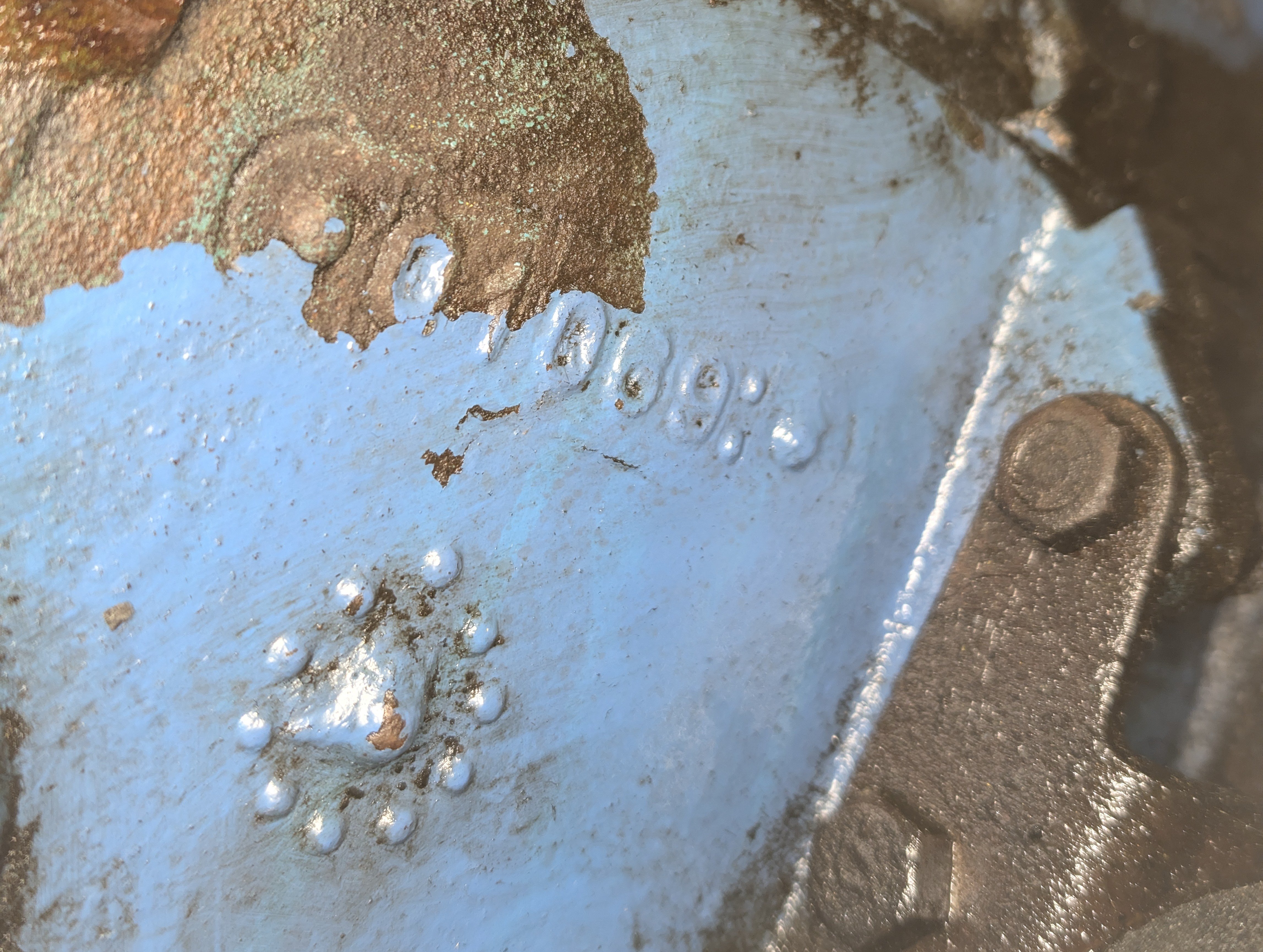

I'm attaching pics of the block info as well.
Thank you.
Melling VS150 or Qualcast 32672 are very close to the factory stock 318 springs. Are you planning to change just the one spring?
If it were me, I'd order a full set of 16 springs and replace them all.
