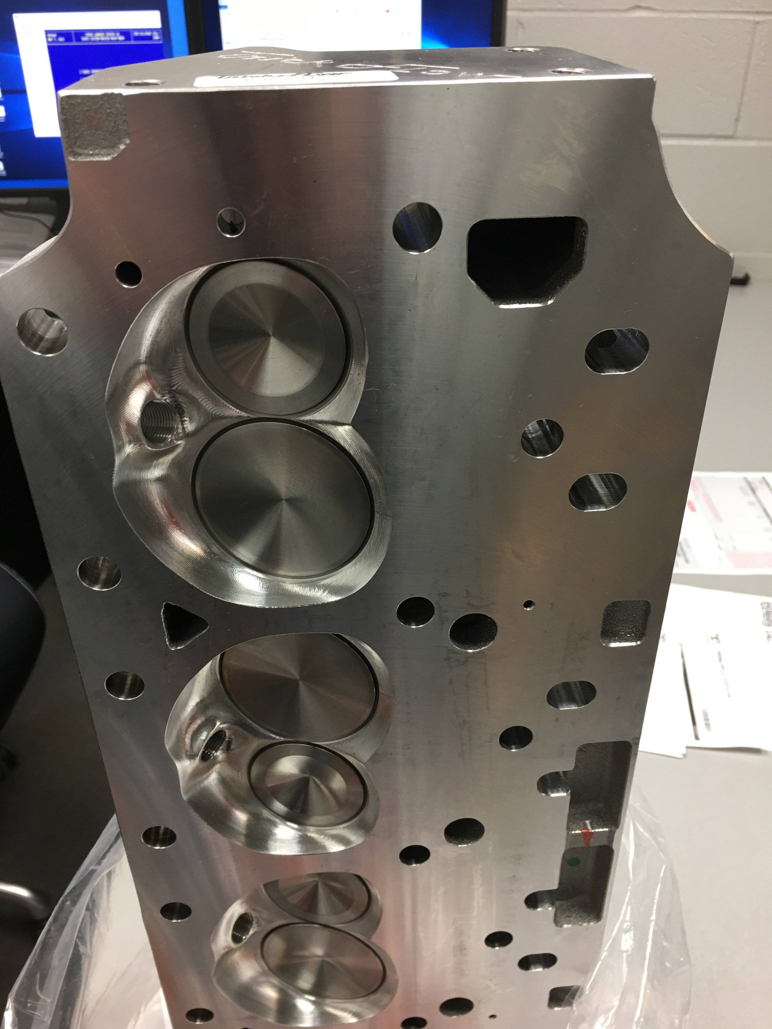

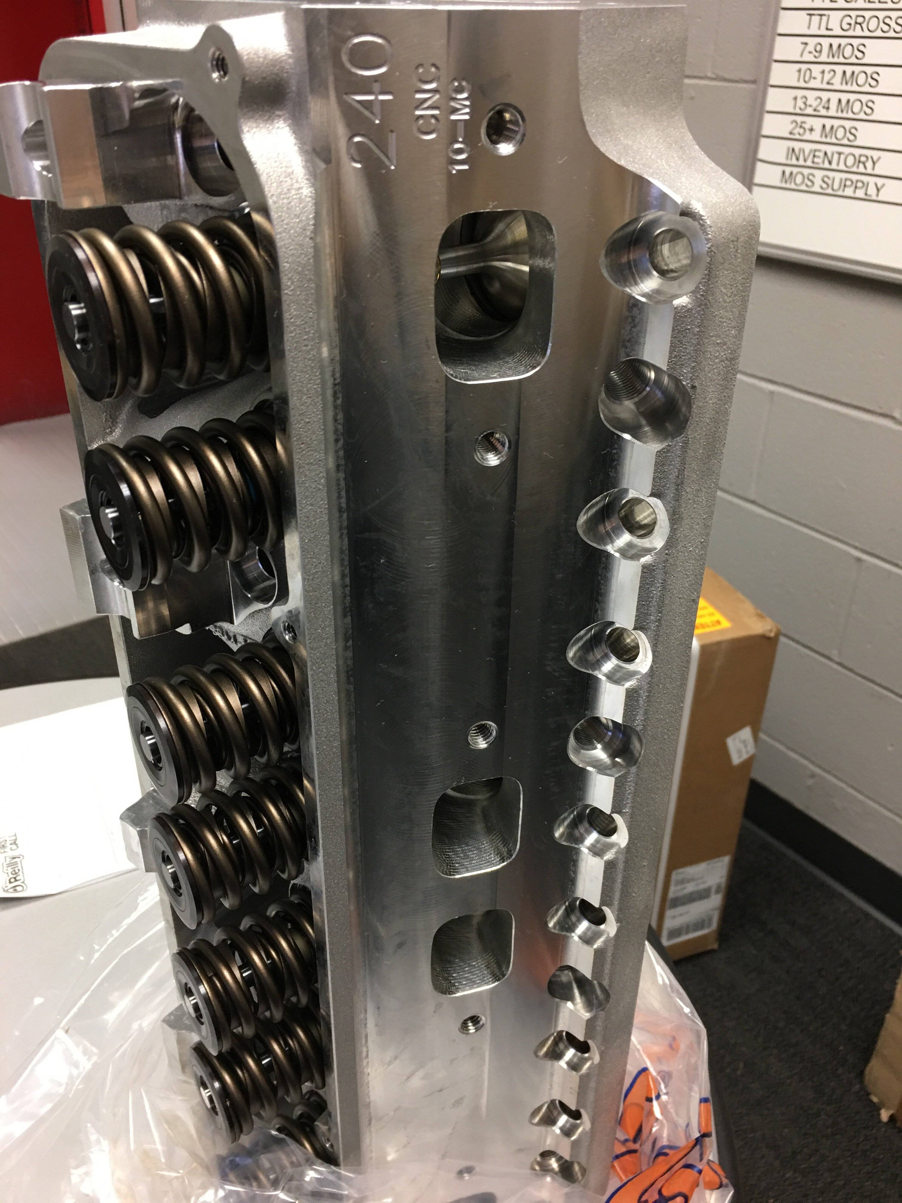

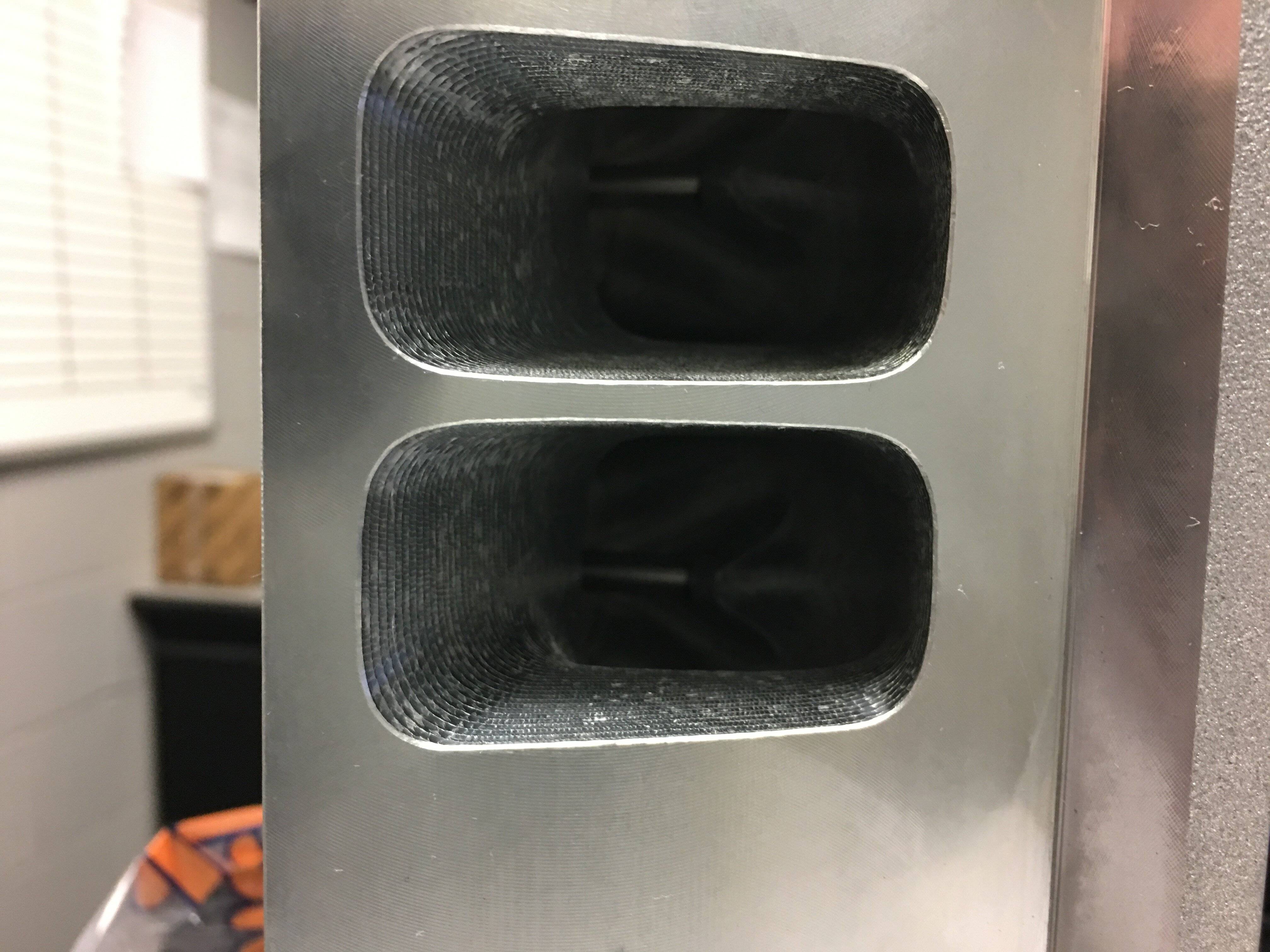

I’m just collecting my parts now. No hurry but, I feel the urge to build more than 500ci stroker. Got these last week.
