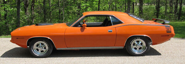

I have a 70 Cuda with a 383. It has a shaker and a 600 Eldebrock carb. I'm using the factory style steel fuel line that clears everything without touching, but does get almost too hot to touch. The engine temp is 185-190 and heats up to 200-210+ when sitting shutoff like at a gas station and of course cools right down after getting it started.
Any ideas on what can be done ?
The line gets hot after shutting it off.
Car runs ok at all times. But after shutting it off after engine has gotten hot, especially on 85-90 degree days, I have to crank it for a lot longer than normal to start and at times it will start then die and restart the same was when you've ran out of gas and its still pumping new into the carb. The steel fuel line gets almost to hot to touch even though it touches nothing and is the same height as the top of the distributor which it goes across the top of which is why I'm sure that I'm getting vapor lock.
I also did take the flaps out of the shaker to allow more air movement since I never drive the car when its raining or during the winter.
14 initial 35 total +/- 1 without vacuum hooked up. Other than idle air speed being adjusted slightly, I strongly feel that its set ok. It works perfect at all times.
I am starting to wonder if I shouldn't try changing the fuel pump. I "might" have the small block version instead of the high performance one for big blocks.
