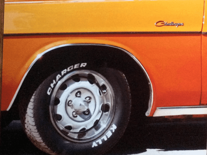

The wheels that I have on my '70 Challenger are the same ones that were installed on the assy. line. They are the 14" Rallye wheels, and are still on it. Now for the tires on the front Kelly Chargers RWL in P225x60x14 and in the back P245x60x14 Kelly Chargers also, the wheels are the 14x5.5", I did have the 14" trim rings polished out, like the 15" trim rings are. Thanks, Al
