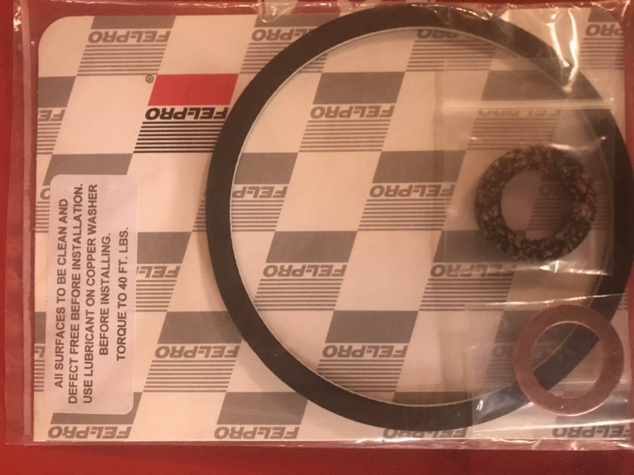

Inch lb. or Foot lb. ? I don't use a torque spec for stuff like this. Tighten it until it feels right. Depending on which bolt design you have, too tight may twist and damage it.I used this gasket set which called for 40lbs.
View attachment 98934![]()
