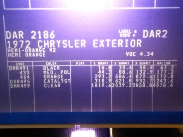

Body and paint is like an education.What you put in you get out of it.I myself don't like the water born paint.Just look at all the examples going down the road.The proof is in the pudding I mean paint. I use Omni and you get what you pay for. takes more coats to cover.Not that I'm an expert.I have worked in a body shop and mixed paint in the 70's.Knowing a number painters over the decades. They owed there own shop or worked at a dealer.There are different animal's in paint they all have there own different characteristics.Who ever paints you car let them choose that the are comfortable with.One of the biggest thing is that you use a sealer use all your products from the same paint system if possible.As some said.It still amazes me when an old enamel paint job is cut and buffed. almost looks like new. I now get my enamel paint from TCP Global. Can't find it in this area. It's not like the old enamel but not bad. It seem to separate kind of quick when mixing. One order I received was damaged. called them the shipped a replacement that day. Video,Paint mixed 4-5 minutes be sure to keep mixed.

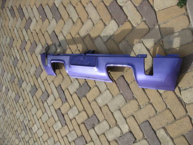

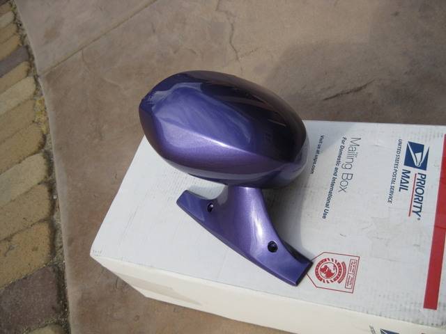

Matrix base coat and SPI clear; this is as sprayed, no cutting or buffing.
